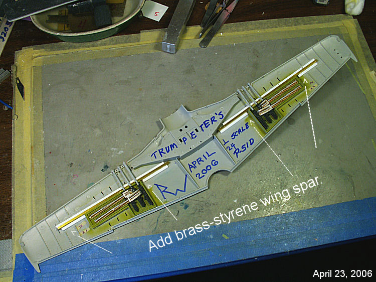

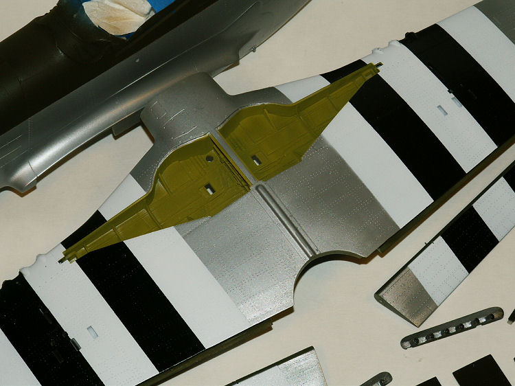

The kit wings are big and they were wrapped. Funny, but one wing bent up, while the other one was on a downward curve. I taped the two top wing sections to the bottom one piece wing section, and got a surprise after I dry fit the wing to the pre-taped fuselage. From a front view, the model looked like a bird that was flapping his/her wings. Does the above “OOB” rule let the modeler build in a wing spar like I did? (No Major Surgery).

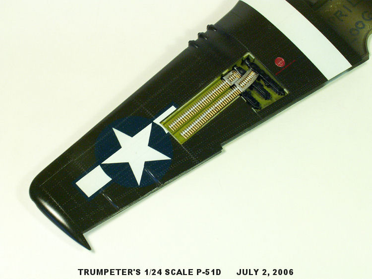

In my 29 years of

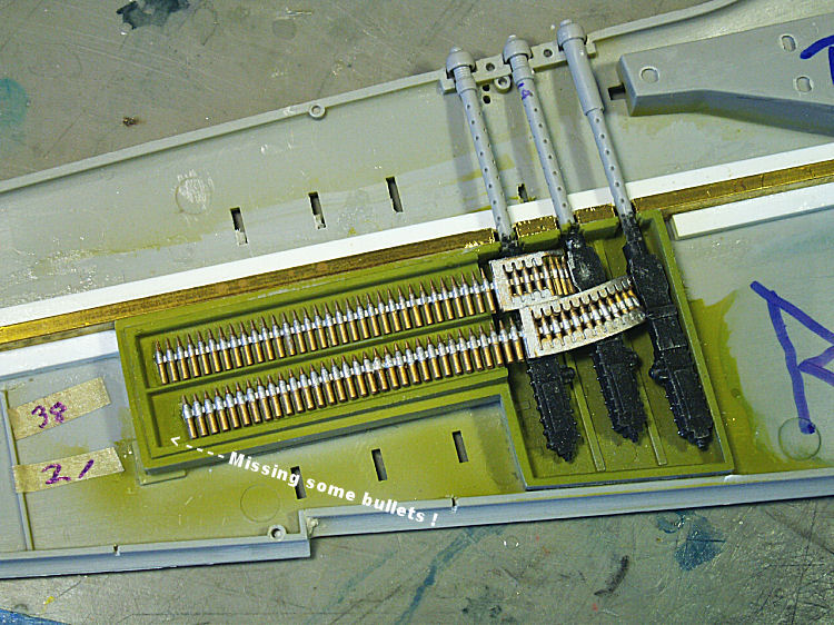

model building I have never built a model with the gun bays
opened.
(IT WAS TIME TO JUST DO IT)
Trumpeter did a fine job on making all the parts. Oh yes! There were some punch marks to fix, but they are on every model, so don't complain about them.......just fix 'em. Trumpeter was short a few bullets.
Well I like the end results, and that's what counts.On final assembly I will adhere one door on each wing in its' open position, while the other 2 door's just lay on the wings any place.
After the painting was finished for the guns bays,I glued in the nicely molded one piece wheel well, which is not 100% accurate, but it's better than none. The P-51 wheel wells are full of everything you can think of.

The 2 top wing sections were glued to the one piece bottom wing section. The built-in brass/styrene "spar" took out about 95% of the warped wing. We now have a finished slightly bent wing bird from a front view. However, just look at the model from the top and you will never see the warp.

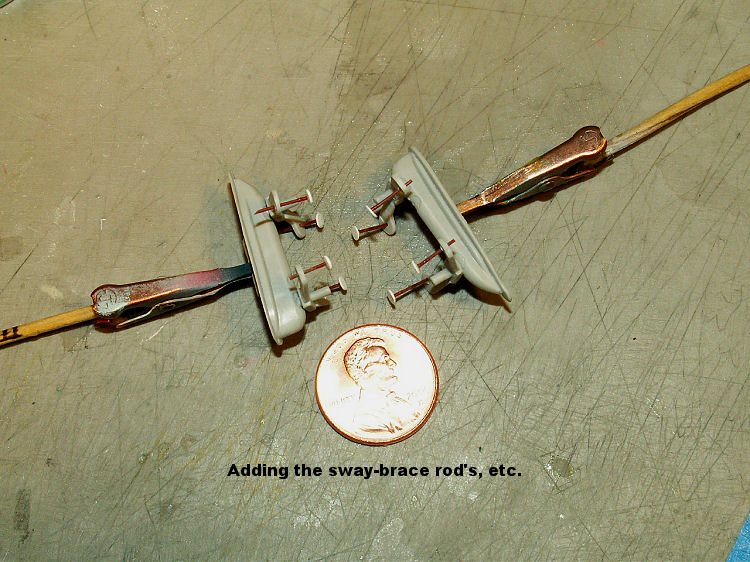

I had planned to use the 108 gal paper drop tanks, so I needed to revise the kit's pylon braces. To refresh my memory, I went and looked at my pylons that I made for "D.D."

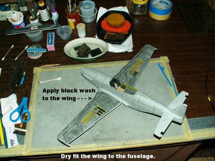

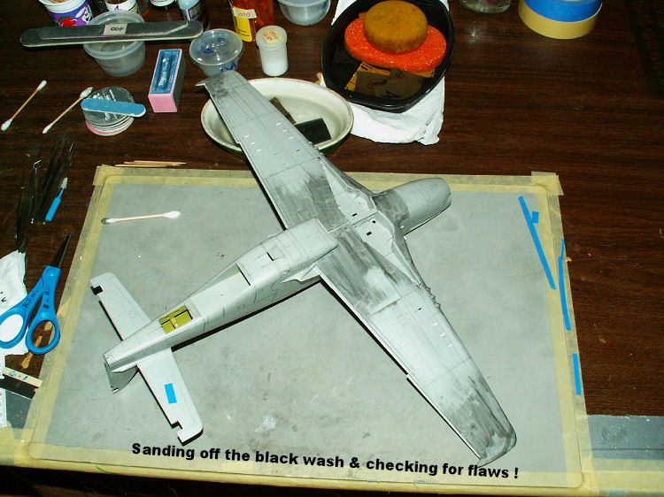

The finished wing was coated with my old stand-by, "Tamiya's Black Paint Wash". The wing was fitted to the fuselage again, just to make sure everything was A-OK! I started to sand off the wash and when I was finished doing that it was time to check for any missing panel lines that has to be re-scribed in, including the replacement of any of:
"Trumpeter's Oversized Recessed Rivets".
An impossible task!
As all of you know, none of the rivets were recessed on the P-51, so why did Trumpeter recess them?

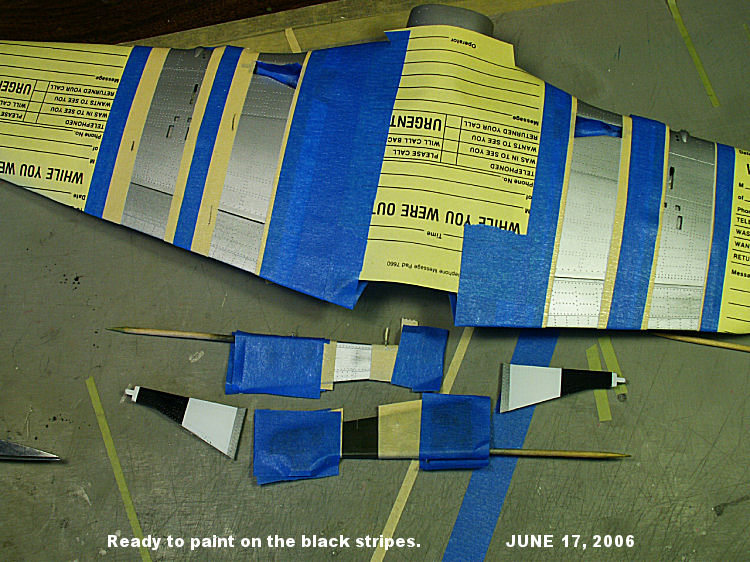

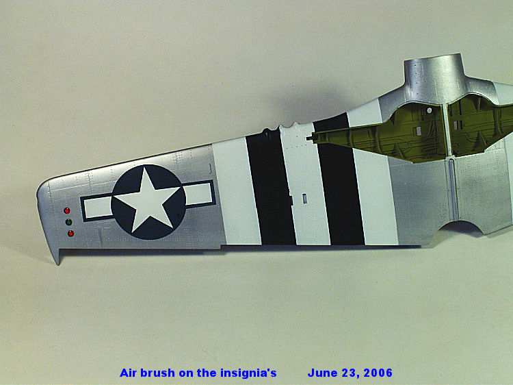

I applied Tamiya's O.D. paint to both top wing sections, and rubbed down the paint with more cotton balls. My rub down method gets rid of any over spray and leaves the paint with a low semi-shine to the finish. I mask off the wings, and then applied the white and black invasion stripes, which of course was rubbed down.
I made my own frisket film stencils for the wing insignias. The first mask let's me paint on my own insignia blue mix, which gets the rub down as well. After an hour of so, I carefully apply the second "pre-cut" stencil and air brush on the white.
