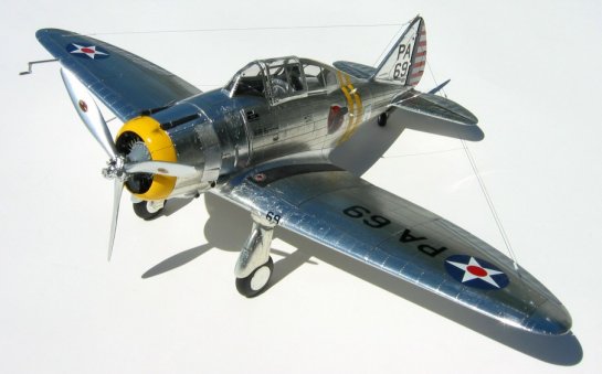

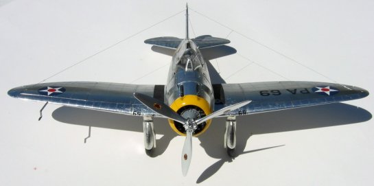

This kit was built to replicate the P-35 flown by the Commanding Officer of the 27th Pursuit Squadron, 1st Pursuit Group, Selfridge Field, MI circa 1938.

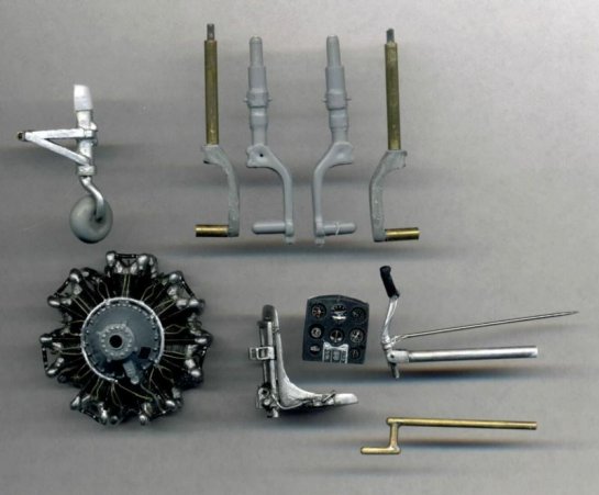

- The main landing gear looked okay, but seemed too flimsy to last. New legs were fashioned from steel music wire, brass tube, and JB Weld steel epoxy. These are very strong and durable.
- The tailwheel assembly had insufficient detail and a "plate mount". A new strut was fashioned from styrene stock and brass tube and mounted on a correctly positioned pivot point. The wheel and tire were cut away from the assembly and used as a more believable tire on a music wire/JB Weld axle.

ENGINE

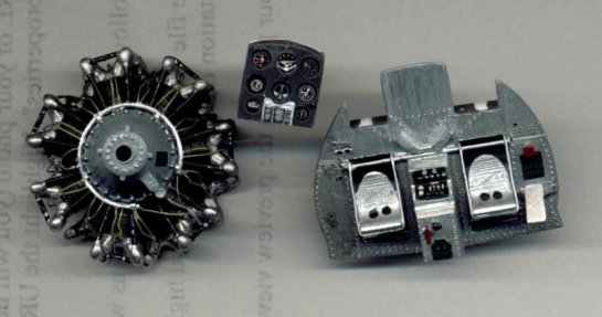

The engine detail in this kit is very good. Crankcase is composed of three pieces with individual cylinders directly attached. Cylinders have nice cooling fin detail although comparison of cylinders side-by-side shows lots of variation in the shape and size of the heads and lifter/rocker arm covers. While each cylinder has an attach point for an intake and exhaust I elected to omit these details due to crowding and inability to see the finished detail easily. The front row cylinders have free standing lifter tubes running from the case to the rocker arm covers, a nice change from the cheap looking ones molded into the side of the cooling fins. For added detail I installed the oil cross feed tubes and drain lines (copper wire) between cylinders and on gearbox drain. The plug wires were tricky since a thin styrene plug wire conduit was molded into the reduction gear case. By drilling small pairs of holes at the correct locations, I was able to feed through short half-loops of 32-ga wire from inside the case and tack glue from behind the conduit ring with CA. This left the neat pairs of wires to be run up to the respective plugs on front and rear cylinder banks. Case was painted gloss machine gray, cylinders aluminum and lightly washed with magnesium. Other details on the engine were painted silver or gloss black per photos and plug wires brushed with a brassy-tan color to emulate the braided insulator covers. The engine was drilled through to accept a brass tube which acts as a bushing for the thick music wire prop shaft / light switch, but the brass was not glued until final assembly when prop shaft fit and alignment were set up.

Cockpit work began with much planning. The only salvageable parts were the forward firewall and the seat, both of which needed extensive work. Using photo documentation...
...the side walls were marked, scribed, riveted, and a "hole-punched" beam added
The canopy rails on the external fuselage were non-existent so some surgery was required to hack out a groove and install a styrene I-beam to run from the windscreen to the aft turtledeck. A rear cockpit bulkhead was fashioned and riveted.
Using precision punches and instrument decals, custom main instrument and engine panels were made. The seat was reworked to include all steel mounting tubes, seat locks, and belts/buckles inertial reel. Side wall details were manufactured (in some cased a few times before being acceptable!) and set aside for installation. These included: throttle quad, oil/cowl control lever box, electrical panel, trim wheel box, gear/flap transmission, .50 cal shell ejector chutes, rudder pedals, floor boards, wiring and tubing. The cockpit in general was painted in aluminum metalizer, sealed with FUTURE, and washed with burnt umber for a slightly dirty look. The top of the center wing section was prepped at the same time with panel lines and rivets, as it is the floor of the cockpit. The control stick pushrod and torque tube was fashioned from styrene tube and a sewing pin, with the stick itself of music wire with JB Weld handgrip. The side wall details were not installed until after the fuselage halves were prepped with panel lines and rivets and the cavity vents scraped and reworked (see "surface preparation" below). That process requires lots of handling and any fine construction will be damaged.
LANDING GEAR

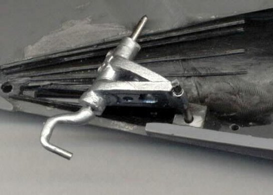

The plastic landing gear supplied in the kit are adequate for a basic beginners build, but looked too flimsy to last…. and who wants to EVER have a main gear bust!? Consequently, new legs were built up by using thin steel music wire to bend and shape to hold a brass tube the same O.D. as the I.D. of the main wheel holes (use the HARD PLASITC wheels, not the rubber tires). The music wire was shaped and brass tube filled with JB Weld slipped over so that main strut and axle were in same alignment as molded gear. When cured, more brass was added to the strut, and more JB Weld swirled onto the thin music wire. When cured the JBW was filed and sanded to nearly the shape of the original mains. A second round of JBW was needed to get exact shape. These gear are VERY strong!
The tail wheel assembly is a single "blob" which glues into a plate in the aft fuselage…..no thanks. The wheel was salvaged from the unit, cleaned up, drilled and a thin brass tube axle bushing epoxied in. A new tail strut was made from, again, thin music wire and JBW which allowed the entire wheel to be free of the strut….nice. A styrene tail strut was made and the inner aft fuselage prepped to show interior structure with thin strips and rivet details.
Assemblies were painted aluminum with a touch of burnt metal, sealed with Future, and lightly washed with black/umber mix. A small block was glued into each fuselage half to capture the strut pivot tube when joined, and the tail strut music wire is not glued in at all. It is held in by friction fit and a light coat of spray post-it adhesive so it remains able to rotate 360-degrees, yet won't fall out, and can be removed if desired for transport. While all the metal work was in progress I made a pitot tube of brass, since the itty-bitty plastic kit pitot tube would not last long at all. A tight fitting brass tube was mounted in the right outer wing panel to hold the pitot tube, yet leave it removable for transport. The brass one looks better too.

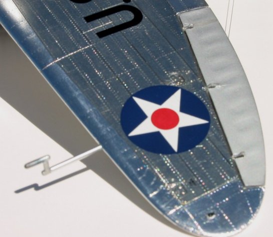

Drilling out nav light lens holes, and allowing for wire runs into center section prepped outer wing panels. The lower aileron has external Friese hinges and the molded "lumps" are a poor replication. Each hinge was drilled out and a small slot left. Pairs of matching left and right hinges (the three on each aileron are different) were filed from thing brass stock and JB Weld epoxied into place. (see picture above) The excess brass/epoxy protruding into the inner wing was ground off with a Dremel cutting wheel, and a small dot of JBW applied to the hinge points to simulate pivot bolts and nut.
