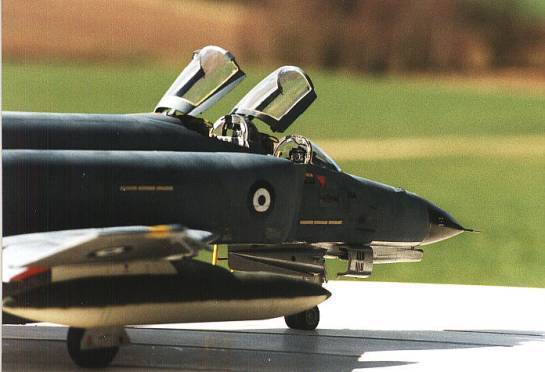

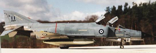

I'll start from the middle! Greek Phantoms was flown back in the 70es in the SEA style scheme and had big light blue and white roundels in six positions. In the mid 80es the paint scheme that was already used by the Mirage F1 and the F-5A was also used by the F-4s. It was the Aegean Blue (FS 35164) in all upper surfaces and silver (FS 17178) on the under surfaces. The Aegean blue scheme was used until the recent days and it is been replaced now with the new ghost scheme seen on the F-16s and F-5s.
There was a big misunderstanding about the right tone of the Aegean blue. Is it darker or lighter? Well, Greek F-4s are used many times a day and together with the Greek climatic conditions makes the amount of weathering very high. The right tone of the Aegean blue must be a much lighter one... but the right answer is very simple: If it looks right it is right!

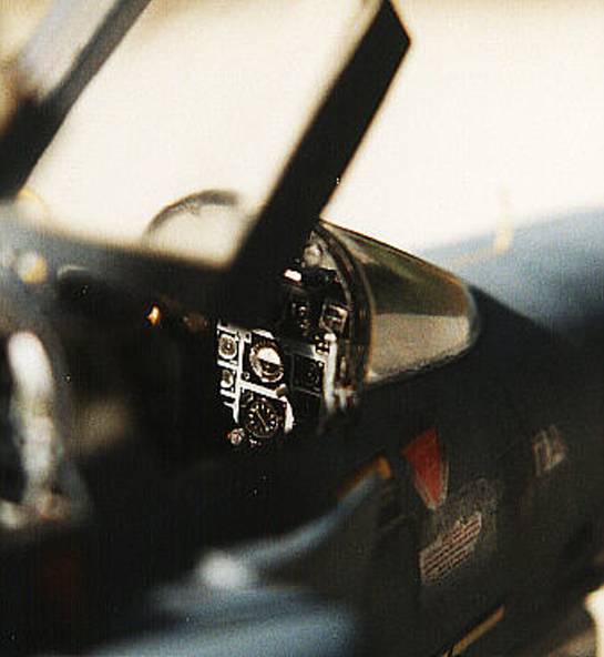

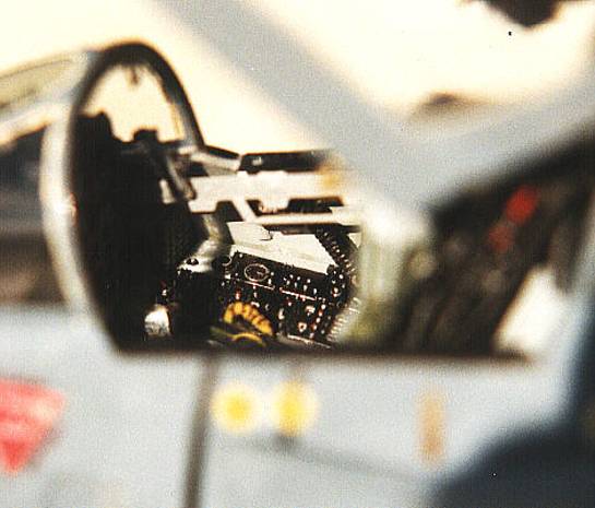

As I wrote above, the instrument panels are 3D, but not so good as in the F-4E kit(especially the front panel). I used the Eduard photoetched kits to make things better. The WSO panel was took from the kit but I added some cables in the back and the shade of the radar screen.
The back cockpit is too deep, so I had to cut it and glue it 0.5cm higher. If you don't change it, you'll have to put the seat much higher. Otherwise the situation in the cockpit is OK.

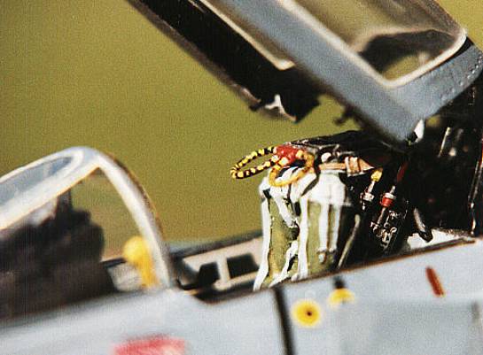

The seats that I found in the F-4F kit are very good, but I changed them with resin ones from Paragon. I used only the face curtains handles from the kit.

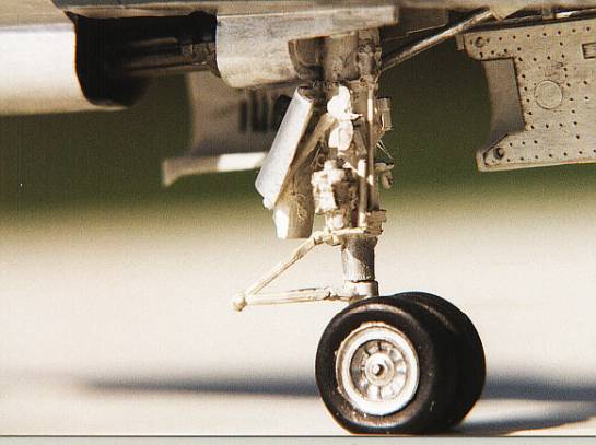

One more problem came through. The front landing gear is out of scale! (too thin). I had to make the whole thing from scratch (I used photos from the real thing and the same part from the Tamiya kit as a template). The main undercarriage is otherwise well done from Revell.

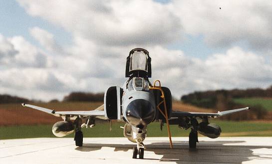

I used the original centerline tank (you have also the option for the F-15 style tank!) and the wing tanks from the Tamiya kit.

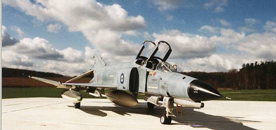

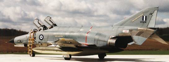

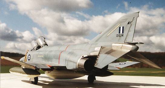

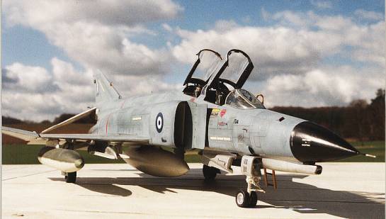

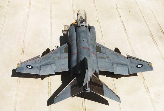

As I wrote above the Hellenic Phantoms were flown between mid '80s and '90s with the Aegean Blue scheme. This blue variation is some kind of tricky because everyone wants this color in more than one tone. Well the truth is that the FS 35164 is much lighter on the F-4 and together with the Greek sun, wind, and salt water you have to change this basic color to a gray-blue one!<
One particular point of interest is that once the aircraft goes through repair and other service procedures, ground personal sprayed the panel lines with fresh (and darker) color. You have the effect that after some service time almost every panel line is darker than the rest. I used enamels for painting and I didn't used a spray gun to paint the model. Everything was done by brush.
Some of the decals was made from the beginning by drawing and printing them on clear decal sheet. The Greek roundels are made in Greece from a company named Plastimodelismo.
