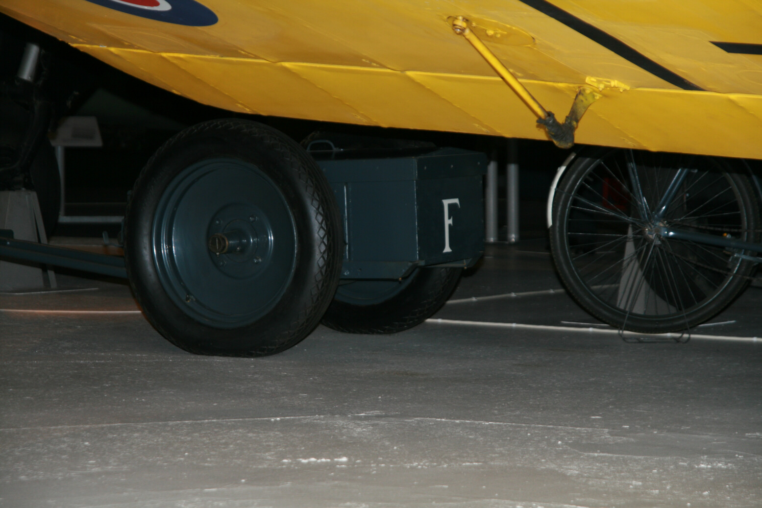

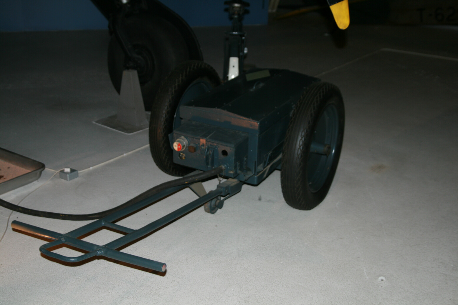

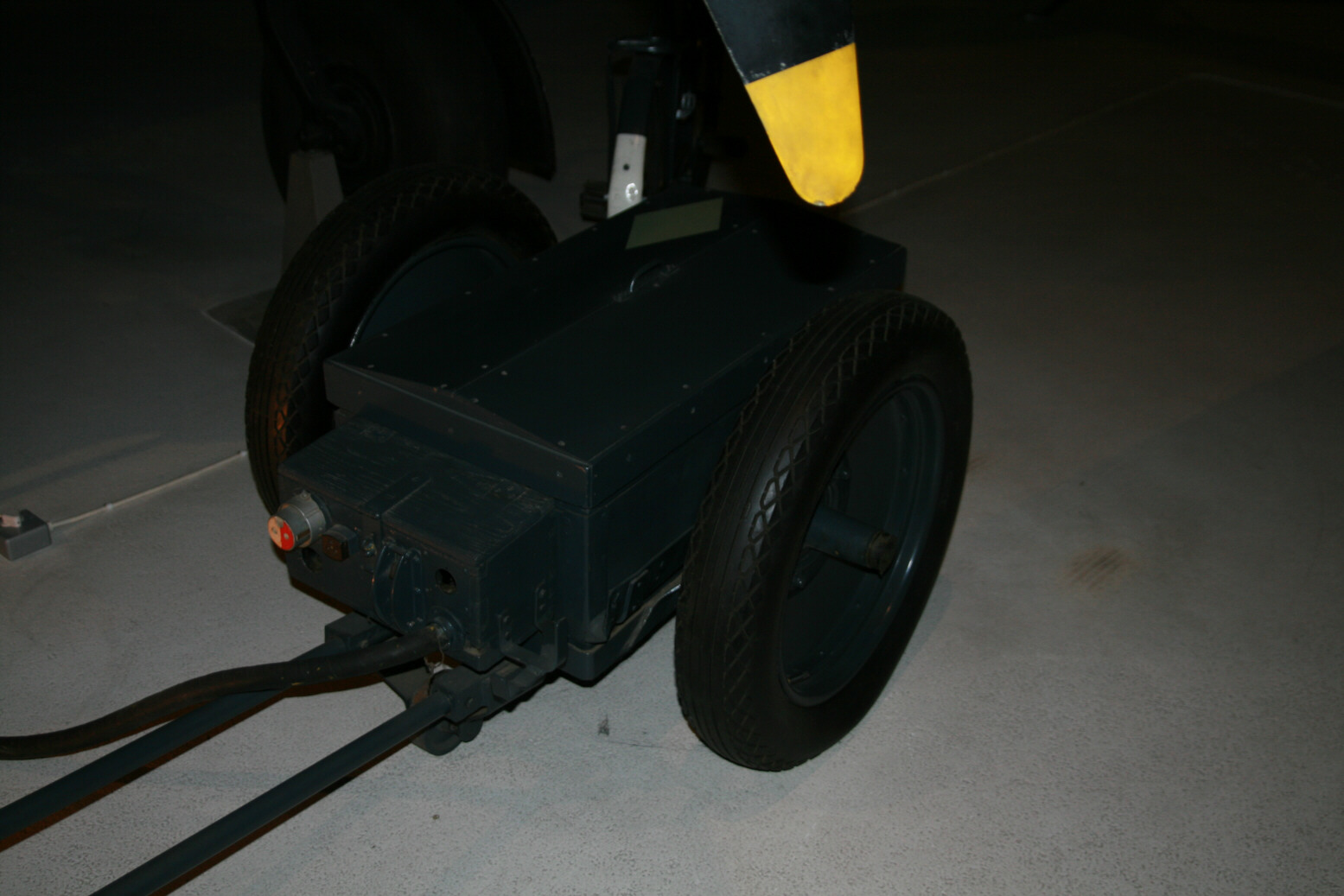

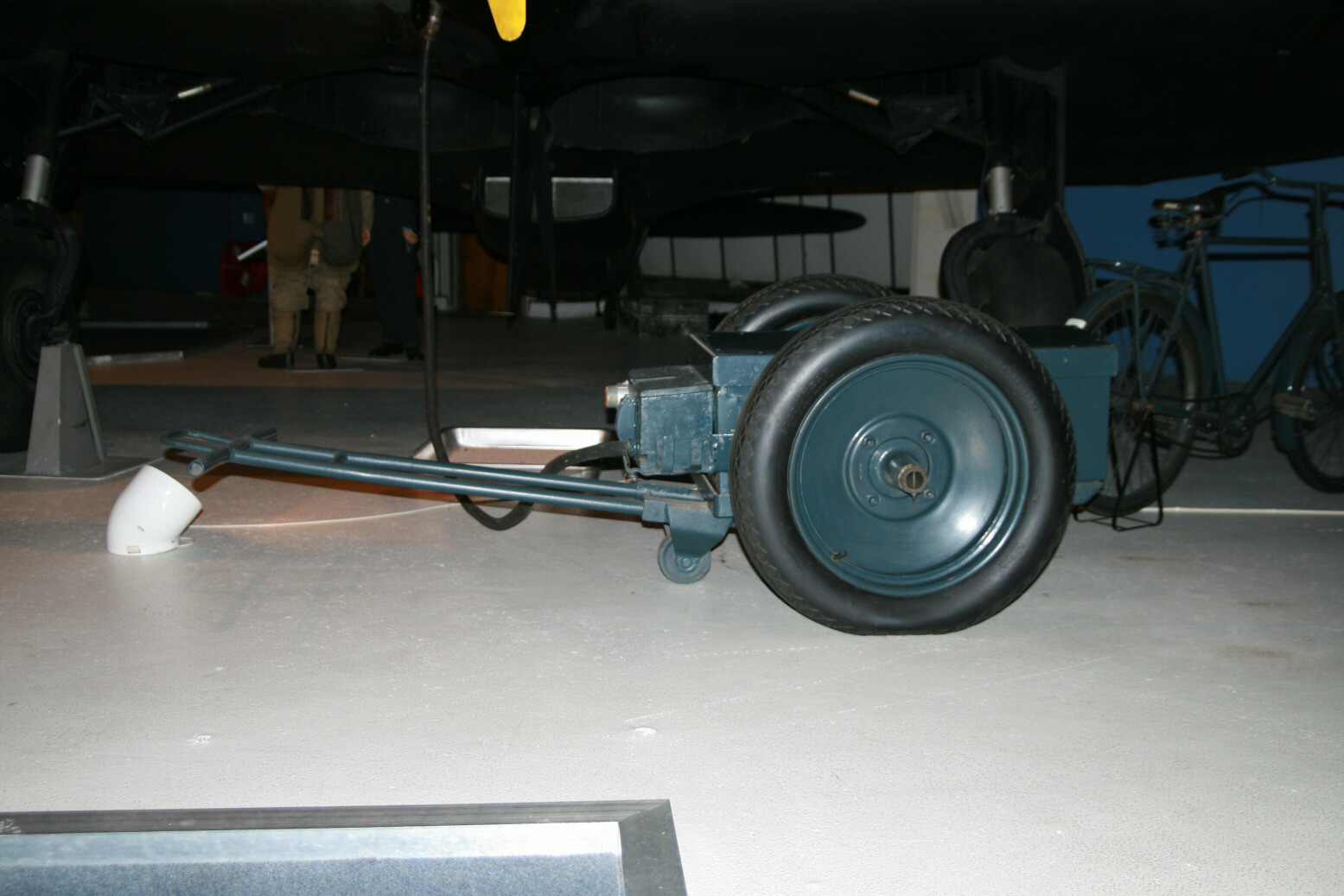

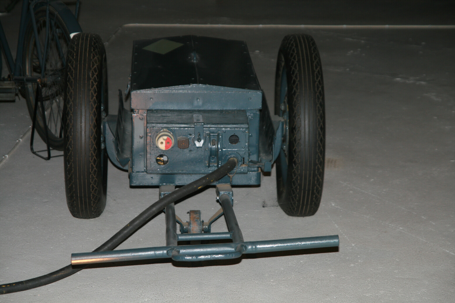

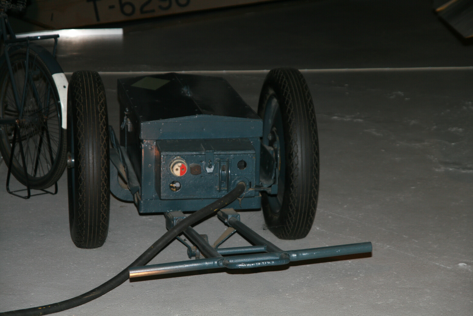

The first type, solid-wheel trolley is shown photos 1 through 6. The aircraft that it is plugged into in the photos is a Boulton-Paul Defiant (visible in photo5). Note that in photos 1 through 3 there is a bicycle in the background. The yellow part in photos 3 and 4 is a propeller tip from the Defiant, while the yellow top in photo 5 is the wing of an aircraft (not the Defiant which is black).

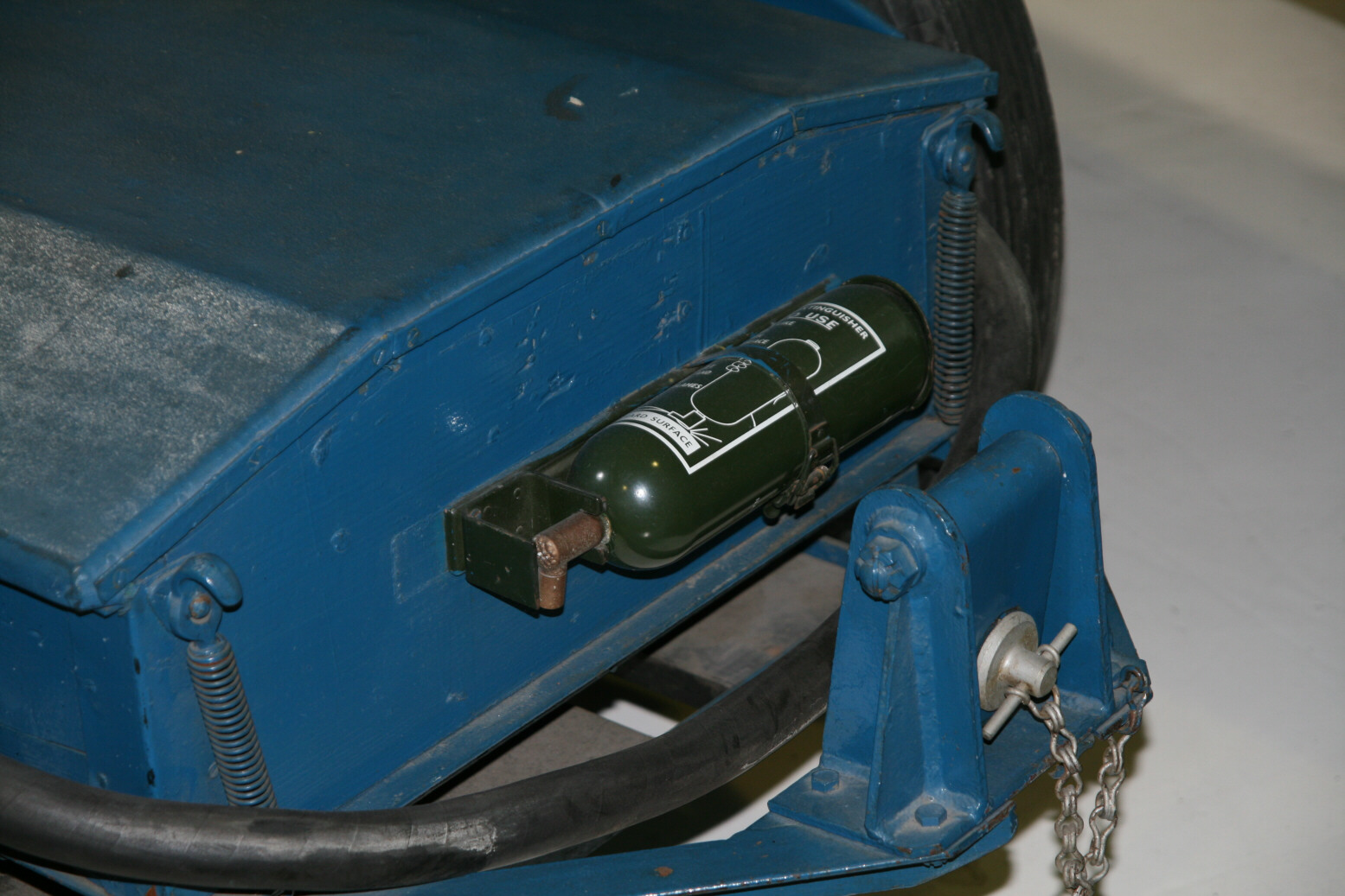

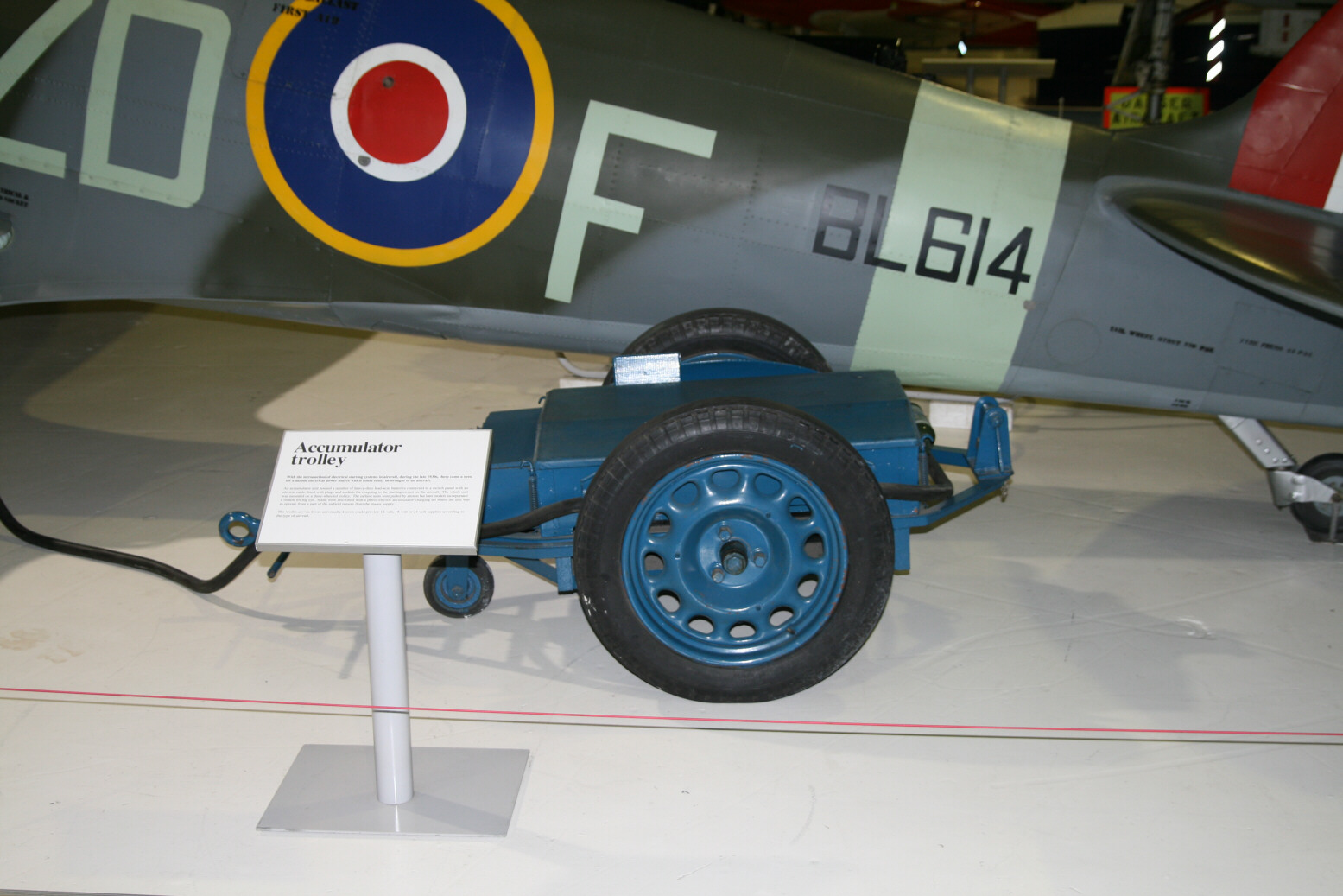

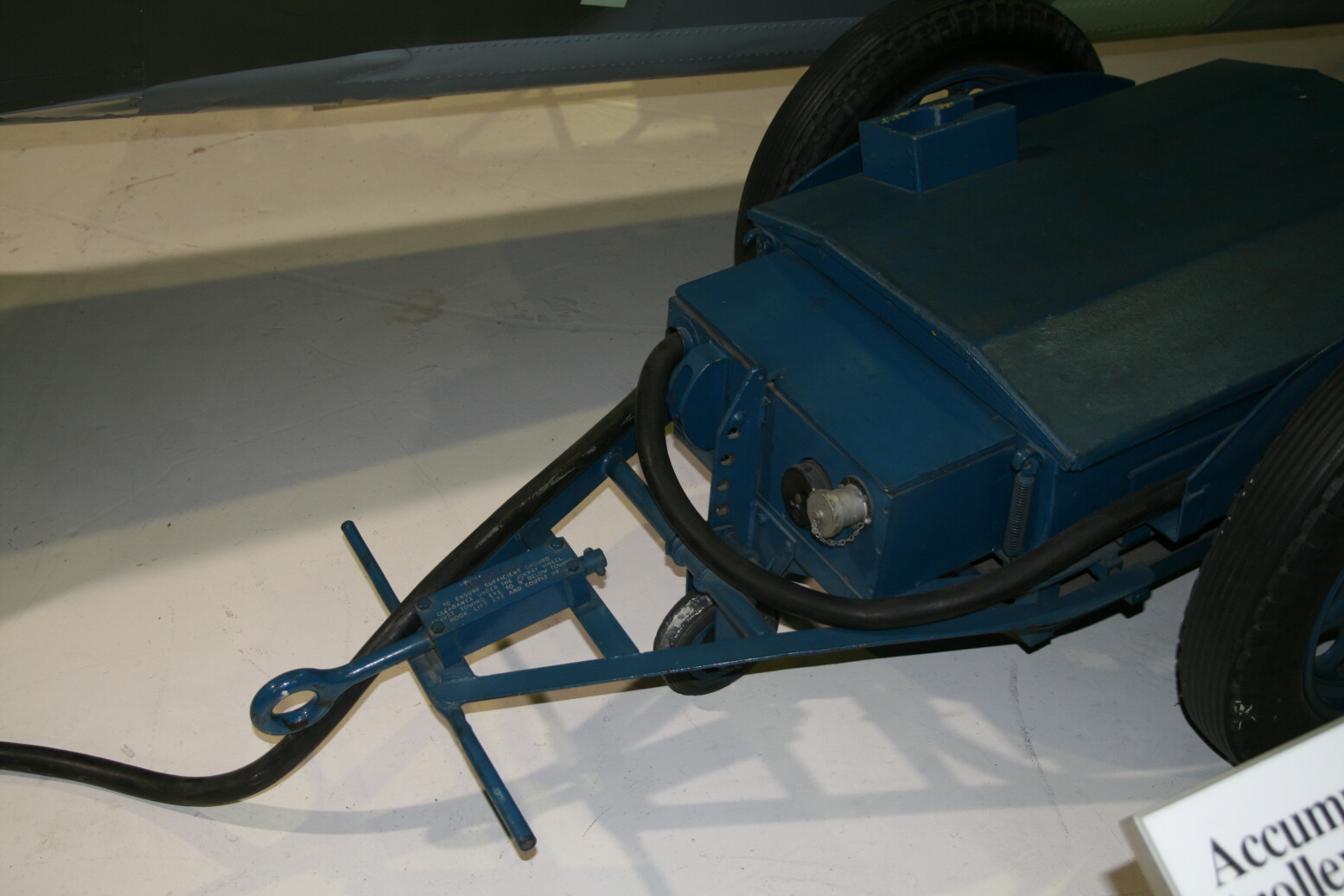

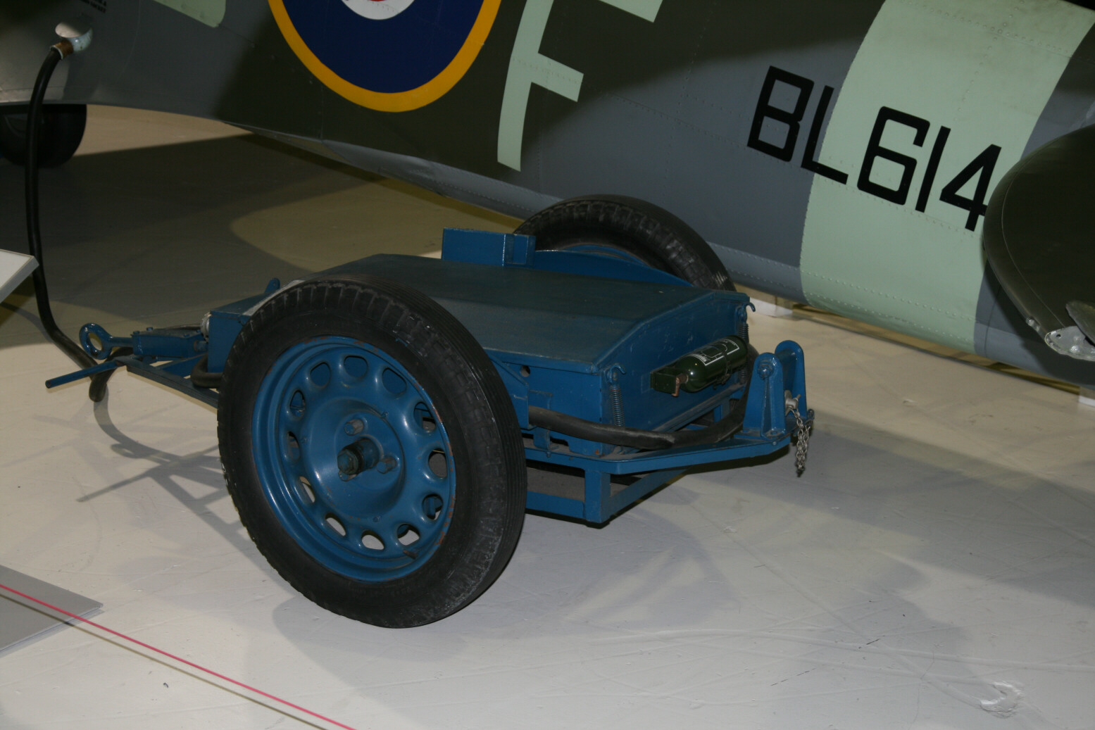

The third type of trolley (photos 7 through 10) in the museum is plugged in to the electrical socket of a Spitfire Vb. The trolley has a brighter blue color than the solid-wheel one. Photo 9 shows the front end while photo 10 shows the back end which has a fire extinguisher.
