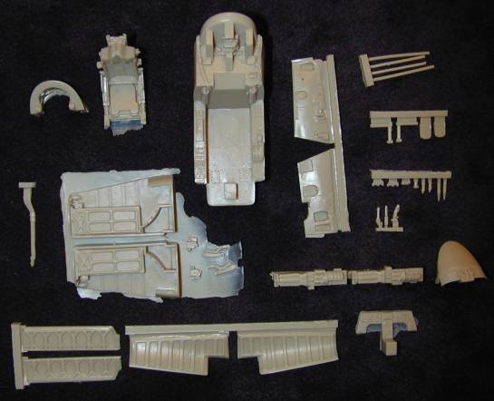

The update set is shipped in the familiar Verlinden box. The parts are cast in a hard green resin, and are wrapped in a plastic bag. Photo etch, wrapped in bubble wrap and instructions complete the kit. Some of the resin parts are surrounded by lots of flash; however, it is very thin and should be easily cleaned up.
![](/reviews/images/963/Components.jpg)

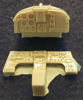

The instrument panel is supplied in two pieces. The upper portion is moulded into the glareshield, necessitating the removal of a portion of the cockpit area on the model. The instrument panel is expertly cast with very fine raised surface detail. It is cast with a radarscope. Check your references carefully, as not all F-5E are so equipped.
