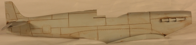

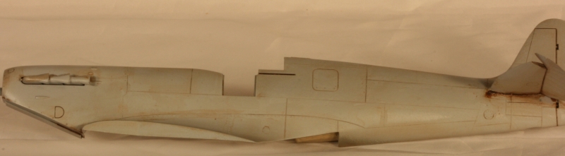

I hope you get some value from the pictures. I´ve scribed the model using a different tool for each side. I sanded off all the surface detail and there is a few layers of Mr Surfacer 500. I applied a Clear gloss fnish and then ran some burnt umber oil paint wash into the panel lines. Be kind as this is only my third ever serious attempt to scribe a model. I´m sure you can see where I´ve made gaffs, part of which is the learning curve in using these tools and my reasonably dodgy scribing guides. Naturally, the flatter the surface the easier any scriber is to use. I also got better as I went along. I found with the more subtle lines the Scribe-R produces, a couple of coats of Mr Surfacer 500 can almost obliterate the detail if you´ve been lighthanded. In the pictures you will see some parts of the panel line haven´t taken up much wash for the Scribe-R parts whereas even with a light hand using the Tamiya Scriber prodced deep enough lines to readily accept and keep the wash. The bottom line is, if you want subtle...the Scribe-R is your tool for sure. I also found joining two intersecting lines easier with the Scribe-R as its point was out in front, clearly visible to your eye. This is in contrast to the Tamiya scriber where the blade tip is covered from sight.

Port Fuselage Scribe-R Close up
Port Wing Scribe-R
Starboard Fuselage Tamiya
Starboard Fuselage Tamiya Close up
