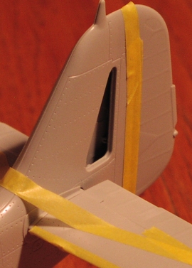

A fully detailed Jumo 213 is included and very well modeled. Some of the rear end will show through the open style gear bays that the Dora was famous for (and that Trumpeter has reproduced well here), but there is no option to expose any of this beautiful engine through open panels or clear parts on the cowling itself. Conversely the triangular tail gear access panel on the fin is molded as open, yet no detail is present on the inside. The MW50 water tank is also included, and again with no way of seeing it as it was mounted deep within the fuselage and the access panels are all molded closed. To expose the included detail some major surgery would be required.

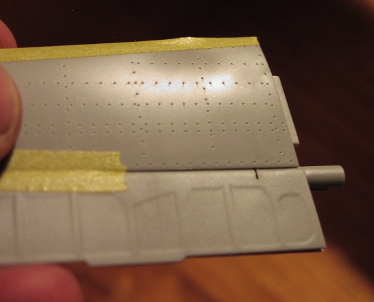

Engraved panel and rivet detail is the most subtle yet from Trumpeter and looks very "scale." There is a slight discrepancy in depth of this detail between the port and starboard wings on my review sample but beyond that, the molding detail is crisp and well done.

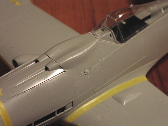

The kit offers a choice of gun hoods and canopies for the various versions of the D-9. As well the radiator flaps can be modeled open or closed and offer the only other view (if limited) of the Jumo engine. Check your resources to insure you are using the correct parts here. The gun hood has always been a point of heated argument, here is one of the hoods test fitted for review.

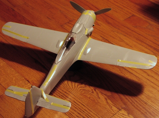

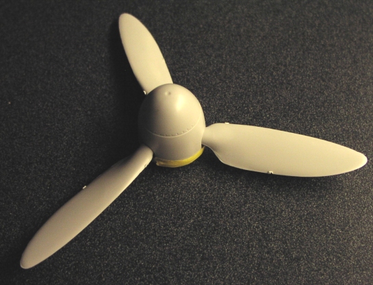

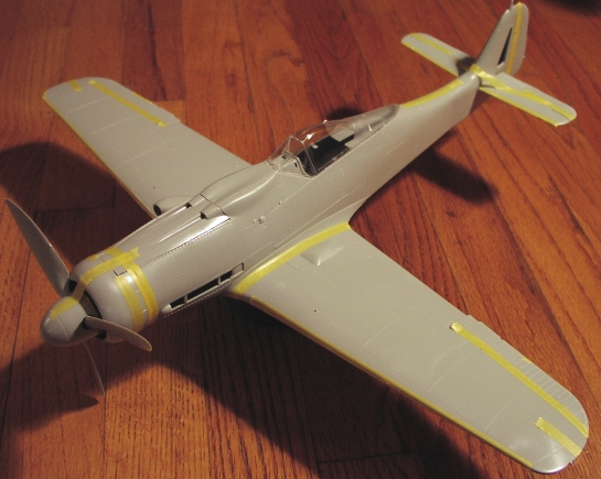

Basic shape is very good, and as you can see it looks like a D-9 just with the basics taped together. The prop is shaped well and looks to be fairly accurate as well.

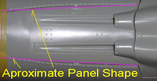

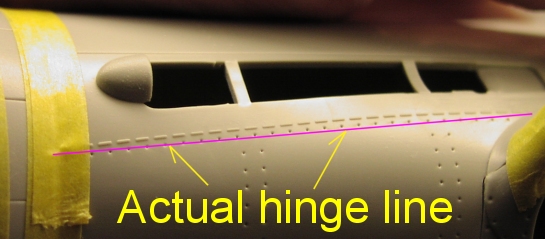

There are two sets of long "piano" style hinges that allow the cowling on the D-9 to be opened in a "clamshell" fashion using four panels. The very nature of this style of hinge mandates a straight edge. These are modeled as curved panels (which would be physically impossible to open) along with raised hinge detail. From the side they look straight, but as they conform to the reducing geometry of the cowling they gently curve inwards. Fixing this may be difficult as the cause of the problem is not the panel lines, but the geometry of the cowling. In this reviewer's eye, this is the kit's only glaring fault. The more I look at this the more it bothers me while many of the other smaller flaws fade away for me.
Top clamshell hinge
Chin clamshell hinge

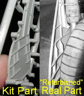

Some minor shape errors on the main gear doors themselves are present, but more interestingly the internal ribbing is actually fairly accurate for a restored D-13 that was at the Champlain Fighter Museum in AZ. However the real D-9s gear doors were unlike this detail and had a flat backing with large manufacturing dimples.

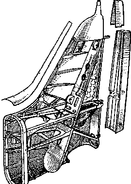

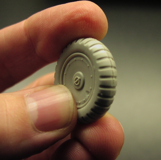

While the main wheels are thankfully not molded in rubber, the tread pattern looks a little deep. They are molded with a 2 piece tire and a separate 2 piece rim which will make painting a breeze. The tail wheel is void of any hub detail at all, and does not resemble the real item. The tail wheel bay lacks the distinctive "flared" rim found on all Fw 190 variants.

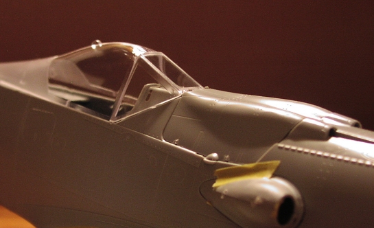

The canopy looks to be quite accurate. The kit contains both the standard canopy and the "blown" hood fitted to later D models. Here the "blown" hood is shown test fitted.
