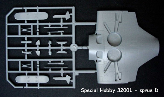

The Special Hobby I-16 has all the sprues of Azur’s Polikarpov I-16 Type 10; sprues A, B, C, the clear sprue, the special resin pieces, and the photoetched metal are all the same – that is, identical. However, Special Hobby have deleted the Spanish Civil War decals and have included their own decals to cover 3 aircraft of the Russian “Great Patriotic War”. An all-new sprue D provides the appropriate Type 17 cowl revisions, an option of landing on skis, wing cannon, and special covers related to the landing skis.

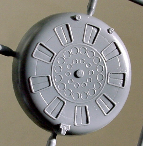

The kit supplied nose cowl is the one from the Azur Type 10 with the ‘T’ shaped lower intake; on many Type 17s this was rectangular.
![](/reviews/images/811/04.jpg)

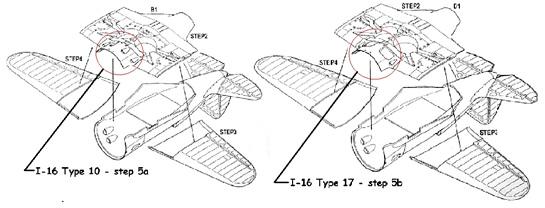

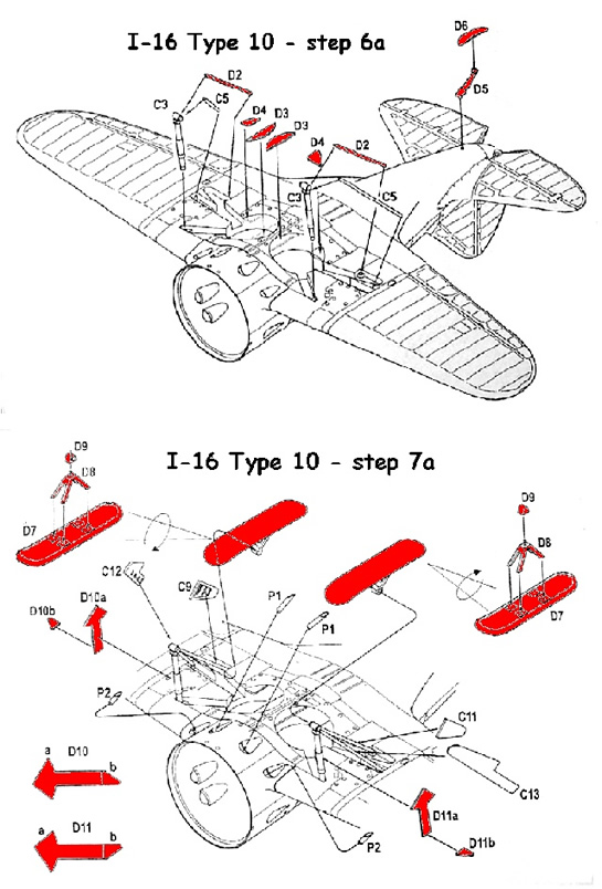

That is the kind of information I like to find – it alloys me to proceed with the fun part of modeling with some degree of confidence! Armed with that information, one can study the kit instructions and determine viable alternatives. Steps 5a & 5b call for a decision to use the Type 10 or Type 17 underwing/cowl.
![](/reviews/images/811/05.jpg)
If you go the Type 10 route, step 6a and 7a have you apply various pieces for the “non-retracting skis” of a Type 10. This is a caution point: the Type 17 cowl has exhaust ports moved and depressions cut into the cowl for the retracted skis, but no guidance is provided about what pieces to mount to make a ski equipped Type 17. Some of those pieces identified in step 6a and 7a for use on the Type 10 with skis are needed to make the Type 17 with skis, which leaves the modeler to assume that the same pieces can be substituted.
![](/reviews/images/811/06.jpg)
An I-16 with skis is really the only reason to select this kit over the Azur kit (or that it has the Russian markings, but save the difference and get the Contact Resiné set). It is a curiosity that no where on the sealed box is there mention of the ski gear within; are we to assume from the mention of “10/17” that this is the case? Certainly an inference that would escape me! Anyway, now we know. The decal markings provided for 3 veterans of the “Great Patriotic War”:

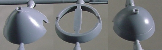

One last item: some information about the two spinners in both I-16 kits can be found at: http://vvs.hobbyvista.com/ModelArticles/NewFindings/VVS_new.php
Apparently the blunter spinner was found only on the Type 24’s that derived from only one factory.Seems to be a very limited application to include in the kit.
