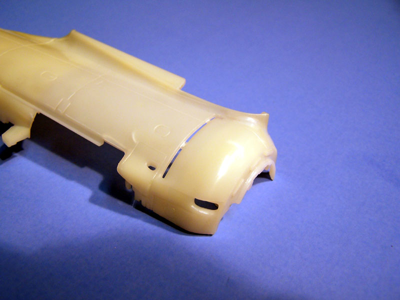

I missed a few details when initially reviewing this kit. It has been brought to my attention that incorrect parts have been supplied (A6M3 style cowl with no scoop and different gun troughs). The box top depicts a model built from the correct parts. Since this is an early 'Market Test' kit, it is possible that the correct cowl and scoop as shown on the box top and pre-built Zero shown below will be supplied in future releases. Also, the ailerons are not correct for the A6M2. The kit's ailerons depict the A6M3 and later type ailerons.

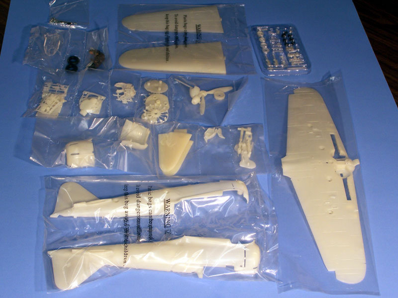

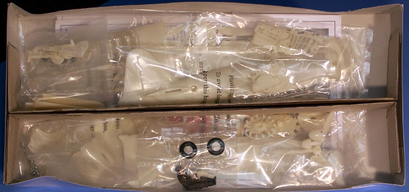

The parts bags are held steady in the box by a pair of cardboard strips that trap the bags and (supposedly) prevent things from bouncing around in the box. All 5 of these 21st Century kits that I bought had the parts shuffled to one end with the result being the box top refusing to close all the way. For a box that is not shrink-wrapped or sealed in any way, this presents a problem as the kits are exposed to the rigors of customer abuse while sitting on the shelf at Wal Mart.
All but 3 of the parts are injection moulded in a hard, milky-white plastic and packaged by assembly step in plastic bags. There are no sprues at all. Unfortunately, the 3 clear plastic parts are bagged together, but in this sample do not appear to have suffered from damage or scratches as a result. A pre-painted, articulated pilot "action figure" and rubber tires are also separately bagged. There is a small plastic vac-pack holding the hardware and other small parts.

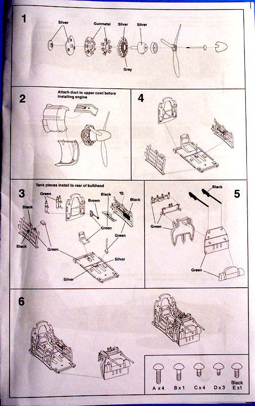

The instructions are clear and concise, but there are no part numbers to reference during assembly. Each part will have to be visually identified, but this doesn't appear to be a problem because there aren't very many parts that look even remotely alike.

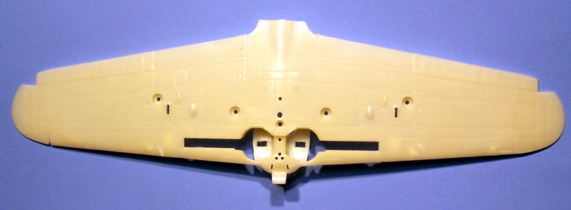

The main airframe parts were checked against my slim references for accuracy of shape and size. Everything seems to be well within 1/16" of being dead-on, with a few exceptions. If my references are correct, the kit's wing at the tip is 5/16" too wide in chord, and the root is 1/8" too wide in chord. Yeah, that wide wing is somewhat noticeable, and would be difficult to fix.

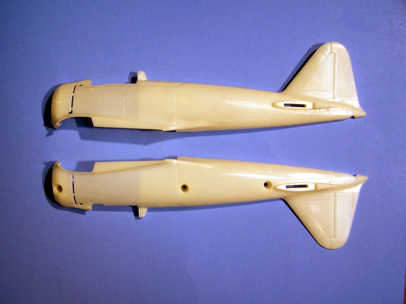

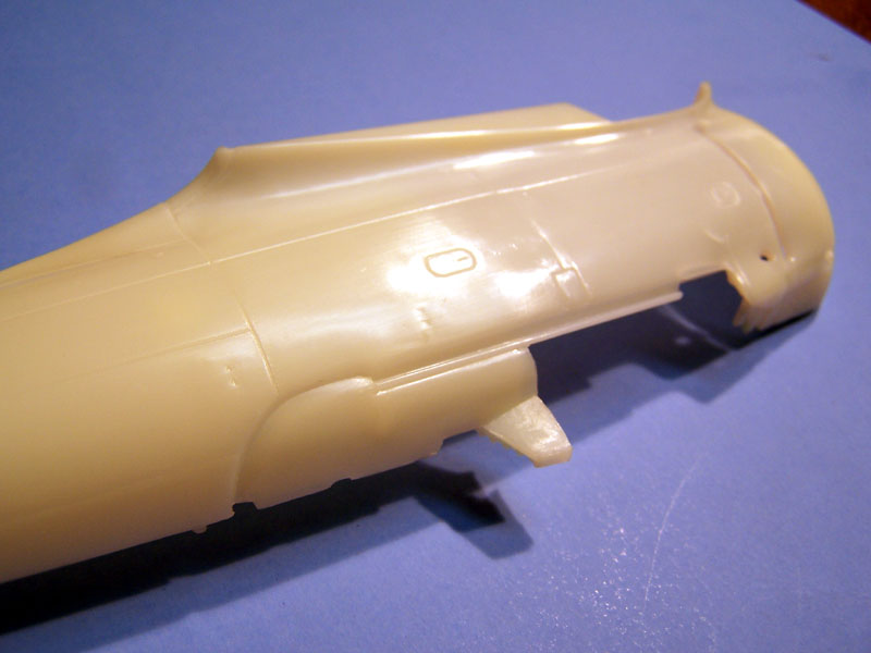

The fuselage itself looks great, except for the chord of the fin/rudder at the base which appears to be 3/32" too wide in chord. Height and width measurements are all within 1/32" on the rest of the fuselage, cowl, canopy and horizontal stabilizers.

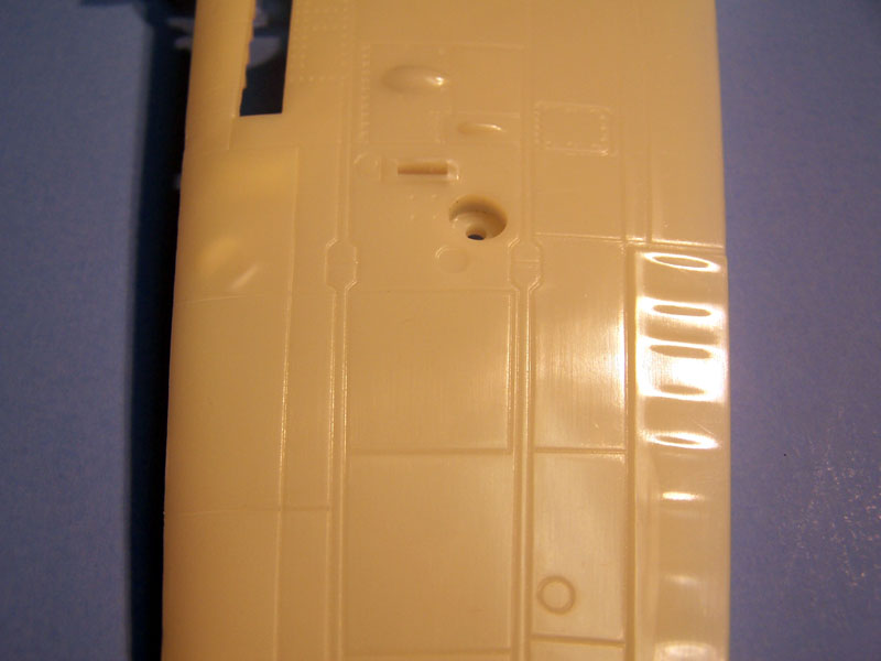

The surface detail is engraved, but a bit heavy-handed similar to the old Matchbox kits. On the upside, the panel lines and other surface details appear to be correctly located. The rudder, elevators and ailerons have fabric ribbed effect delicately moulded in, but no attempt was made to represent the fabric texture of these surfaces. As can be seen in the images, there are holes in the wing bottom and right fuselage half for screws. These are addressed by the inclusion of plastic caps for the holes, but some filling and sanding will almost certainly be required to erradicate the inherant blemishes completely. More shots of the surface details:

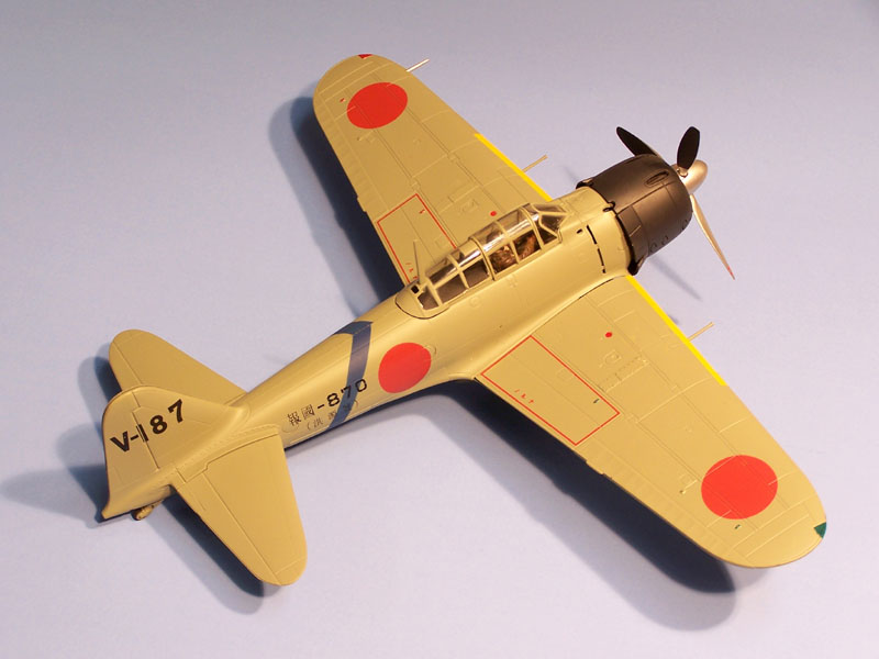

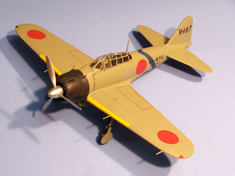

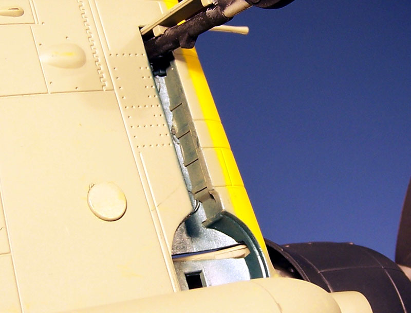

Since I have the pre-built/pre-finished version of this kit, it seems fair to include a couple shots of what the kit should look like if built "OOB":
Image 12 Image 13
There are overly thick trailing edges on all of the flying surfaces. Again, very much like the old Matchbox kits. Some filing or sanding of the mating surfaces will be needed if the modeler intends to bring these areas to an acceptable level. The wing dihedral angle is flatter than it should be. Some careful sanding and test-fitting where the wing tops meet the fuselage fillets should cure this problem.
The wheel wells are almost devoid of any detailing, but are fully boxed in. There are some prominant ejector pin marks in the wheel well area on my samples. I'm no expert on Zero wheel wells, so again, I'll leave this area to those that know more.

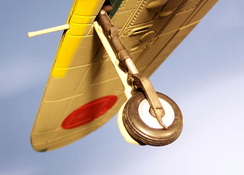

The landing gear legs are fairly well represented. However, they are provided in what appears to be the fully-extended, in-flight position, which is 3/16" too long if the model is to be displayed sitting on its wheels. This could be corrected with a little effort and would really enhance the stance and overall look of the completed model. The gear doors are moulded a bit thick, and one-piece. No attempt was made to represent the small door at the top of each landing gear leg, so you'll have to make your own if you want them on your model. The tires for the main wheels are rubber, and very crisply moulded with radial tread. All of the 'toy-like' features of the die-cast version such as retractable landing gear and sliding canopy are retained in this kit version for those that want to utilize them.
