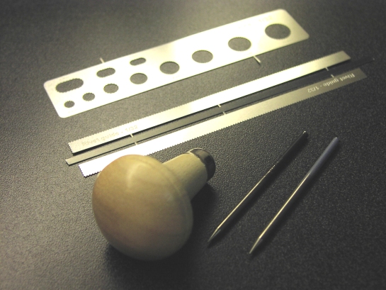

The set includes two sharp steel "riveting" pins, an ergonomic wooden handle, and three photo-etched template guides.
The tool itself is well made and stout. The large handle helps steady the riveting process and eases the force needed to produce rivet detail.
The templates are very useful and include two long straight-edged guides with different spacing depending on your subject, and a hatch/panel rivet guide with circle and oval guides in various sizes.
The set is well made and works perfectly. While I personally prefer the pounce wheel technique for overall rivet tasks, there are tight spots and difficult curves that the pounce wheels cannot navigate well.
For these tasks MDC's rivet set is perfect. The photo-etched guides are flexible and can be taped onto your model around fuselage curves and into wingroots etc.
