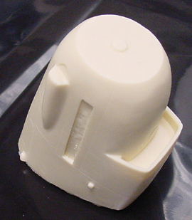

The entire nose section is a big solid and HEAVY hunk of resin, to which the exhausts, oil cooler radiator, prop spinner, and associated details are attached. This requires secure gluing, but greatly simplifies the extensive recontouring for the nose, which would be a huge job in another medium, such as vacuforming.
The spinner is beautifully molded and appears to be the correct shape for this late-model bird. The prop blades are individually molded, thus allowing propeller pitch settings to be displayed. Take care with the blades, as they are wafer-thin (I could actually SEE through mine)

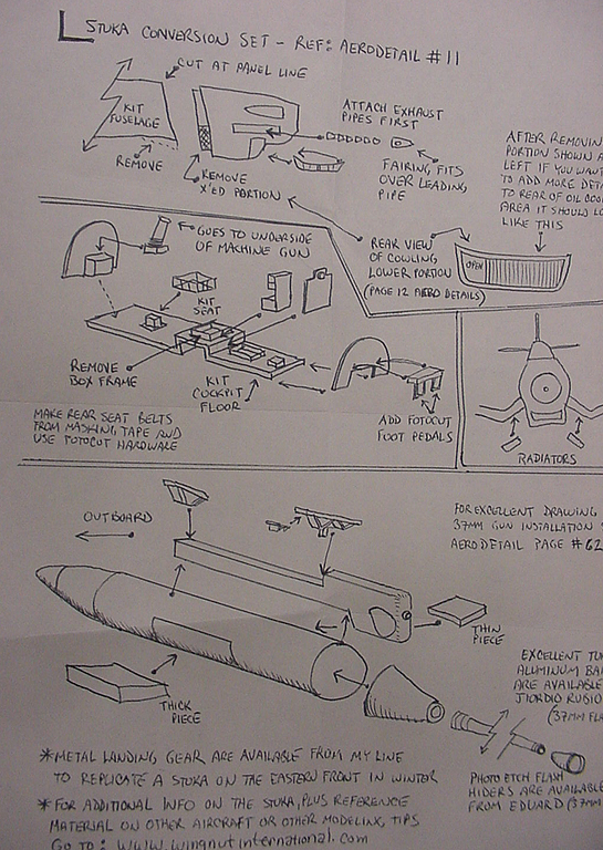

New radiators are provided, along with a simple diagram about placement.

Overall, I would say the detail on this set, while not quite as good as say, Talal Chouman's work, is still very good, easily worth the money. External panel lines are engraved, and look to scale. Anybody wanting to do a flying "T-34 opener" should pick up this set, as it will really dress up the old Revell Stuka. There is a bit of flash, but then, so what? It's RESIN! I would say the only parts of this set that need improvement are the pilot's seat and the instructions. The seat has molded-in seatbelt and buckle detail, but it isn't particularly crisp. I've chosen to scratchbuild a seat and add p/e buckles with lead foil belts instead.
