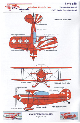

The instruction booklet in this kit is one of the best I have seen in any kit so far, its 12 pages are printed on a heavy paper stock and a there are no less than 23 color photos to get you through the construction and a full-color 3 view drawing of a Pitts S2B in the factory paint scheme.

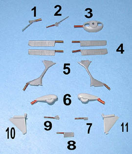

The first page of the instruction book gives you a short history of the real plane and a couple photos of the finished model. The next two pages will tell you everything that is inside the kit, with numbered photos showing all of the small parts and corresponding text so the parts can be easily identified. Barney Dunlevy who built the prototype kit also put together the instructions and as a further aid to make the building easier, he colored the pour stubs red in the photos so there would be no doubt as to what needs to be removed.
You are walked step-by-step through the building process and there are pink warning boxes to let you know of any potential problems to watch out for and yellow boxes with suggestions from his building the kit, both the warning and suggestion boxes will help save some head scratching and possible problems during the building process.

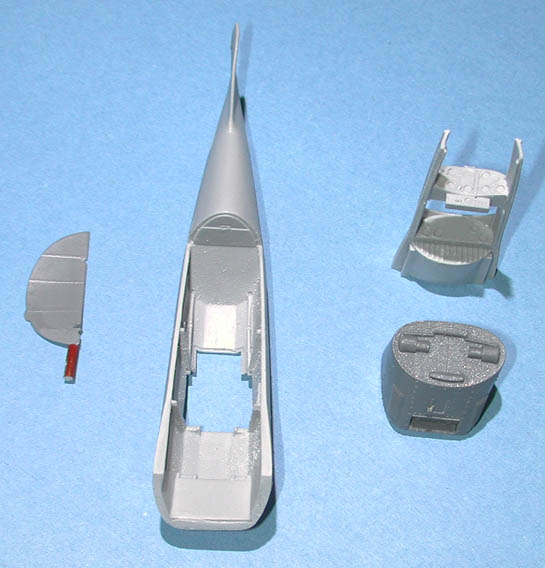

The cowl is solid resin and the engine cylinders are molded on the front, all it will need is some careful painting of the cylinders to highlight the fins as they are not that visible through the openings. The front of the cowl is a separate piece (in a picture below) as it is on the real Pitts and from my dry fitting leaves a fine line which is on the real plane. The panel lines and screw heads (of which there are very few) are finely engraved, no big troughs here!

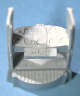

The cockpit top has both the front and rear instrument panels molded in, there are slight recesses for the instrument dials, but you will need to supply your own instruments. The kit represents the factory standard dash, but they do vary in layout to suit the individual pilots needs.
To give the pilot more room, the rear dash of the real Pitts is moved forward about three inches to give the pilot a little more room and this is captured in the models dash. The Pitts only has a few knobs and switches and these are well represented, the toggle switches are the best I have seen in any kit and there is even a key in the ignition!

The bottom of the fuselage has slots to ensure precise landing gear placement and from dry fitting my parts, they basically snapped in place without a big gap, the same goes for the fitting of the lower wing.
From my dry fitting, it doesn't look like any putty will be needed, in fact the only place that I have found that may need some putty is where the cockpit top attaches to the fuselage, but that only comes from my initial dry fitting, I'll have to see what it's like after a glue it on. I haven't tried fitting the clear vac under side window yet.
This photo shows the delicate detail molded in the fuselage, the fabric texture is very subtle and for once a fabric fuselage doesn't have the fabric sagging between the tubes. The inspection panels are slightly raised and are realistic.

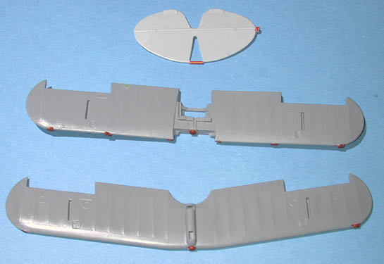

The wings and tail have the same delicate fabric detail of the fuselage and the inspection panels in there appropriate places. The wings, tail, and rudder have the pinking tape and rib stitching subtly molded in giving you realistic effect.
As can be seen in the above photo, the wings have slots for the wing struts and for the cabane struts and those parts snap in easily making alignments of the wings easy for a biplane. What is hard to see in the photos are the small recesses for the ends of the photo etch flying wires and the small holes for the aileron slaves struts.

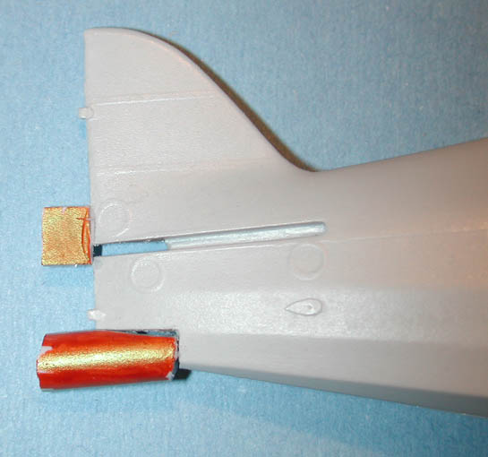

The rudder and ailerons are molded separately and can be positioned however you would like them. The elevator is attached to the stabilizer in a slight down angle and the elevator trim tabs are molded slightly raised.

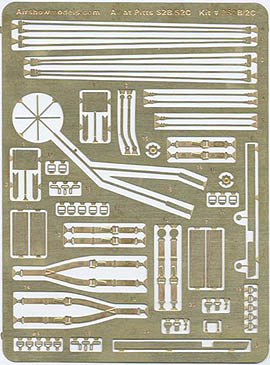

Photo-etch
The photo etch sheet is very thin and flexible with fine detail etched in the appropriate parts. The flying wires and tail brace wires are done in photo etch which will greatly simplify rigging your model. Some may think the photo etch is to flat and prefer to use fishing line, stretched sprue, or some other method, neither are completely accurate and until someone comes up with airfoil shaped rigging, the photo etch is a good compromise and the time saved is well worth it.
As I mentioned above, there are seat belt buckles and seat belts, if you choose to use the buckles and your favorite material, the photo etch seat belts will make good patterns so you can cut the belts to the right length, width, and shape the first time.
Other parts included on the sheet are the canopy rails, the sighting device for the port wing, the "floorboards", the aileron shovels, with the shovels you have the choice of using the photo etch attachments or resin attachments, with resin being the recommended choice.

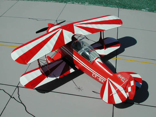

It was a long wait from the time I first heard this kit was going to be produced until it was released and the wait was well worth it. Pete would not released the kit until everything in it met his stringent standards and it shows, everything in this kit is top-quality.
The resin parts in my kit ranged from a very dark gray to a very light gray. I asked Barney if there was a particular reason for this, he talked to Brian Fawcett (who makes the masters for these kits) about it and here is a synopsis of his reply:
"Two types of resin are used in the Pitts, one is tough and has more give and the other is more suited to the thicker parts. The resin is translucent and dye is added to give a better appearance. The Pitts are only one item that uses the resin that is made and only uses a small amount of it, some of the larger jobs want a lighter colored resin and some want darker resin, when the Pitts are cast, they will use whenever dye is already mixed. The resin used for the Pitts was designed for coating undersea telephone cables and with a few changes has proven to be very good for model work."
Now that I have finished this review I have started working on the kit and it is the best resin I have run across so far.
If you're looking for something that is different from what you have been building or are suffering from AMS and are looking for something that can be built easily and quickly right out of the box and look great to boot, you don't have to look any farther than this kit.
With its bright and shiny paint job and small size, it will really stand out amongst the military planes on your shelf and on the contest table!!
