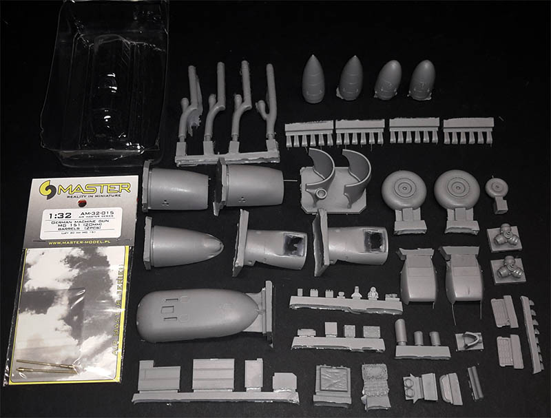

The two conversion sets appear to have no specific catalogue numbers, and this one arrived well-packed in a plain shipping box, with the annotation "F/G-2" scrawled in permanent marker on the box top. Inside, a surprisingly large number of resin and metal parts is protected by a generous serving of bubble wrap:
The parts breakdown is as follows:
- Approx. 91 parts in grey resin
- Approx. 2 parts in clear resin
- 2 vacuform clear canopy parts
- 2 photo-etched sheets
- 2 turned-brass gun barrels
- a set of 4 Rüstsatz M5 underwing rockets
- 3 decal sheets
- 1 CD-ROM containing instructions and reference images

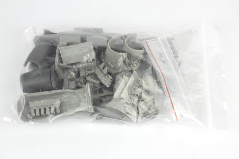

The resin parts are all contained within a single resealable plastic bag:

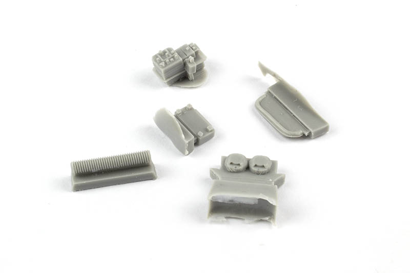

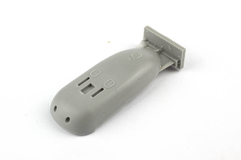

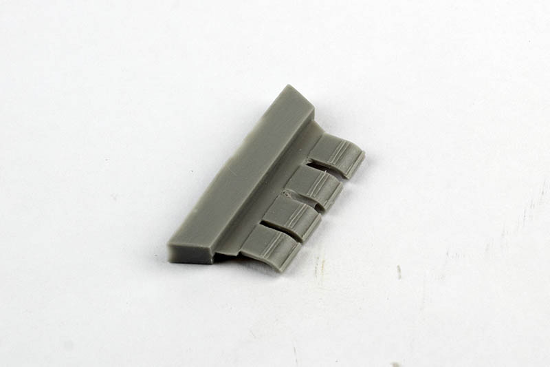

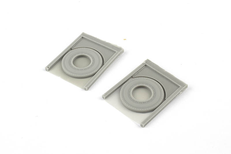

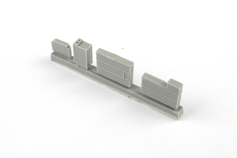

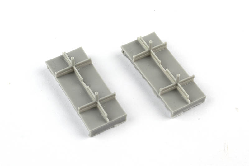

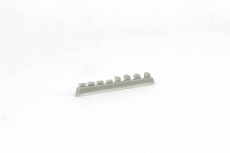

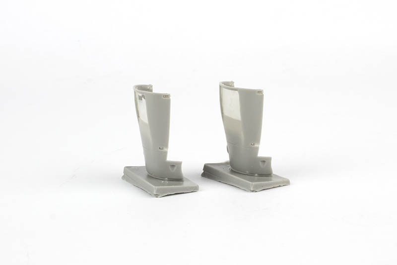

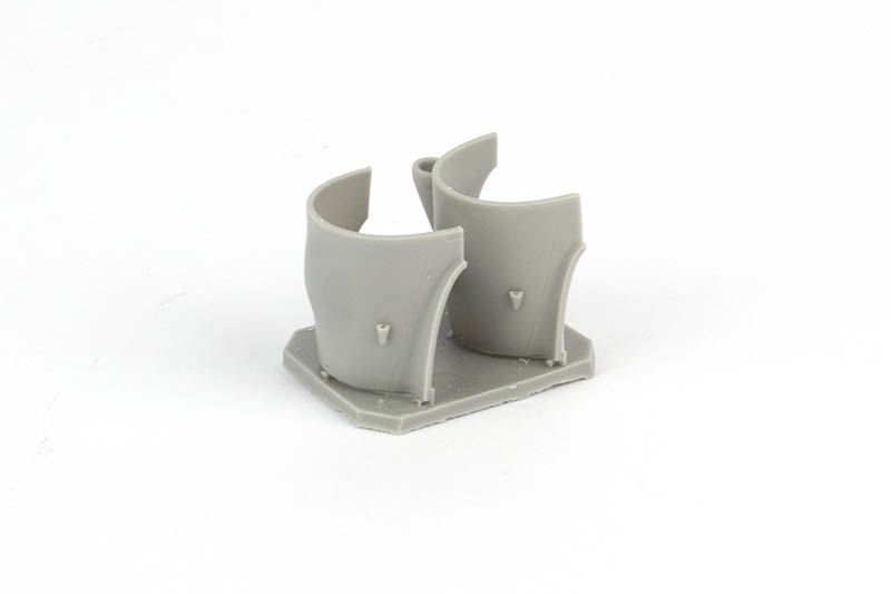

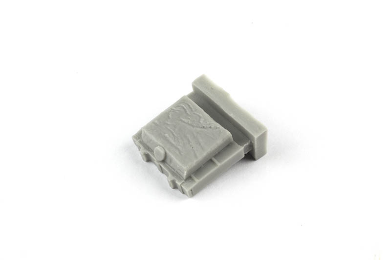

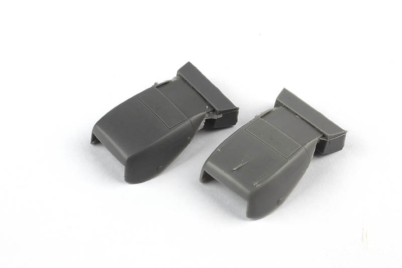

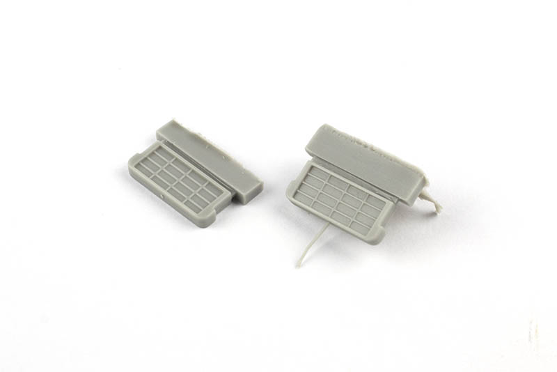

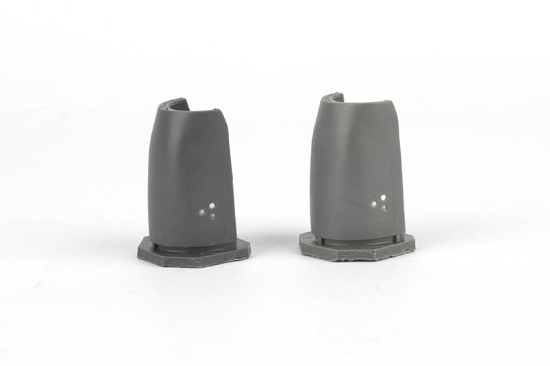

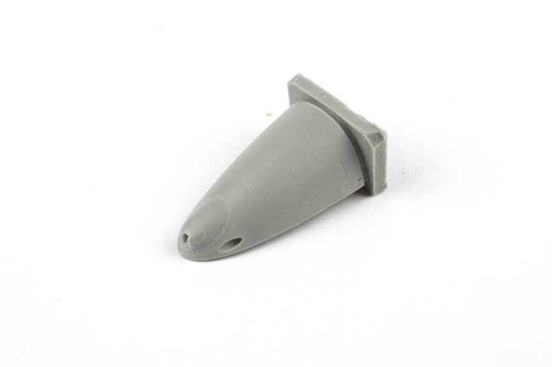

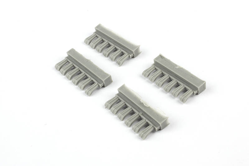

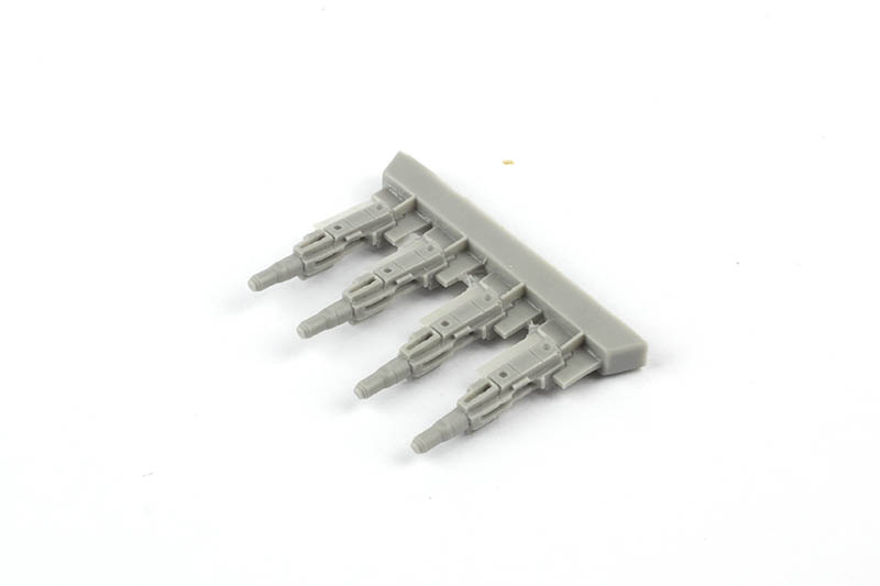

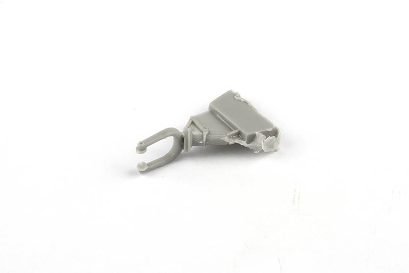

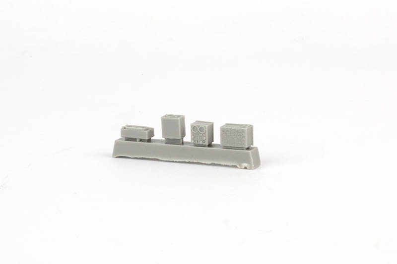

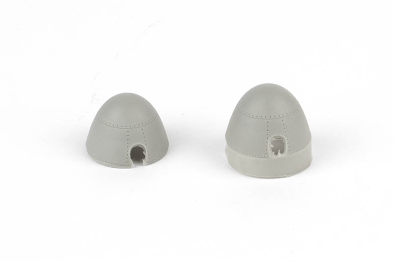

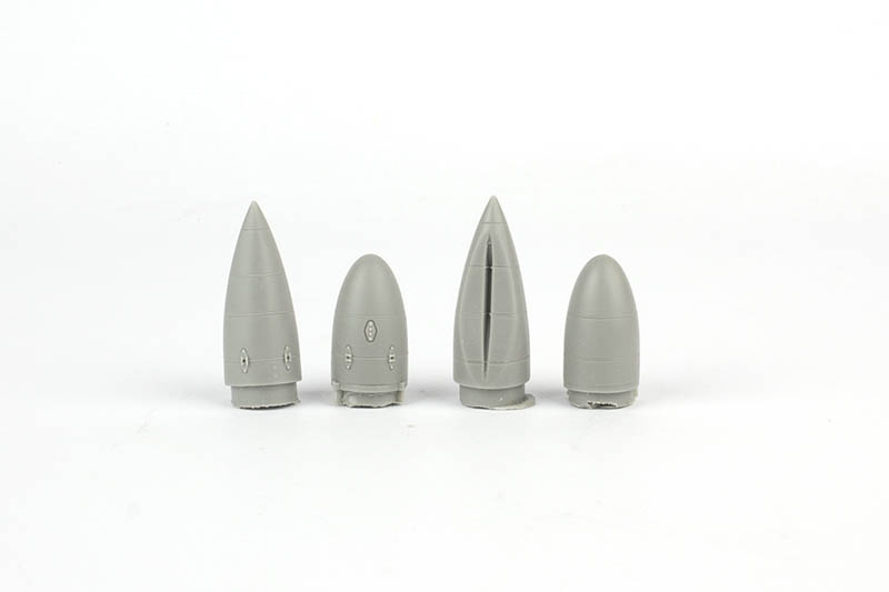

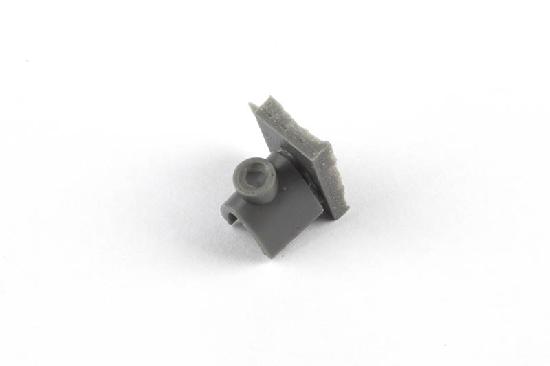

The quality of the casting is largely excellent, with all the cowling and radiator parts hollow-cast. There is, however, a small damaged section on one of the radiators in my sample:

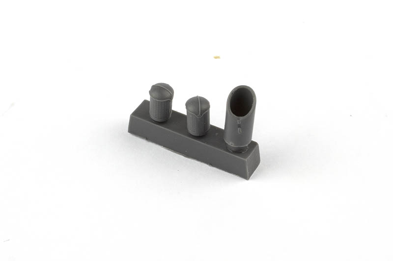

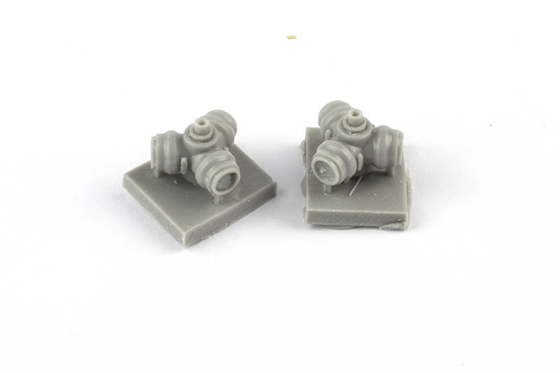

Also present is the expected resin casting flash, which is at its worst on the exhaust flame-dampers:
This is simply the nature of the medium, and given that this set is intended for experienced modellers, should present no problems.
The nacelle parts are intended to be direct replacement for the kit parts, meaning that surgery on the kit parts is kept to a minimum, and this will also minimise the potential for errors leading to fit problems.

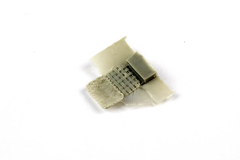

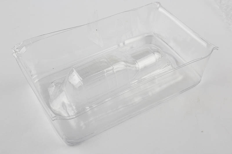

A pair of clear resin parts is included, and while difficult to see in the photo below, they replace the wing-tip parts (F19 & F44) in the kit, allowing for a seam-free representation of the clear landing lights:
