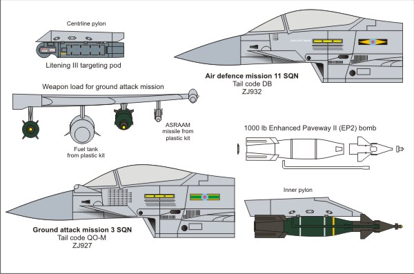

The set provides 4 x 1000lb Enhanced Paveway II laser guided bombs, GPS conduits, a Litening III targeting pod, new inner wing pylons and a centreline pylon, moulded in an unusual resin shade of pale blue, along with a small set of decals.

A small decal sheet is supplied that provides some ordinance stencils and mission markings/codes for two airframes - squadron markings will have to come from the kit, or other aftermarket sheets.
- ZJ932 'DB' of 11 Squadron, Royal Air Force
- ZJ927 'QO-M' of 3 Squadron, Royal Air Force
A useful set to make your Typhoon look a little different, but I have to say I was a little disappointed with the overall quality of this set, especially at the price (£43.60 at time of writing, here in the UK).
