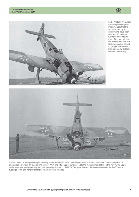

This unique 24 page publication, takes a look at one particular wrecked Fw 190A-8, Werknummer 175 140, possibly (as reported in numerous other publications) either Black, Brown or Blue 6 + - of II/JG26, and attempts to analyze the colors, based in part on a comparison of photos of the machine itself from various angles, as well as from written reports and at least one color image of a Bf 109G-6 that sported a similar mix of colors (for comparative analysis), in addition to some other non-restored museum example and related wartime color photographs of similar haphazard mixing of schemes and introduction of new colors.
The author of this work (Brown) has methodically examined the photographic and written records, and drawn what seem to be perfectly logical conclusions based upon that evidence. His conclusion is that this particular Fw 190A-8 is in fact Brown (with black outlines) 6, with Brown (also outlined in black), horizontal bar; overall colors being 76 (fuselage sides and aircraft bottom) 74/75 horizontal tail and fuselage spine, 74/77 wing uppers with large patch of 76 on port wing, and possibly RLM 74 flap bottom (starboard side, & perhaps both, though port side is not clearly visible). I can find no fault with his conclusions (though I'm certainly no expert, by any means), and applaud the depth of research that was involved to finally be able to end the mystery that has shrouded this particular machine for many years.
Note: Though the author maintains that the flap bottom is a darker color than the surrounding RLM 76, quite possibly RLM 74, the accompanying illustration does not depict it that way. Also illustrated in the artwork, is a rather large white 7 on the rudder, but I find no mention of this in the text, nor can I see it on any of the corresponding photos.
