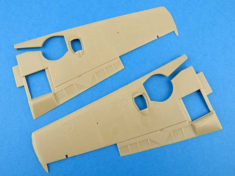

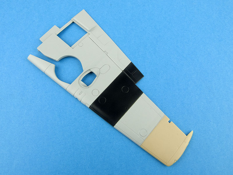

Since I didn't have a current project suitable to test with, I had to dig around in my stash for something I could sacrifice to the cause. This proved more difficult than I thought, but eventually I settled on a Matchbox 1/32 Bf 109E kit that I had started some years ago, but never progressed beyond some basic surface preparation. I decided to use the two lower wing parts:
You can see from the photo that the surfaces had been sanded previously, which meant they required a bit more work to prepare them for the job. As we know, surface preparation is crucial when trying to achieve a convincing natural metal effect. After some work with a polishing stick, I laid down some Tamiya Fine Grey primer, straight out of the can. In order to test the paint's performance on bare plastic, I masked off the end portions of each part before priming:
Since one of the supplied colours is Black Base, I decided to mask off a single panel on each wing and apply this colour to it. This way, I could test if varying the underlying colour had any effect on the metallic top coat:

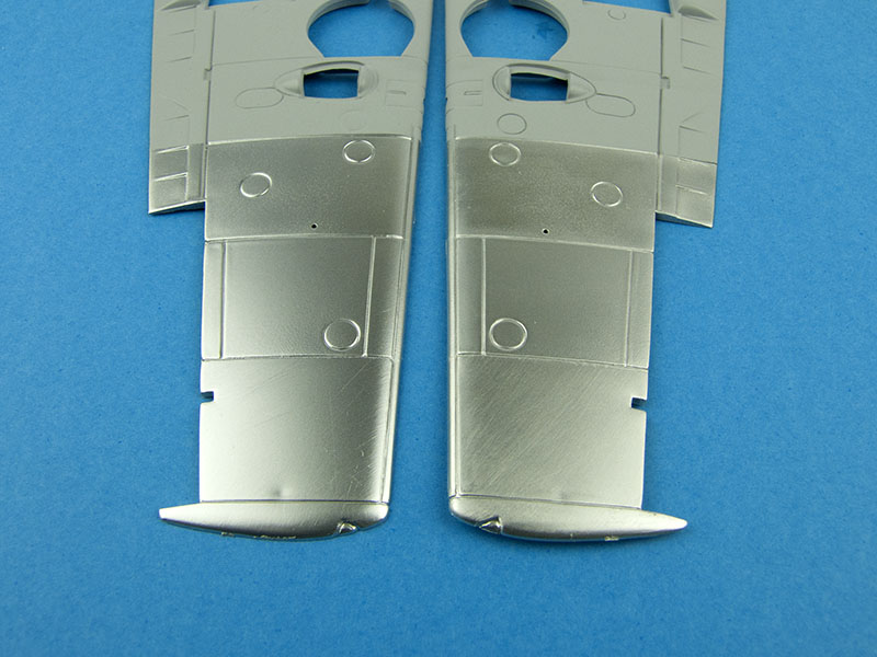

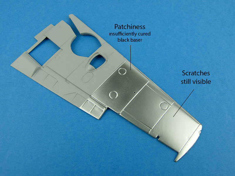

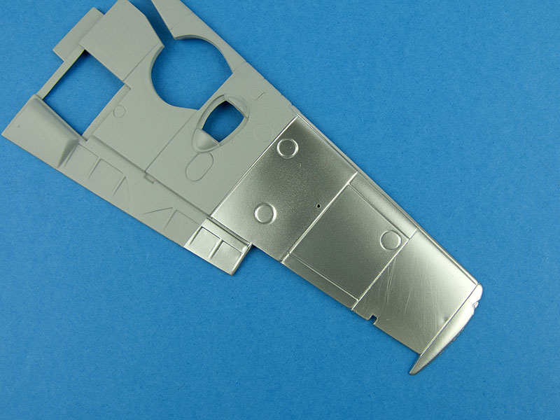

After giving this around 10 minutes to dry, I set the compressor to give a working pressure of around 10-12 PSI, and laid down some AK 479 Aluminium, using an Iwata HP-C Plus:
As you can see, the results were disappointing. The effect over the Black Base is rough and patchy, while the result over the Tamiya primer reveals some underlying orange peel in the primer coat. And you can see that my preparation of the bare plastic was inadequate, with many scratches remaining highly visible. This is in fact a testament to how thin and precise these paints are, revealing every surface flaw, no matter how minor.

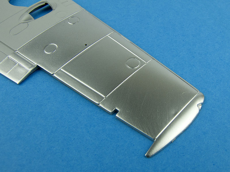

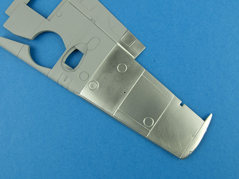

I persevered, and applied some AK 481 Polished Aluminium on the other wing:
Not only were the results the same, but there was no discernible difference between the two shades:
By this stage I had already determined that my methodology was not optimal. Ten minutes was clearly not an adequate amount of time to leave the Black Base to cure before over-coating with the metal colour. I had also realised that 10-12 PSI was insufficient pressure to atomise these paints effectively. And these paints were especially unforgiving of my inadequate surface preparation. Every new paint presents a new learning curve!
Before abandoning this round of testing, I decided to perform a 'tape test' to get an idea of the paint's durability. After a couple of hours' drying time, and using fresh Tamiya tape, I laid a segment down over each combination - Aluminium over primer and plastic; Polished Aluminium over primer and plastic:
And the results:
The Aluminium over bare plastic lifted easily, while neither paint was affected much where it was laid down over the primer. In each case, though, some very slight tape marks were visible, and there was some slight evidence of some silver pigment on the adhesive side of each piece of tape. I figured it was entirely possible that I had performed this test too soon, but it was clear that Xtreme Metal paints really require a primer.
