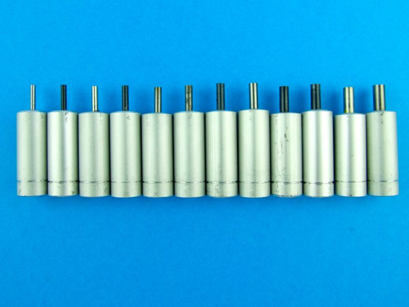

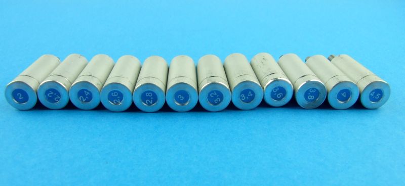

Hungarian firm RP Toolz specialises in quality model-making tools, and recently extended its range of punch-and-die sets with a unit designed to produce larger holes than the other sets it has available. There are 12 punches in all, ranging in diameter from 2mm to 4.5mm, in 0.2mm graduations up to 4mm, with a final jump of 0.5mm.

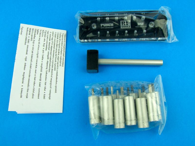

The set ships in a sturdy cardboard box, with both the punches and the die base housed in separate resealable bags. Also included is a small hammer for working the punches:
The die base is an extremely well-manufactured unit, and is surprisingly heavy. According to Peter from RP Toolz, the bottom section is made from steel, while the top piece is a beautifully clear piece of acrylic. There's a piece of black galvanised steel sandwiched between them. The black knobs appear to be ABS plastic, and are used to help clamp the chosen material between the top and middle sections. Each has a tension spring under it.
The included information sheet notes that the set can be used with plastic, PVC, aluminium, brass and styrene, but I've confined my testing to the last two materials in that list. For these tests, I used both the included hammer, and a small craft hammer that I normally use with my punch sets:
The included hammer is small and very light, so having one with some extra heft is recommended.

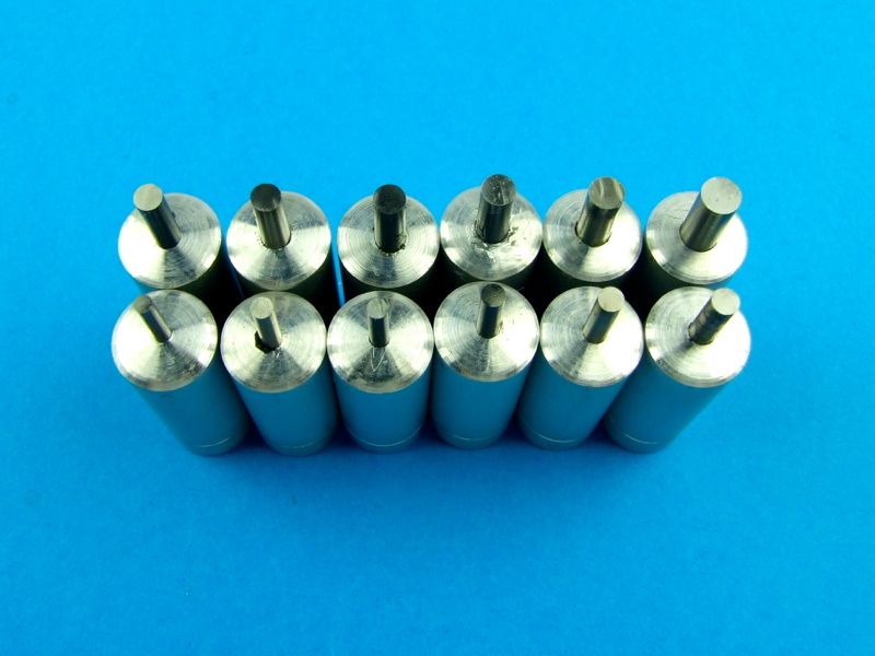

The punch action through the die is smooth and clean, with no sense of being hung up at any point. The design of the punch, with the shaft embedded into a large barrel, means there is a built-in stop on the punch's travel. This is not the case with sets such as Waldron's, where it's possible to drive the punch straight into the workbench, potentially damaging both, and pulverising the resultant disc. With this set, the punch stops short of the full depth of the base, which prevents this from happening, and produces a more consistent result.
