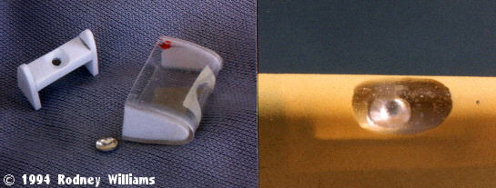

The wings landing light was hand crafted using styrene and clear plastic. I heated the clear plastic so I could bend it around the light frame. The lights lens came from my box of "railroad train lights."

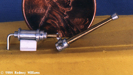

Remember, I was building both the "D" and "B" models at the same time, so I made both parts at the same time for both aircraft. Here you see one tail wheel installed on one model, while the other unit is next to it. I revised the kit tail wheel assembly.

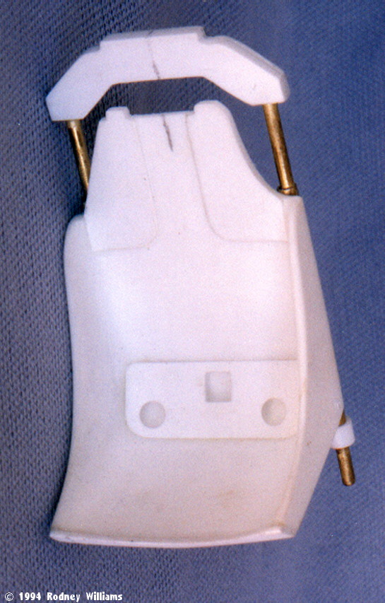

This very close up view shows the push rod arrangement for the trim tab on the rudders!

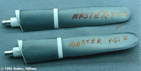

Reviewing my photos, I notice some sort of flange on the bottom of the P-51B "cuffed" blade. I did not see it on the "D" model, so I had to revise the kit blades, making two "masters" and add all the right stuff!!!! The spinner's were revised, and I added a aluminum tubing cross bar. After the two part spinner was glued together, the cross bars moved left and right, and in and out slightly. This allows you to put the prop blades into each hole, then align them properly.

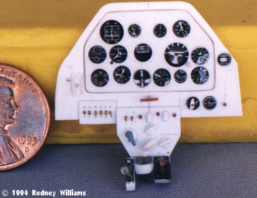

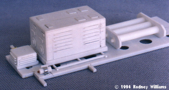

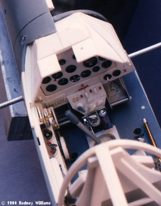

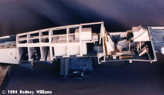

What can I say about the cockpit? The photos just have to tell the story about scratch building each piece. It's time consuming to say the least. One I was ask: "Rodney, how do you paint everything once it's glued together?" My email reply was: "All of these items are put together with white glue, so I know "EVERYTHING" fit, when I dry fit the other side of the fuselage. Next, I take all my photos, then soak all the parts in water. After I clean off the glue, they are painted and re-assembled with white glue, and then the other fuselage half is permanently attached.
