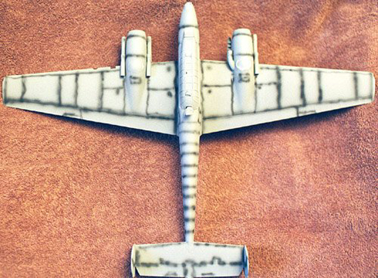

After joining the major sub-assemblies, I used Black Magic canopy masks, the first time I’ve used these vinyl masks. This was a godsend, allowing me to simplify the tedious job of using masking tape to paint this veritable glasshouse of a canopy. Except for two masks being juxtaposed on the sheet, this was a well-fitting and highly-recommended accessory for anyone building this kit. I primed the model, pre-shaded it with black, and painted it RLM 76 overall. Next I mottled the top surfaces using my Badger 175 with medium needle and Tamiya acrylic paint. I painstakingly applied the mottling in a dark gray RLM 75. I was happy with the results but am considering changing brands of paint because Tamiya seems to dry fast and clog my needle after about 10-minutes of spraying. I had to constantly swipe the nozzle with a rag to prevent paint from spattering.

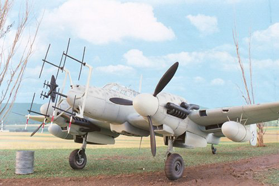

Affixing the radar array proved difficult as the fragile parts did not align with the fuselage attachment points. Along with the landing gear, gear doors, and drop tanks, I attached the radar array with five-minute epoxy. All in all, the brass parts fit well and improved the overall appearance of the model immensely.

Here is a list of some of the kit’s inaccuracies and how I addressed them:
- exhaust openings on nacelles too large. I used sheet styrene to close them down.
- shell ejection ports cut into lower nose section puttied closed as these are not indicated by my references
- kit spinners discarded as they are short and pointed. Scratch built corrected ones.
- underside cannon troughs bored out
- brass tubing used for cannon barrels
- fuselage hand-grabs oriented wrong. I sanded these off and etched them correctly
- kit has a lot of dimpling. Most of them I sanded a bit or filled where I could.
- 2 half-circle cut outs on left-bottom wing and fuselage puttied
- added detail to cockpit
- scratch built MK 108 gas exhaust port underside as references indicate
- re-drilled tail wheel gear hole 3mm farther aft
- rudder shapes are wrong. I modified them closer to the correct shape.
- used brass rod for support braces for radiator openings.
- scratch built clear bubble on upper canopy
- added 300-liter wing drop tanks acquired from other kits
- added gauge windows to inner nacelles
- added shell ejection ports
- machine guns detailed
- ETC 500/1XB bomb rack too deep. Some detailing to this area.
In addition to the previously-mentioned inaccuracies of this kit are the following:
- tires are treaded when they should be smooth
- landing gear have accordion shock boots from earlier variant 110s
- decal instructions for decal 8 and 9 have them juxtaposed
- no swastika and some stencil decals not included; fuel decals faded to almost white
