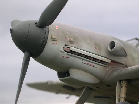

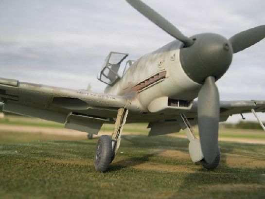

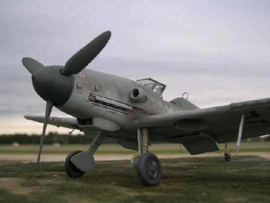

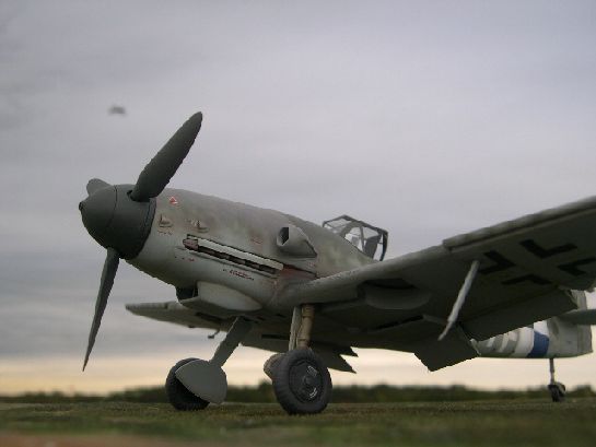

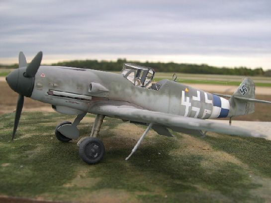

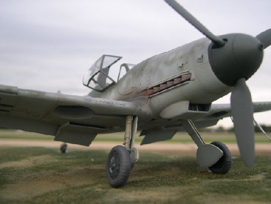

The Cutting Edge conversion is molded in light gray plastic and is bubble free and distortion free. The Erla conversion is very unique and Cutting Edge has accurately captured the asymmetrical look of the cowlings. The cowlings add a very different look over the standard G-10. You are provided with new front cowlings, the upper saddle panel, the square panel for the left side and the elliptical panel for the left. Also provided is a new radiator, a supercharger inlet, as well as, two sets of scoops, exhaust stacks and guns. Generally a very good fit on all the parts. All panel lines are recessed. The only issue I found with the set was having to scribe the saddle panel grab handles on top with the Eduard photo etch templates. You will also have to drill the drain hole on the bottom of the front cowling and the crank handle on the right cowling. Neither is a difficult endeavor.
If you use the G-14 kit, the only issue with this conversion set is that you are limited to the small kidney shaped bulges on the wings and the small tail wheel. It is only a small issue as many of the Type 110 aircraft had the smaller wheels, but a few did have the larger wheels and associated bulges and tall tail wheels so check your references.
Construction is very straightforward and there are no big issues. All the cuts are along natural panel lines and are a straight drop in fit for the kit parts, except for the canopy. The nose has to be cut from the firewall down and then the kit saddle panel has to be removed. After that everything is an easy fit once the casting blocks are removed. The cowlings have cuts for the fuselage to fit into. This ensures that you the cowlings are straight. You will have to use caution in the engine exhaust area and the gun troughs. Both of them have flashed over resin (to ease casting) that has to be removed. It is fairly easy to remove them and they represented very little problem.

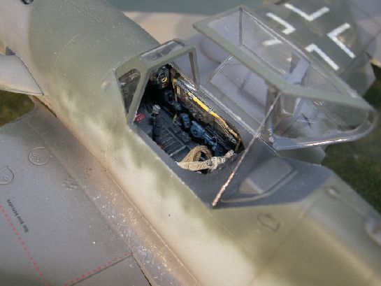

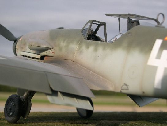

Because I used an aftermarket cockpit I elected to cut the cowling alignment area. It wasn't a real issue, but if I had to do it again I would not cut the cowling. I would modify the cockpit. This is the only thing I had to do different with the cockpit set. The cockpit still fit beautifully and greatly enhanced the look.
The cockpit is very nicely detailed. Yes, yes, I know that the G-6 cockpit differed slightly from the G-10, but I don't really care. It looks really nice in there. I wanted to try the poseable seatbelts. This set was a little thick but I have another set where they are much thinner, so check your set. I used a scalpel blade to cut the belts out and painted them with Polly-S paints. I would recommend using an enamel next time, but they took the paint well and look very nice. I can see the merits of the poseable belts. I liked them but I also like the molded on type. The choice is up to the modeler.
The cockpit was painted with Model Master RLM 66 and dry brushed with RLM 02. Some silver paint and pencil were added to simulate chipped and worn areas. Details were picked out with red, yellow and blue.

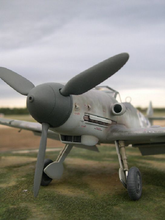

Messerschmitt Bf 109 Spinner - EP#20-32
In my opinion, the worse part of the Hasegawa kit is the spinner, regardless of the version. This makes the Eagle Editions spinner a required essential. The Eagle Editions spinner is much better looking than the one offered in the kit. The fit is great as long as you follow the instructions.

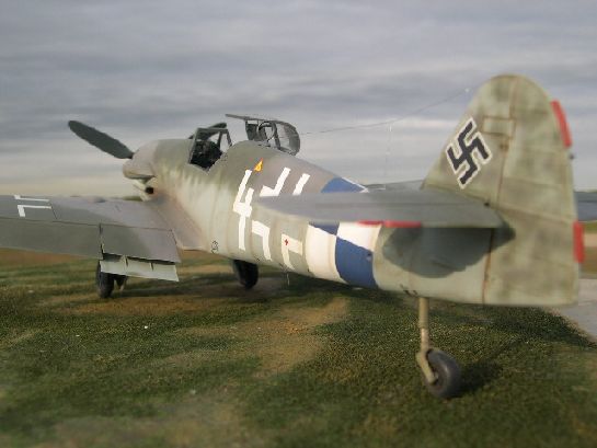

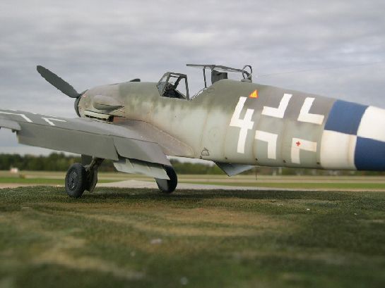

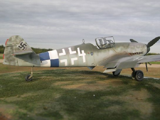

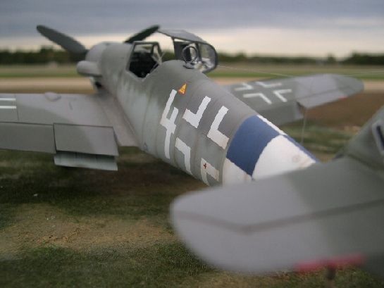

Markings are provided for three aircraft and choosing one was difficult. A "regular" 109 from JG77 is included. There are two Type 110 cowled machines, one from JG300 with a rust red band and "Gisela" under the cockpit and the other is "White 4" with a white and blue checkerboard design. I chose "White 4" because of the late war semi-defensive colors and the checkers looked very colorful. The Cutting Edge decals are thin in perfect register and very opaque. They worked beautifully and conformed real well with MicroSol and Set. The decal sheet does not include the simplified crosses for the airplane that I chose. I thought this strange, but the Hasegawa decals actually worked real well. I was surprised and shocked as the Hasegawa decals were not that thick and are useable.

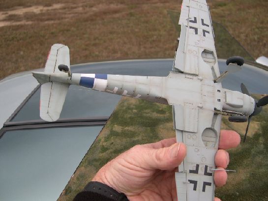

I elected to do a G-10 from the decal sheet with the blue and white checkerboard. The aircraft was a typical late war RLM 75/83 machine with limited mottling. Cutting Edge depicts it with a long tail wheel and large wing bulges, but because the picture that the markings are based on shows the aircraft as a heap of metal the wings aren't visible so I used a little artistic license and used the smaller wheels and bulges for the wings with the long tail wheel. I'm not saying that Cutting Edge is wrong or right but noone knows for sure so prove me wrong. It still looks cool.

I start my weathering with a Burnt Umber wash in all panel lines. This is followed up with silver pencil for chipped areas, such as the wing root. A mixture of 50/50 Tamiya Flat Black and Red Brown was highly thinned and airbrushed to the exhaust area. Weathering was brought to an end with some pastels applied to the wing root area. Everything was sealed with another coat of flat.
Final bits were added and the model was completed.

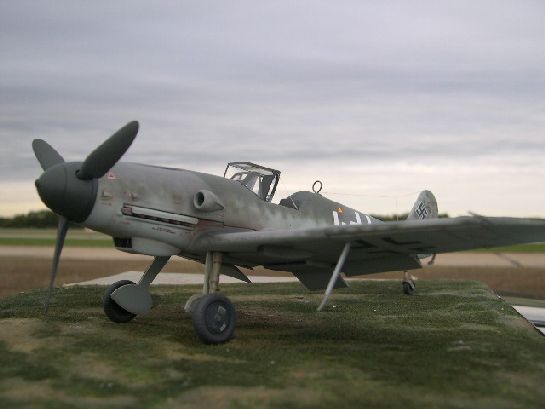

The Cutting Edge conversion is very easy to use, even though it is recommended for experienced modelers, and makes a very unique looking airplane. Remember the conversion is based on the G-14 kit and not the G-10. With that said, I can highly recommend it. I hope they do this conversion in 1/48th scale. The Cutting Edge cockpit looks really nice and adds considerably to the look of the model, again highly recommended. The Cutting Edge detail set is highly recommended and essential to add that extra level of detail. The Cutting Edge tail wheel is highly recommended for its strength and improvement over the kit part, if you used your G-10 strut, or as a replacement. The Cutting Edge decals are an excellent supplement to the kit decals and required for the conversion set. The colorful machines are nicely done. The Eagle Editions spinner is essential and adds greatly to the kit's appearance. I was very happy with the conversion and all the items that I used. I think the unique shaped cowl along with the blue and white checkerboards make this a very nice looking model.
