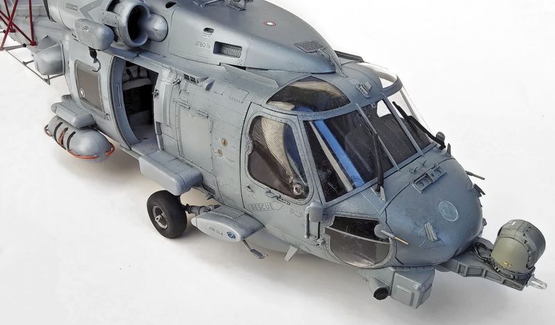

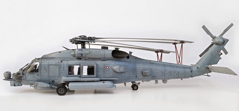

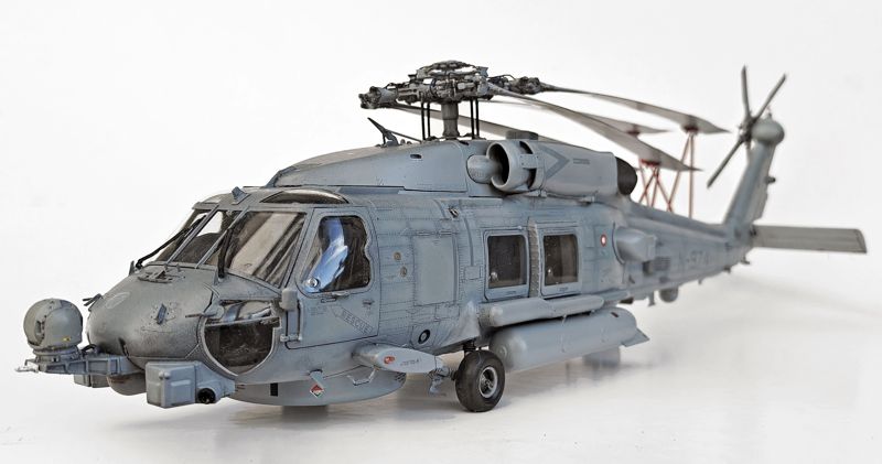

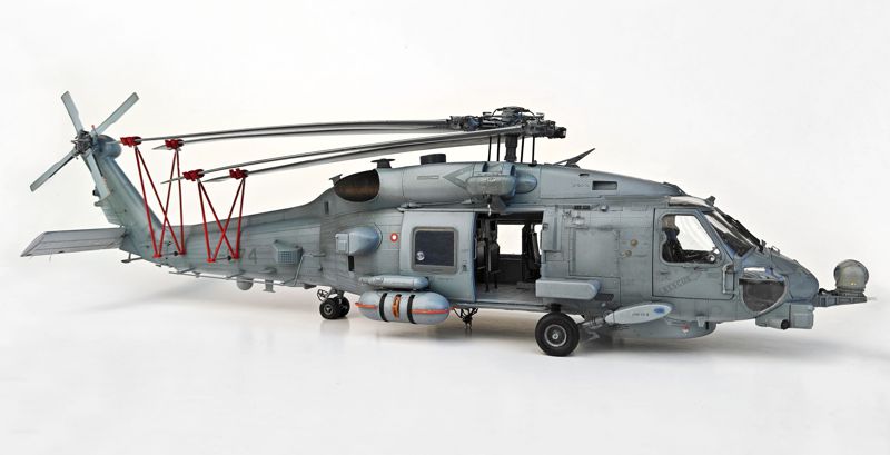

The Kit: Kitty Hawk Models 1/35 scale MH-60R “Seahawk.”

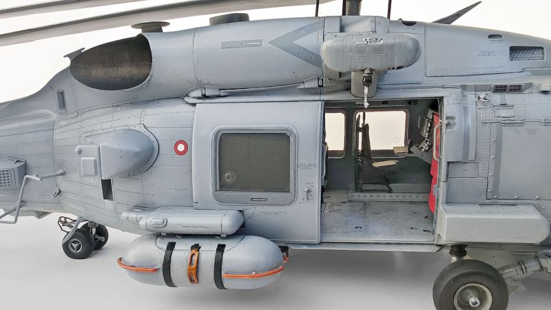

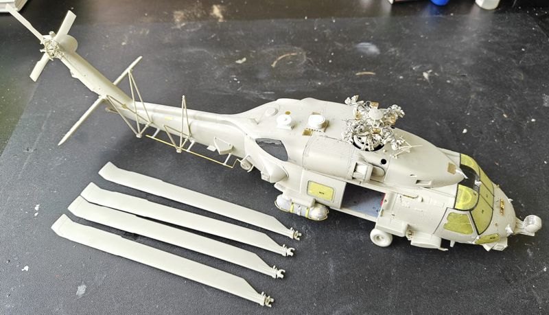

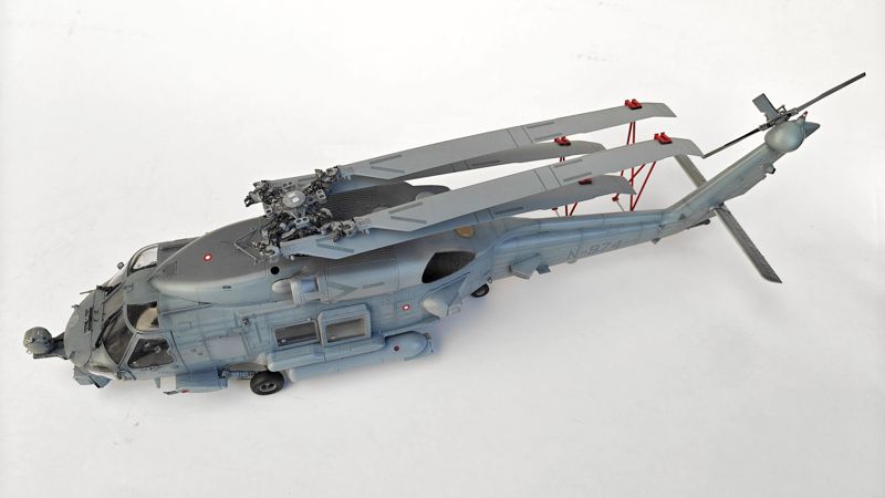

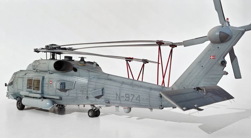

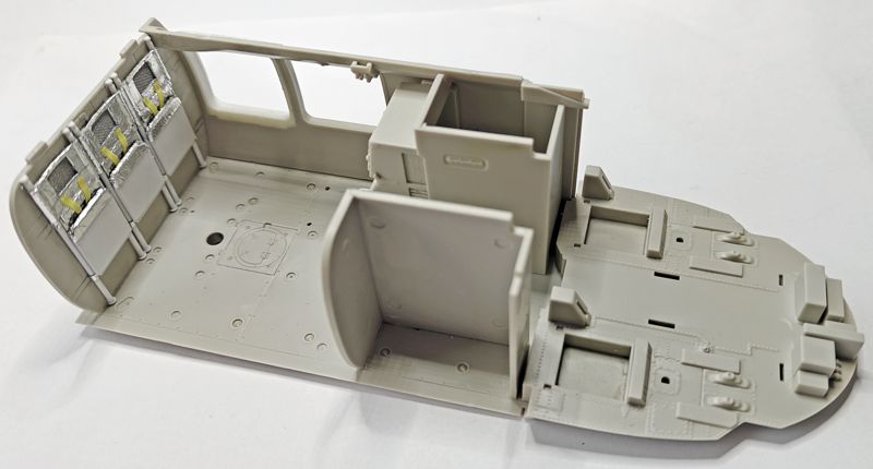

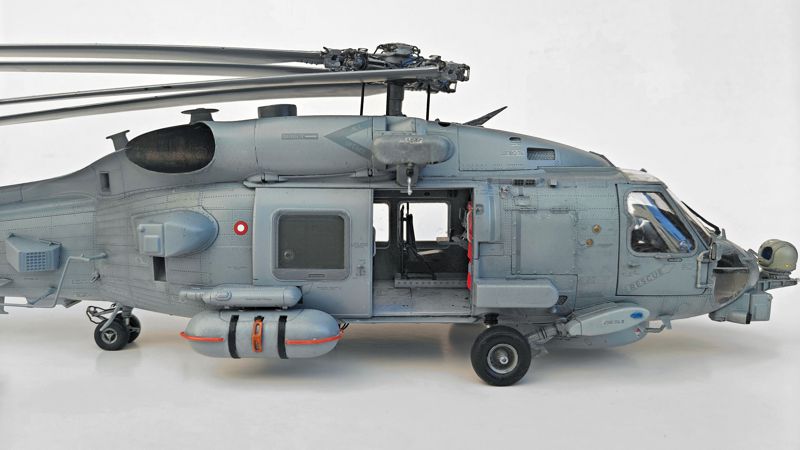

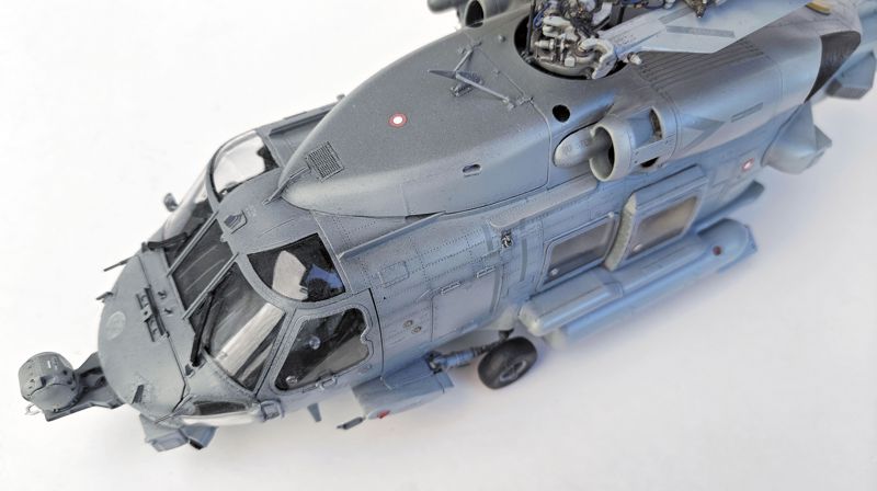

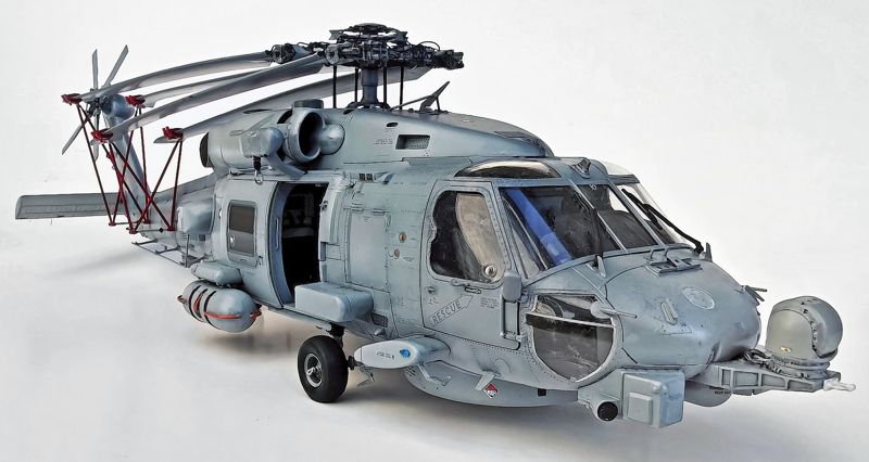

The kit features recessed surface detail, a highly detailed cockpit, and mission equipment specific to the Romeo variant. External stores, sensors, and landing gear components are accurately reproduced, making this an impressive large-scale model. The model can be built with the rotors either extended or folded. I did have quite a few issues with it and its instructions: wrong numbers for parts and parts that existed but had no id on the plans. The large number of extra parts, which are not intended to be used in the assembly of the MH-60R model, does not make things any easier. But then again there are parts included which I needed for the Danish version.

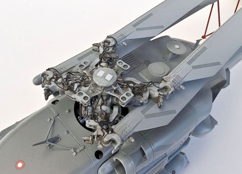

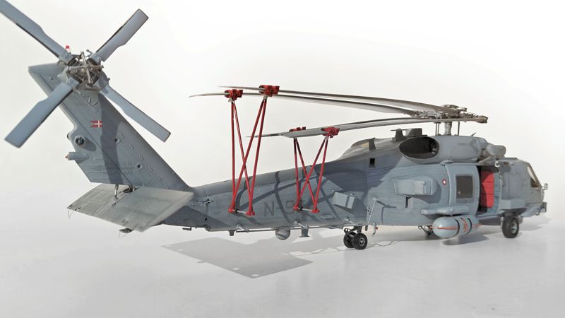

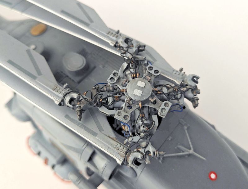

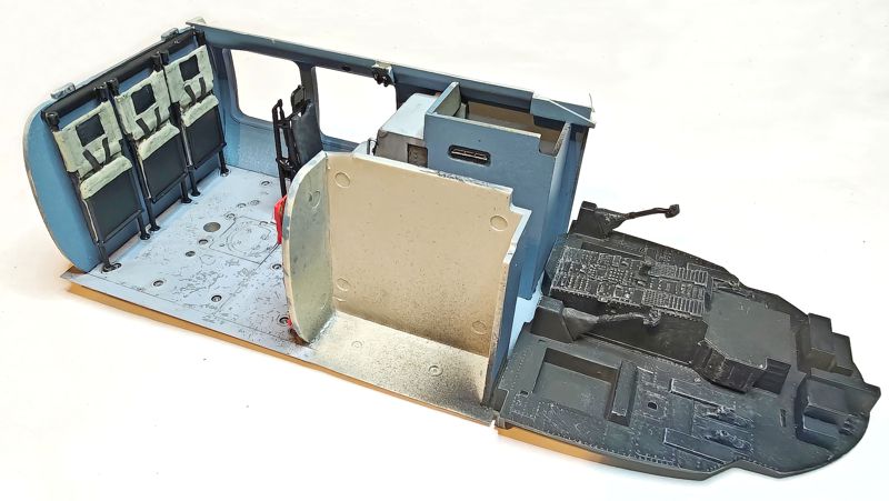

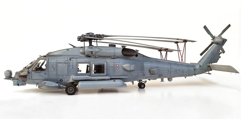

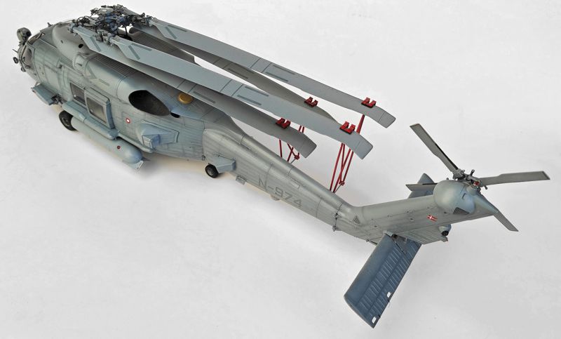

So many alterations to get a RDAF Seahawk: ELRP, AN/ALQ-144’s, hydraulic Harpoon, Antenna, SATCOMM, cable cutters, etc. And the rotor requires all the cabling which had to be scratched. I decided to replace the Sonobuoys launch equipment with the window instead, because it is rare to see this installation on the Danish Seahawk’s. This requires both inside and outside work and I had to cast the extra glass from clear resin. The Danish Seahawk’s have Martin Baker ‘Troop Gunner’ seats, so they had to be scratch-built using different materials.

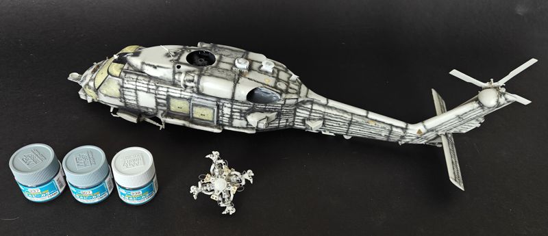

Gunze Mr Hobby paints were used for it: H337 (FS35237), H307 (FS36320) and H338 (FS36495).
AOA decals Low-Viz Seahawk Family (1). Essential for stencils and standard markings.

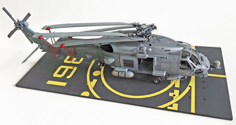

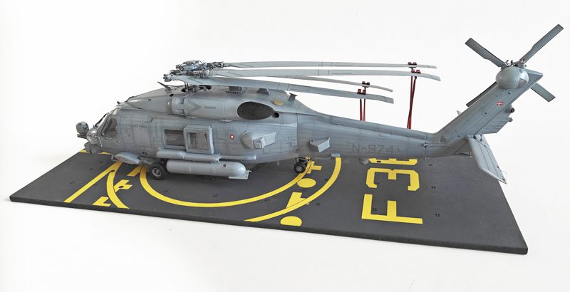

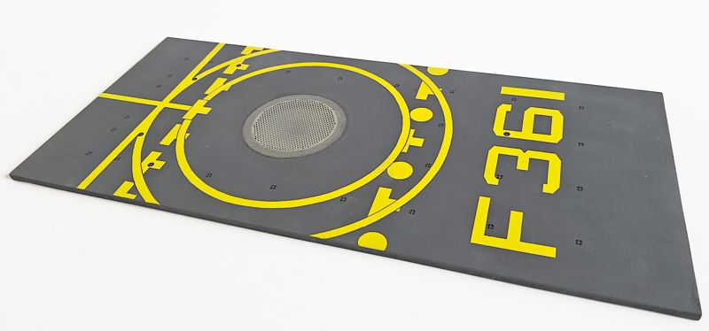

Display base of deck with grid to for the ‘harpoon.’
Reference: Sikorsky MH-60 R/S/T Seahawk Duke Hawkins 041 - 148 pages. This book is a comprehensive account of the Seahawk helicopter, and it contains a large amount of information about the Danish Seahawk helicopters.
