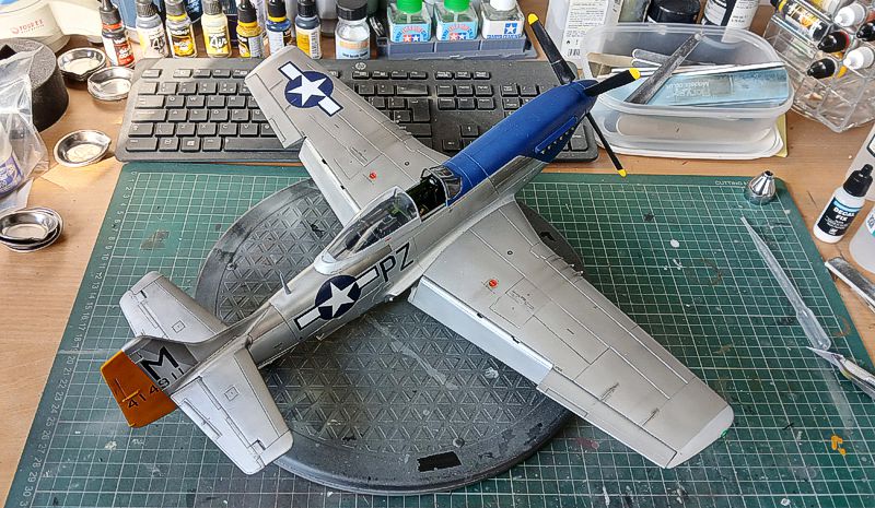

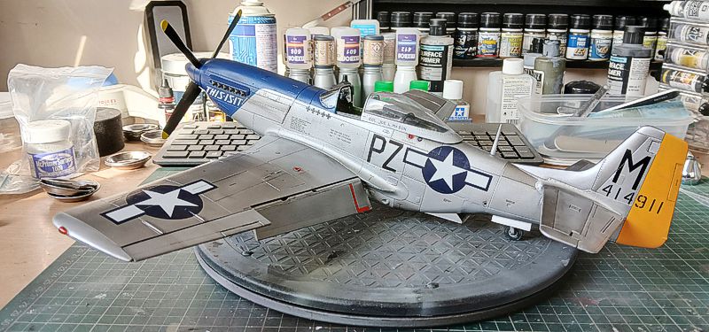

I present my 1/24 P-51D Mustang kit No. A14001V, built from the re-release of the 1970's mould. I'd like to say it was enjoyable but it has really tested me. When I purchased it somebody made rather derogatory remarks about the kit being just a pile of plastic waiting for the trash bin... and quite honestly it nearly went that way a few times. Nevertheless I persevered and I'm happy to have finished it. There are a number of things I wish I had done better, the engine side cowls in particular.

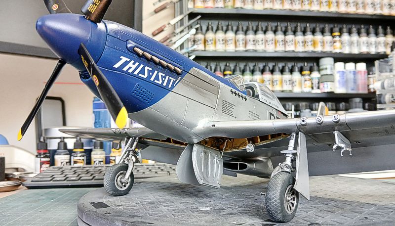

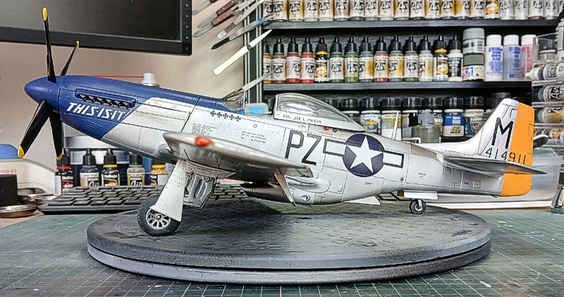

Modifications made along the way include:

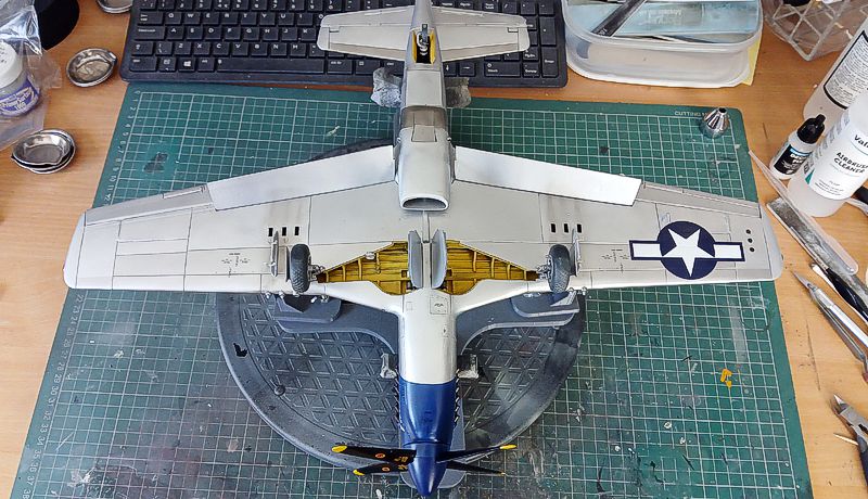

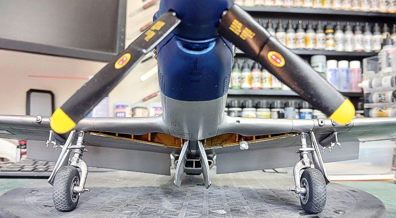

- Lowering the flaps
- Adding a wingspar and undercarriage bay
- Thinning and polishing the life out of the canopy
- Cutting out the front air scoop, plus adding in the internal "flue" between the radiator and the vent

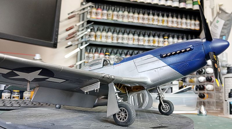

- Constructing undercarriage doors (inners and outers)
- Detailing the bomb racks

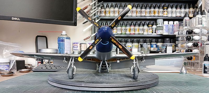

- Replacing the guns with aluminium tubing
- Remodelling the undercarriage with a combination of plastic and metal parts
I also used the following aftermarket parts:
- Airscale Harness
- Airscale Cockpit instruments and placards
- Airscale Pro P51 Parts Set
- Model Monkey Upper Cowling
- Model Monkey Wheel Well
- Model Monkey Rudder Pedals
- Scale Aircraft Conversions Metal Landing Gear (designed to be used with Trumpeter kits)
Enjoy!
