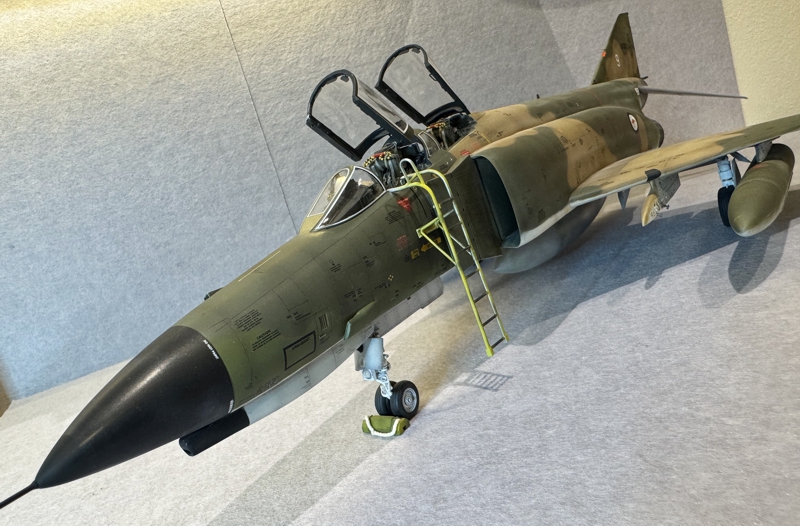

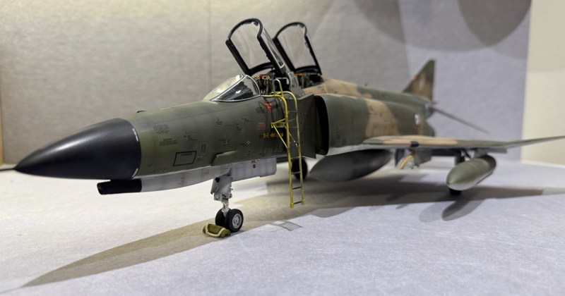

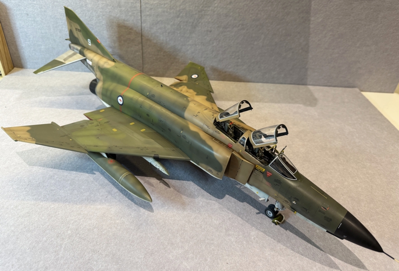

Here is my Academy 1/32 F-4E.
It is finished in RAAF '70-'73 livery when Australia leased them, awaiting the F-111. All the RAAF aircraft went through various upgrade programs, and the modified extended Gun-muzzle came in gradually to the type in ‘71.

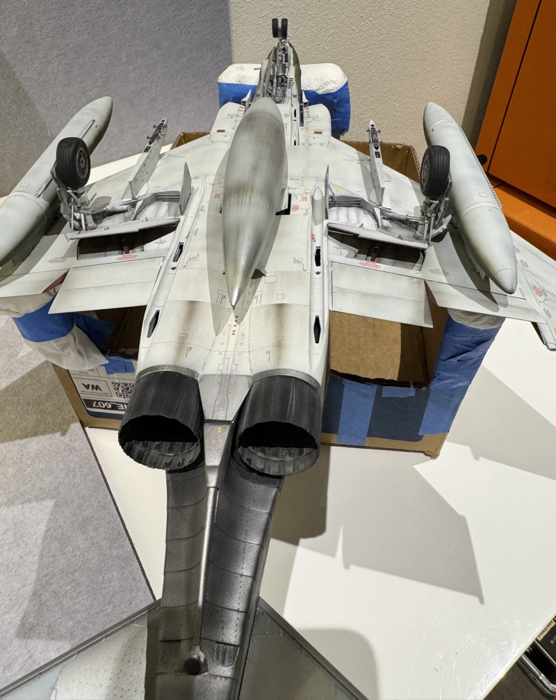

This puppy took quite a while to get right. The Academy kit is a rehash of the Revell, so, yeah, not good but currently the only game in town for a F-4E. The kit was little more than a usable basic shell, which was fine because that's what we do. I figure it took 3 weeks alone to correctly manufacture the seamless engine intakes.

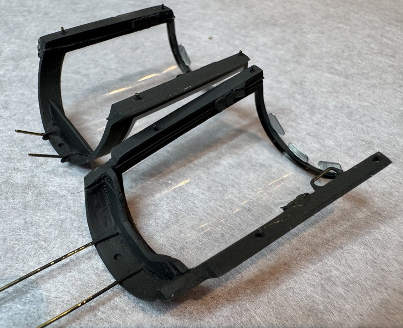

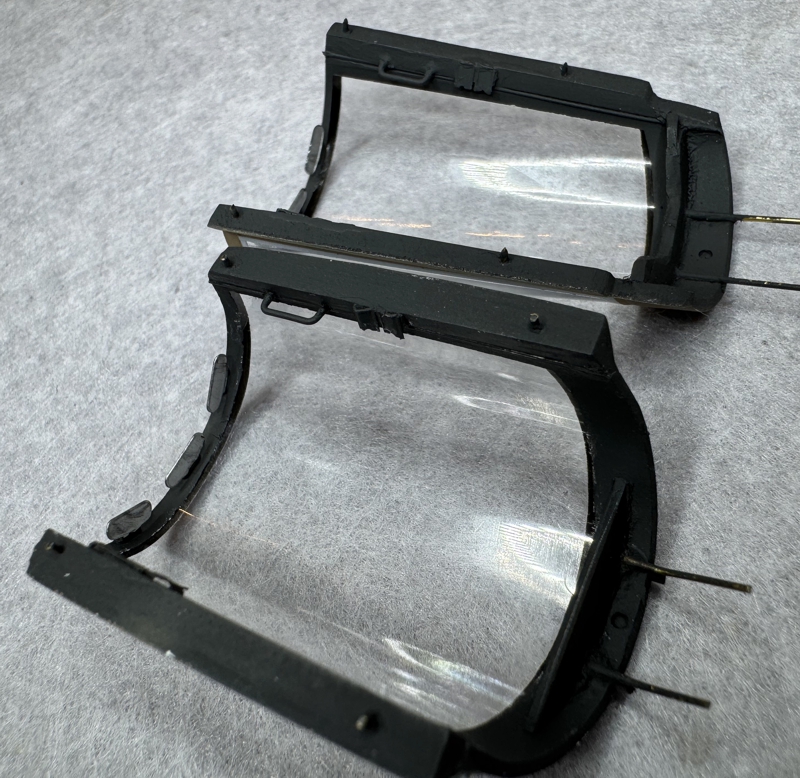

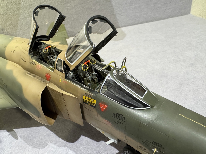

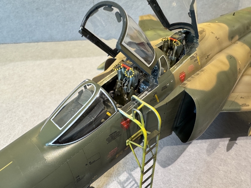

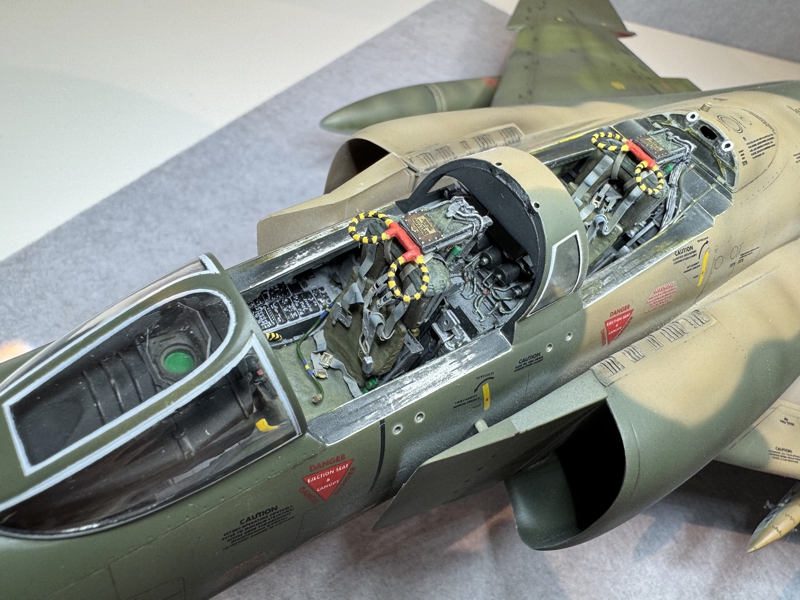

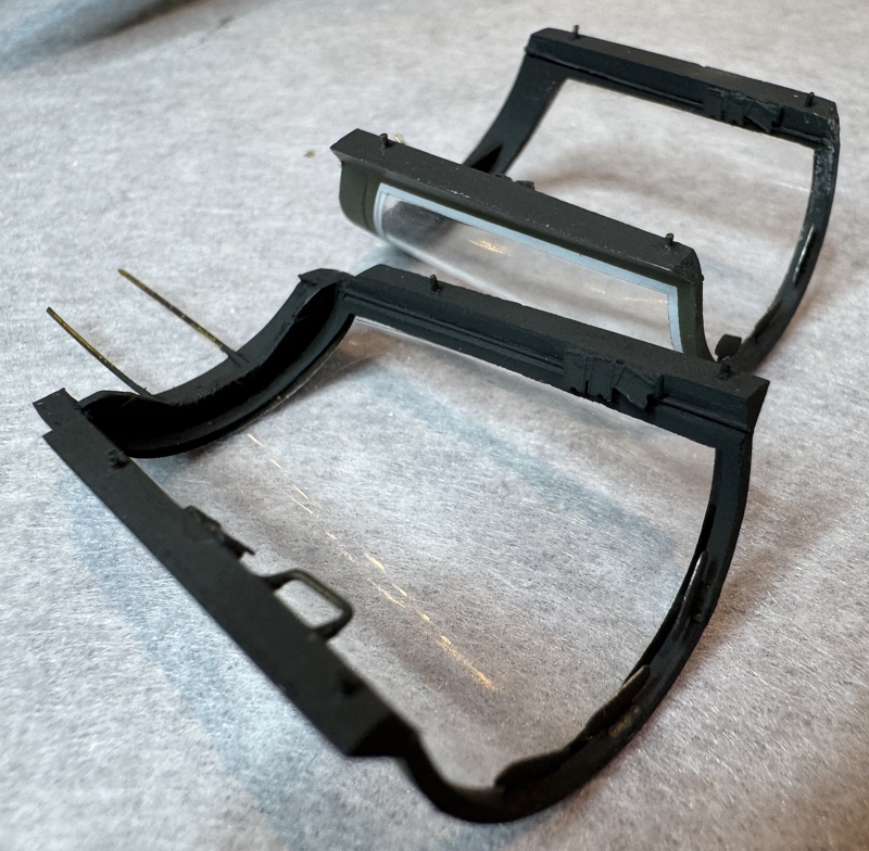

I scratch-built details inside the canopy frames with styrene quarter-round sanded flat on the base, thin flat sheet for the bulkheads and B guitar string for the handles. There are some folded metal holders for the mission cards on each of the right-side frames, too. I used thin Aluminum over styrene for the cockpit sills so I could weather them back to metal in places, and the seat oxygen hoses are cut from D string EB Super Slinky.
Here is a photo of the office, with the aluminum tubes that accept the brass pins of the canopies.

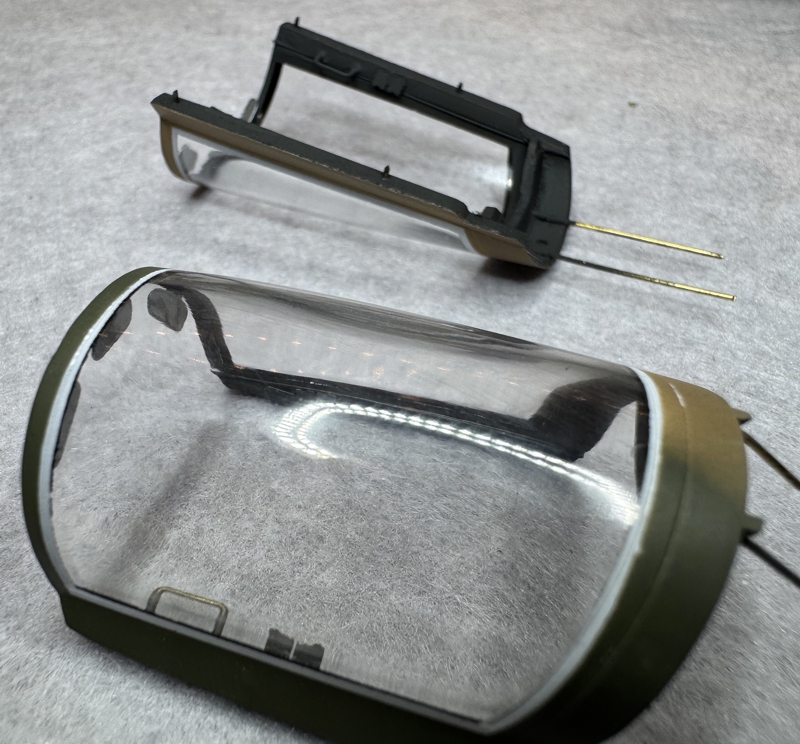

Here are the detailed canopies, painted in Tamiya Nato Black XF69.
I also cut and dropped the ailerons, opened the engine cooling doors and ordered all the usual suspects from Reskit and Aires.
