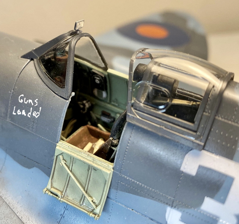

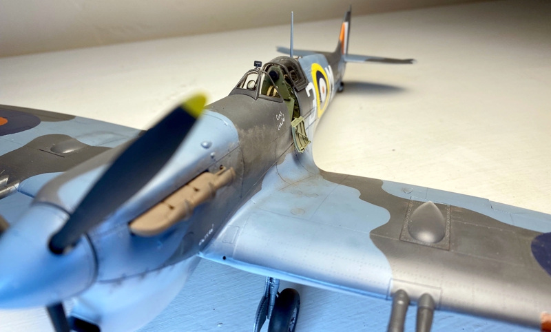

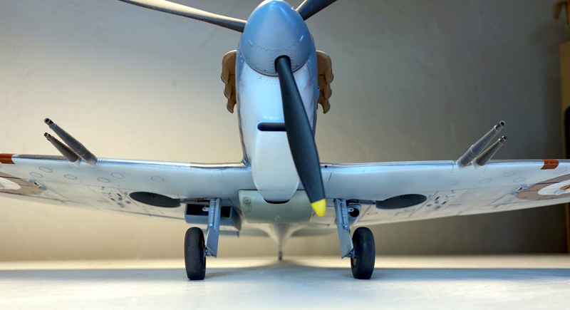

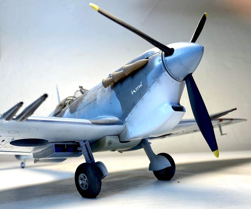

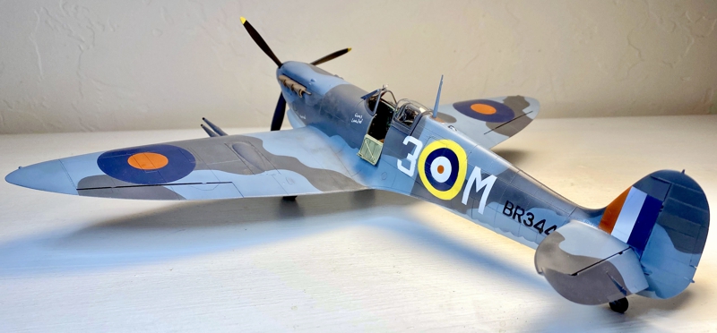

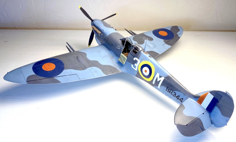

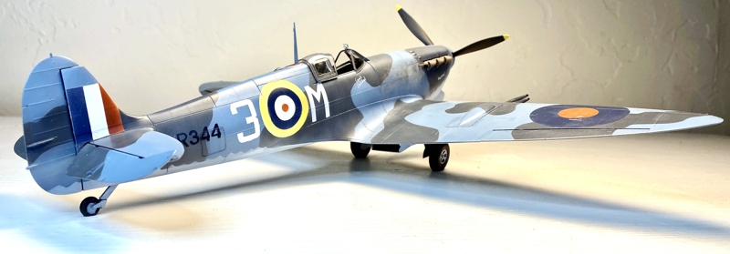

Here is my Malta Spitfire Vc.

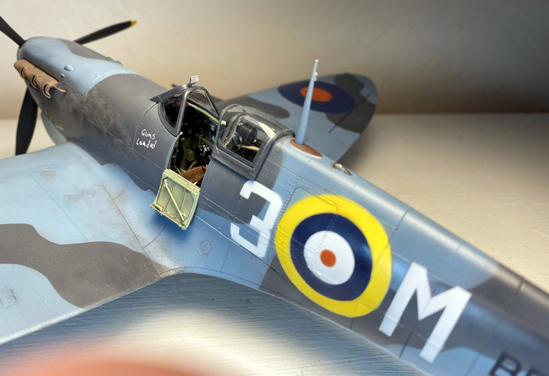

This was one of the most involved conversions I've done: taking the Laminar Flow Design Vc conversion, adding it to the Kotare Models Va fuselage, blending that with the Tamiya IXc wings and landing gear. You might be asking why: the Kotare fuselage has the raised rivets already, and the fit to both the conversion and the Tamiya kit is almost flawless. I just needed to sand the floor of the Kotare cockpit so the wing would fit.
I painted all the markings and scratchbuilt the crowbar for the pilot's door.
