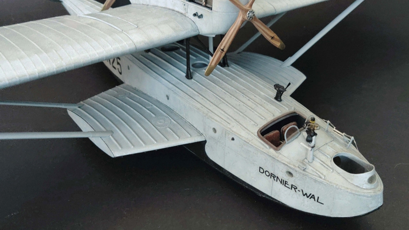

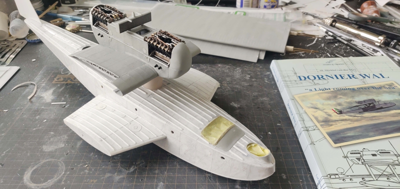

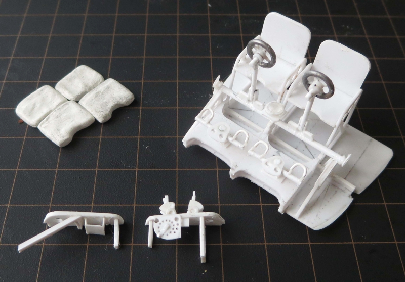

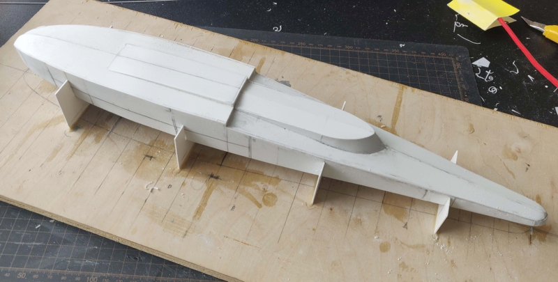

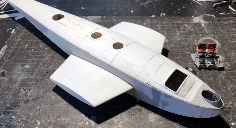

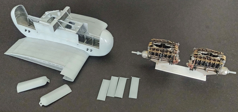

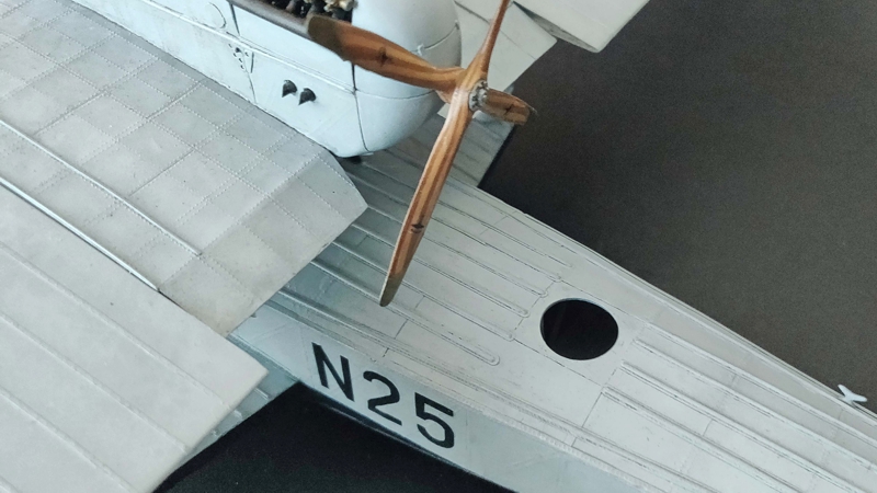

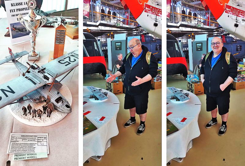

The 'Wal' is one of the aircraft which has always been a special plane for me. In 2015 I bought a book by M. Michiel van der Mey, “Dornier Wal - a light coming over The Sea" with plans of the aircraft. And right away I started working on the basis for the fuselage. But as it always is with these kinds of projects, it came to a standstill.

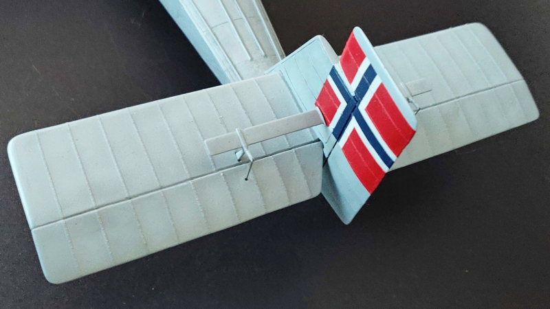

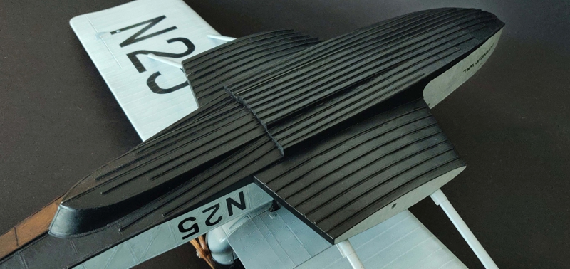

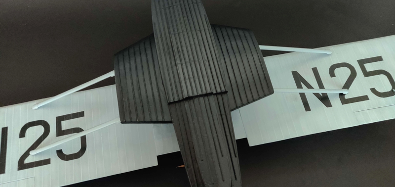

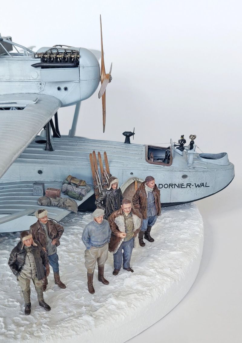

Over the years I never abandoned the thought of the build and years later I managed to get the wings done, because I didn't want to proceed if the wings didn't work out. I was very lucky when in 2021 the Dornier Museum in Friedrichshafen completed a 1:1 Replica of 'N25'. I do not think that I would have been able to finish the model if it wasn't for the photos of the Replica in the Museum. The last 3-4 months of 2023 I've been working continuously because of the deadline I had made for myself, the 100-year anniversary of the Polar flight by Amundsen & Ellsworth in May-June 1925.

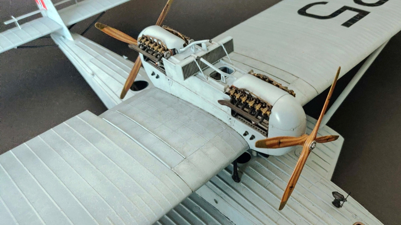

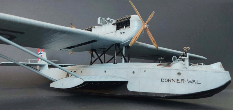

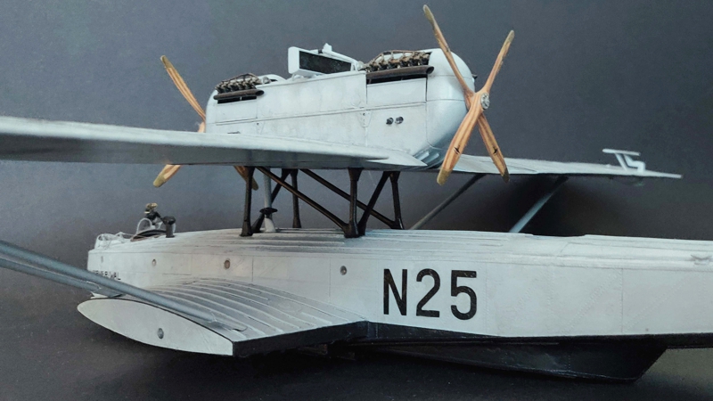

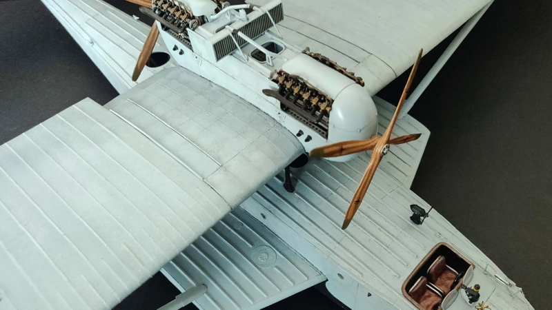

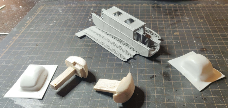

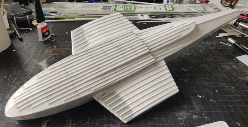

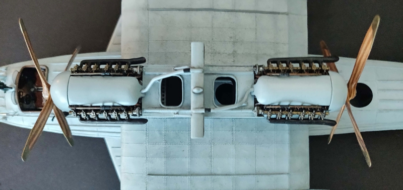

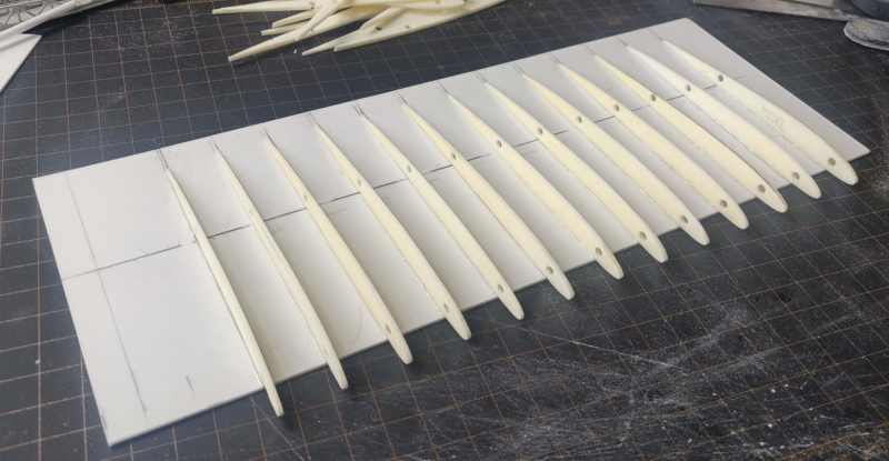

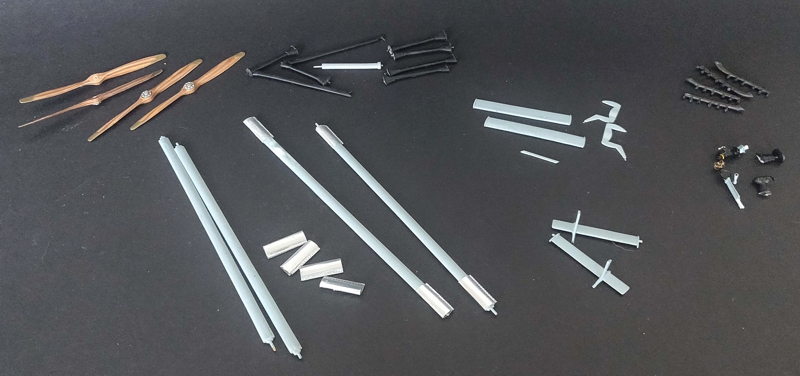

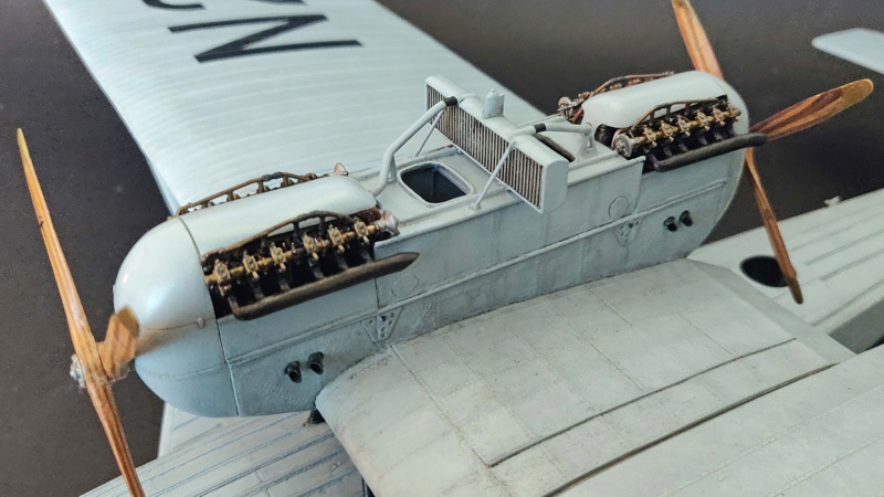

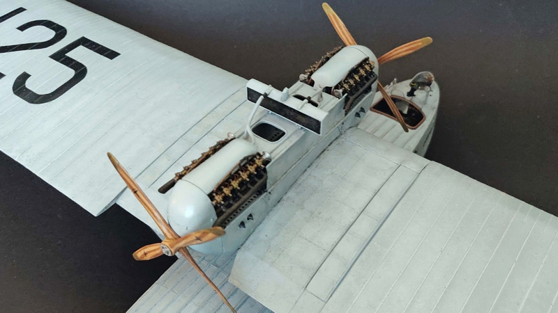

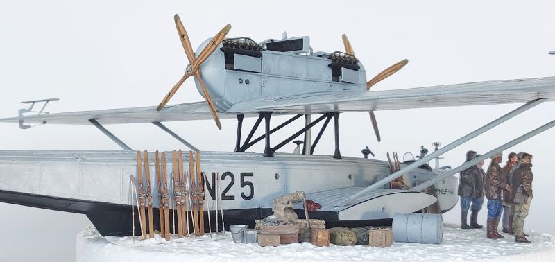

All of the parts are made by hand except for the Wingnut Wing Rolls-Royce Eagle engines left over from the Aeromarine build. But it has been a 'tour de force' of different methods of making parts for 'N25' - Styrene sheets and profiles, vacuum forming, making masters and casting copies in resin, working with aluminum sheets, reinforcing parts with brass rods, etc.

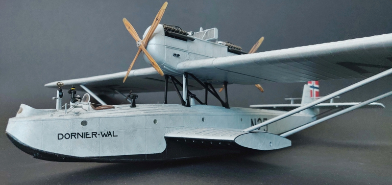

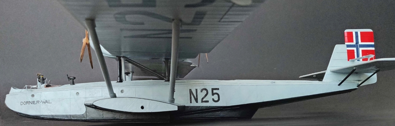

The Dornier Do Wal wasn't a small plane, the model has a wingspan of nearly 69 cm's and a length of 54 cm's.
