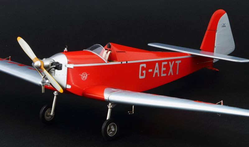

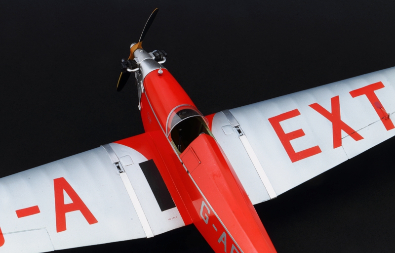

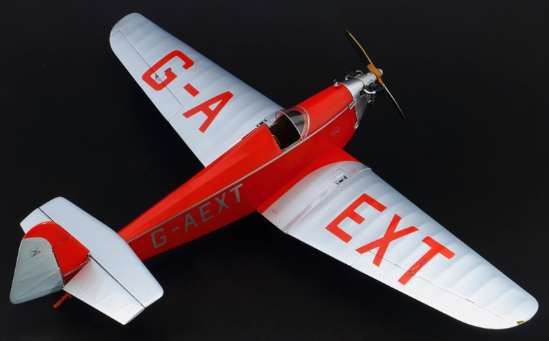

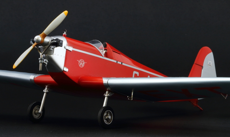

I'm finally calling the scratch-built Dart Kitten model I've been building for one of my old flying friends complete.
After 10 years (yes, really), and a few challenges, she's now done - I've been re-doing the windshield today, along with a new tail skid reinforced with fine stainless steel rod.
I can finally deliver it now and crack on with some other projects. Scale is 1:32 - just under 12"/30cm wingspan.
It is part 'traditional' sheet styrene, with balsa core for the wings, and part CAD designed and 3D printed (engine, undercarriage, cockpit, etc...). Here is my build thread.
I'm usually a little disappointed with my finished models - we start with an image in our minds-eye of how you want it to look, and the end result often doesn't match that.
In this case it's pretty close to what I wanted to create - something that captures the look of the original and construction techniques of the period.
