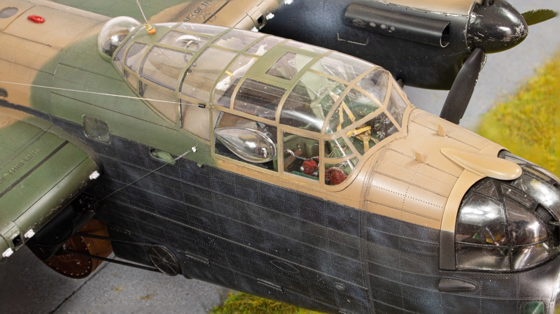

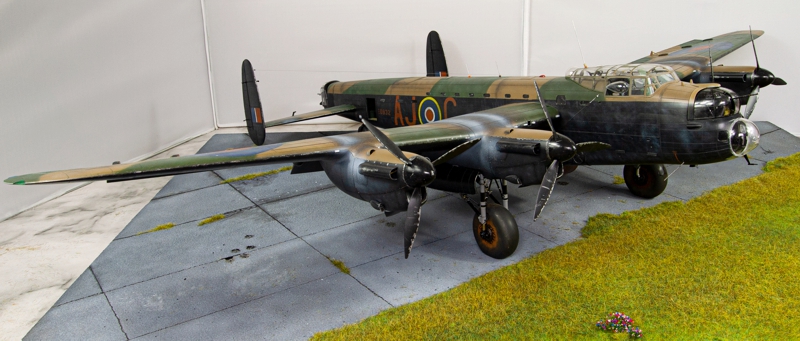

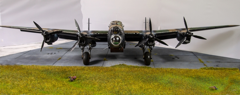

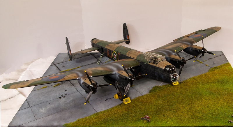

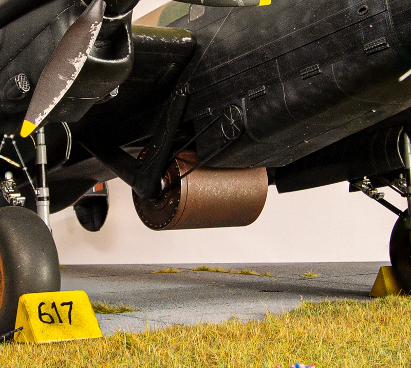

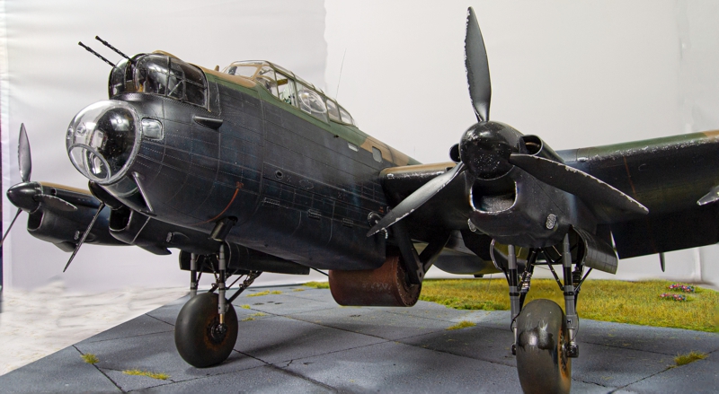

So here we have the final pics of my mammoth HK models 1:32 Lancaster Mk. B.I Special build.

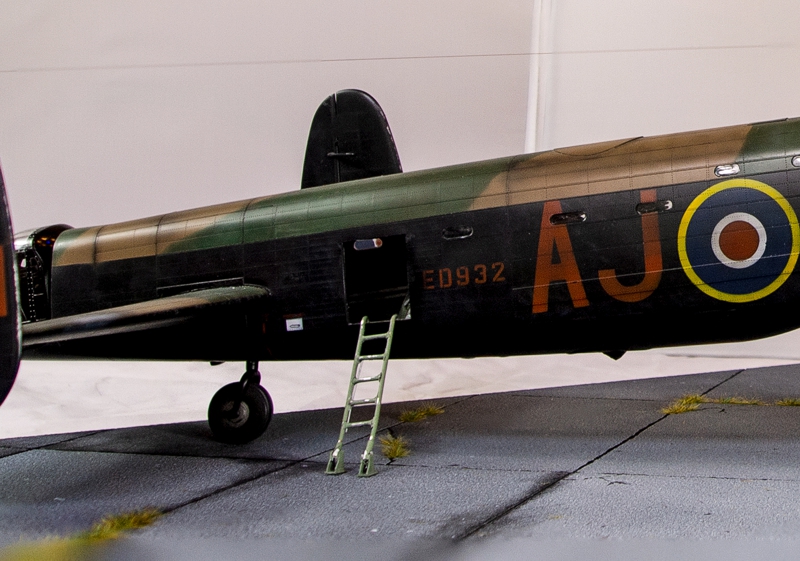

This is Guy Gibson's ED932 just prior to take off on Operation Chastise May 15-16th 1943. The finished aircraft looks spectacular from a sheer size perspective.

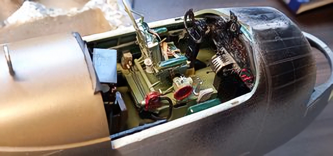

The inaccuracies for a kit costing over £300 are well documented and the fixes I've employed are far too numerous to list fully here. But a few have been:

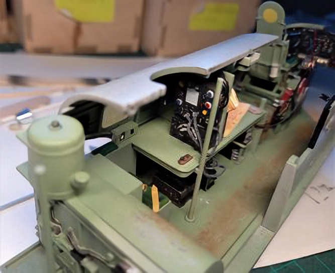

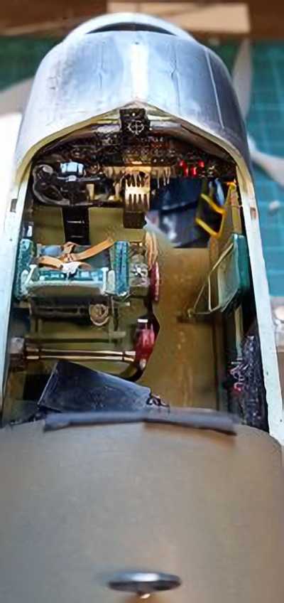

- Complete rebuild of pilot's plinth and replacement of seat
- Removal of erroneous dinghy hatch on port wing

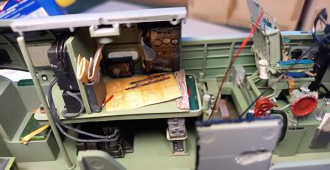

- Lengthening of Navigators table to match specs
- Addition of accurate instrumentation for a BI not the Mk. X
- Fit a B.I Flight Engineer's seat as opposed to a Mk. X
- Fit swivel navigator's seat as opposed to fixed one supplied
- Install "washing line" canvas sunscreens in canopy

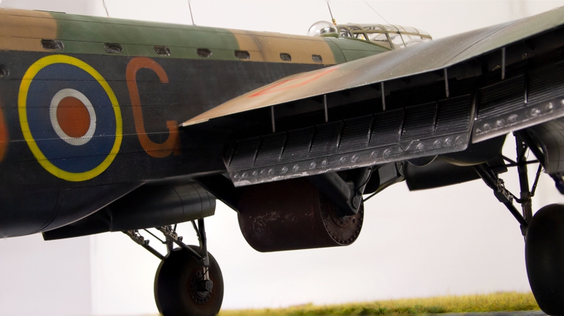

- Remove erroneous wooden slatting from upkeep mine
- Built and fit hydraulic submarine motor to spin up mine
- Move trailing radio aerial from starboard to port side

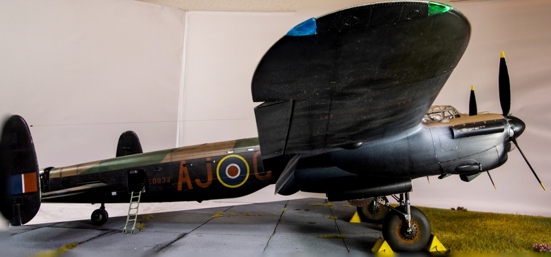

I've tried to take a few pics of the iconic shots from 1943 prior to the mission and I've included these as a bit of fun.
It's now on its way to a new owner, which is just as well as, with a 1m wingspan, the wife would kill me if I said I was keeping it.
