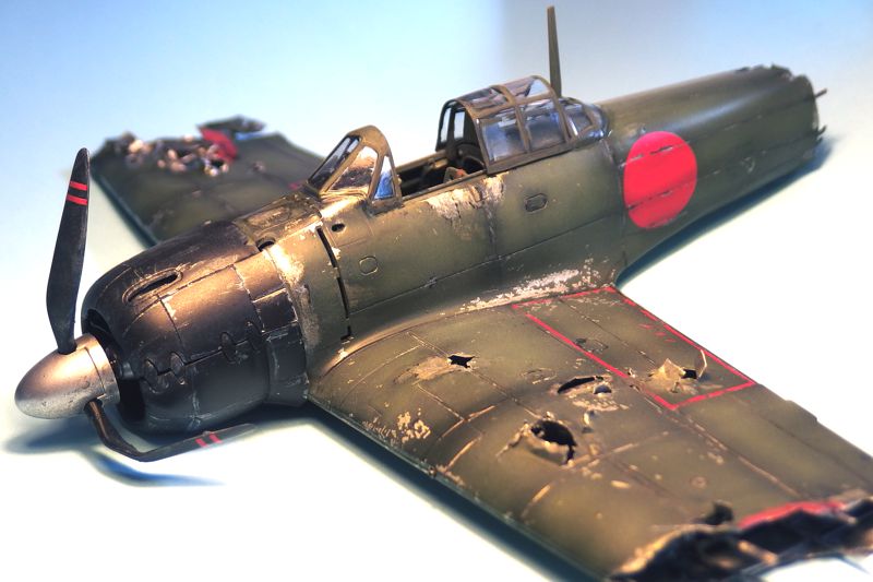

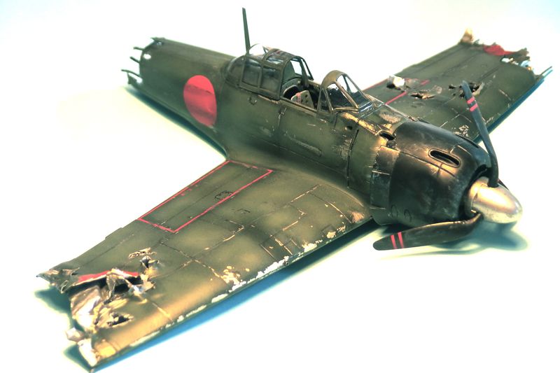

Here is 21st Century's 1/32 A6M3 Zero which I built (and wrecked) for a diorama.
To portray the damage, I cut up the wings and fuselage with a Dremel tool, then thinned the inner surfaces and punched holes through them with metal instruments. Crumpled lead foil was glued on to replicate torn metal.
A silver enamel undercoat was applied, then a Tamiya acrylic topcoat. Chipping was done using masking tape to lift the acrylic coat off the undercoat.
The finished diorama shows this failed kamikaze attempt.
