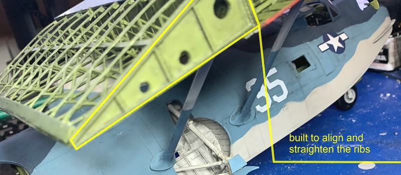

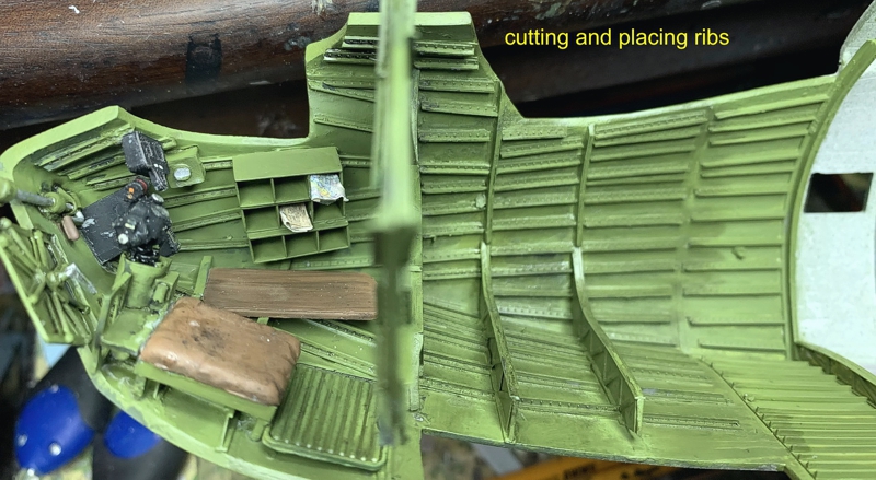

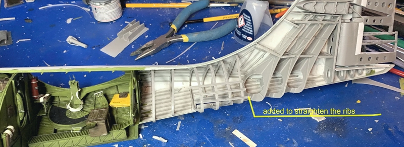

However, I managed to deal with it. I had to build few pieces of reinforcement to straighten and keep in place the fragile parts, too.
