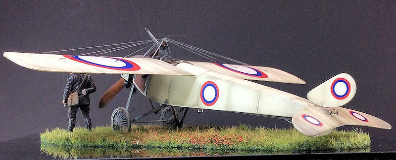

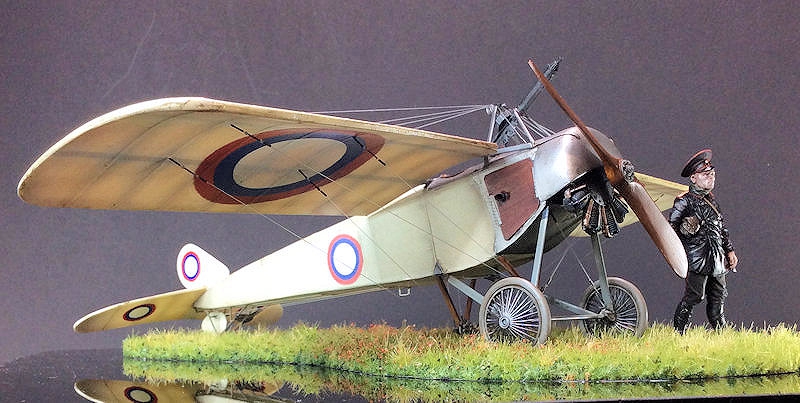

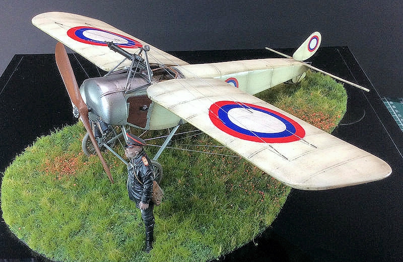

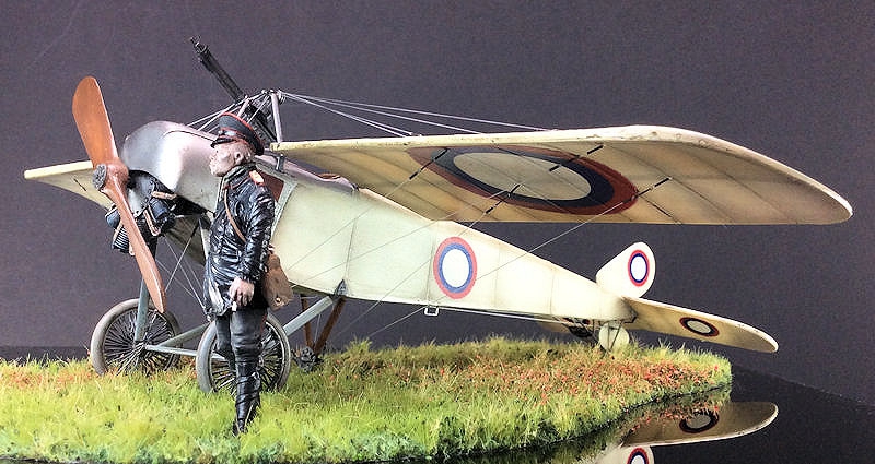

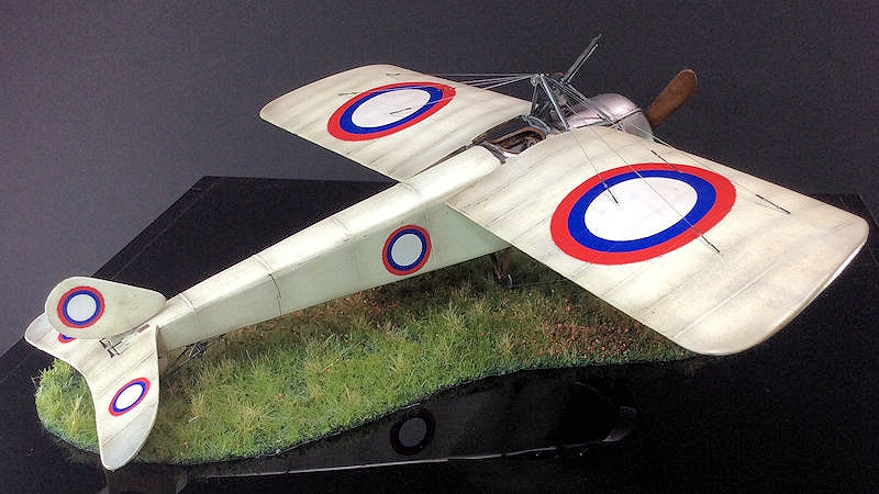

Here is my build of a Mosca-Bystritsky MB bis fighter, flown by the Imperial Russian Air Force from 1916. The full build is in my Work in Progress build thread.
The basic 1:32nd scale kit is resin and made by ‘Omega Models’ (Kit No: 32-003).
The list of changes/additions to the model are:

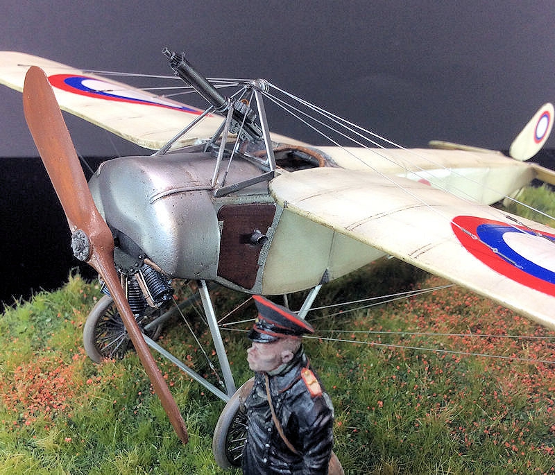

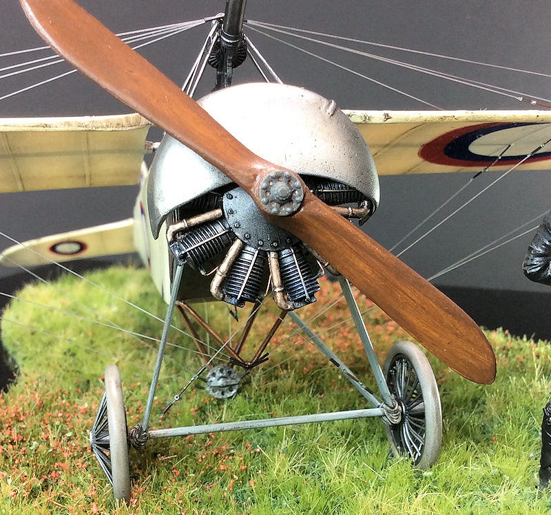

Engine:
Detailed with Nickel-Silver valve push rods, copper wire ignition leads and replacement induction manifolds.
Modified or corrected:

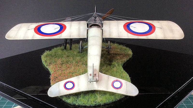

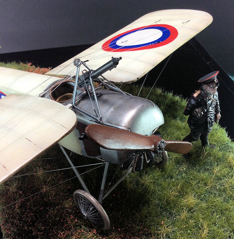

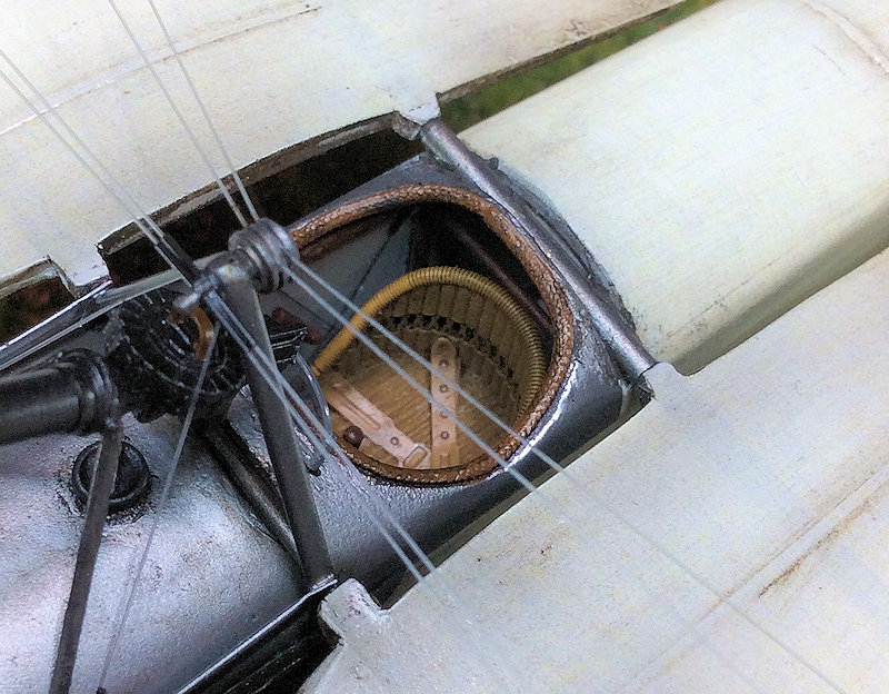

- All wing support, landing gear, tail skid and gun mount struts were replaced with handmade Brass tube struts with internal reinforcing Brass rod.
- Rigging is 0.08 mm or 0.12 mm diameter mono-filament with ‘GasPatch’ 1:48th scale turnbuckles and 0.5 mm or 0.4 mm diameter blackened Brass tube.

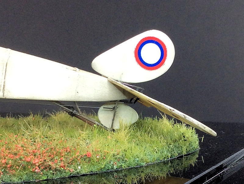

- Upper and lower rudders were replaced with scratch made rudders from plastic card.
Aftermarket:
- ‘GasPatch’ spoke wheels and tyres used to replace the resin kit parts.
- ‘GasPatch’ Lewis Mk.1 Standard type (stripped front) used to replace kit part.
- ‘BarracudaCast’ British wicker AGS seat used to replace the kit part.
- ‘Kellerkind Miniaturen’ Russian pilot 1914-17.
- ‘Jadar’ WW1 1:48th scale control horns.
Decals:
- ‘Aviattic’ Clear Doped Linen (CDL) bleached (ATT32044).
- ‘Aviattic’ Walnut woodgrain (dark and light) (ATT32060).

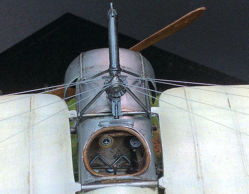

- ‘Airscale’ WW1 Generic instrument dials (AS32 WW1).
The kit decals were replaced with corrected markings, printed from an Inkjet printer and on white decal paper.
