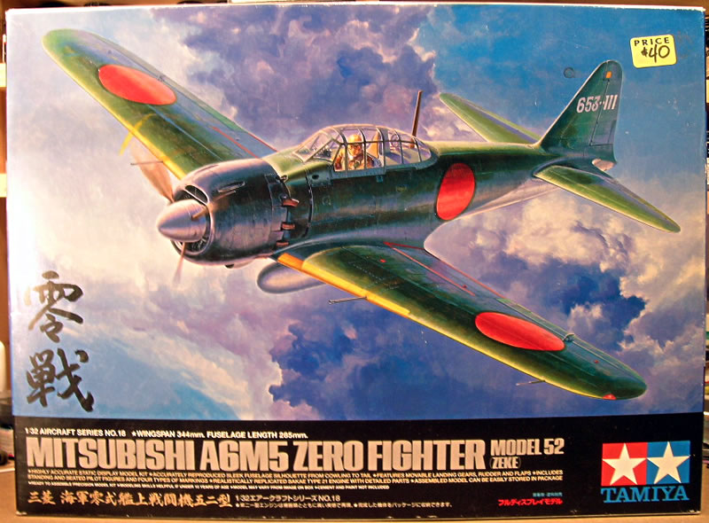

Tamiya 1/32 A6M5 Zero Tweak List
By Ryan Toews
![](/articles/images/3332/3332-1.jpg)
Notes on the 1/32nd Tamiya A6M5
24 March 2019
Ryan Toews
The Tamiya A6M5 has rightfully garnered praise for the high degree of quality that it exhibits. Alas, it is not perfect, and so the following is a list of some of the details that could be added or changed in order to improve the kit.
In the following the headings refer to the sub-sections in the Tamiya kit instructions.
