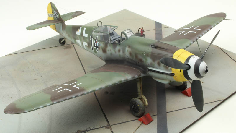

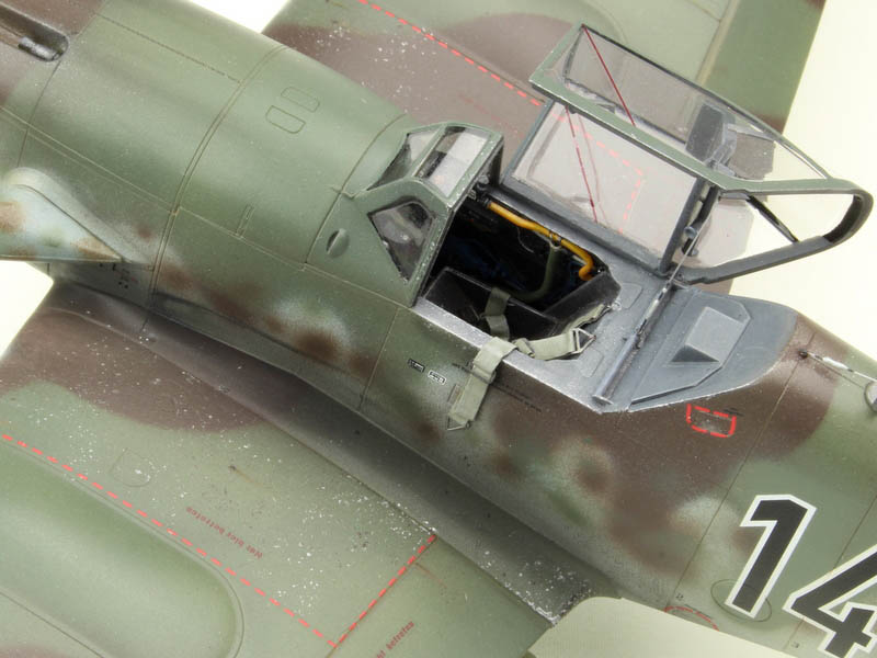

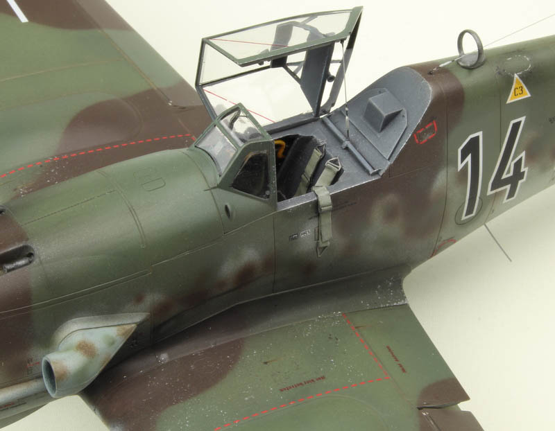

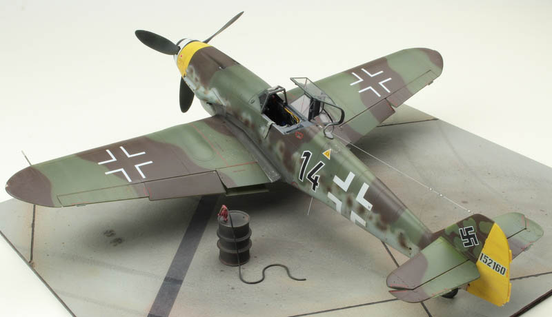

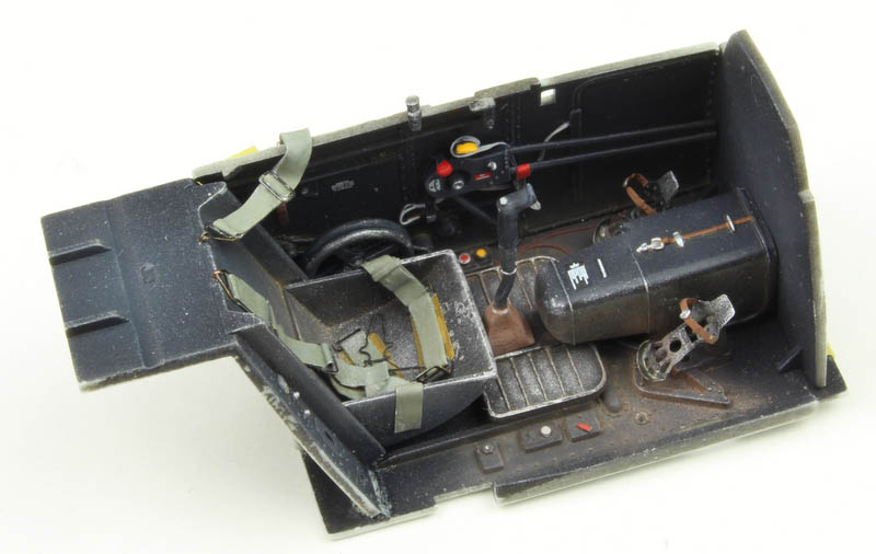

This is a very nice kit from Revell and I built it almost straight from the box. The fit and the details are superb and I only had to add some detail to the cockpit and the landing gear. The safety harness was made from a thin sheet of lead.
I used the decals of the kit together with some decals from my spares.

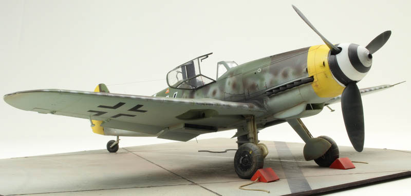

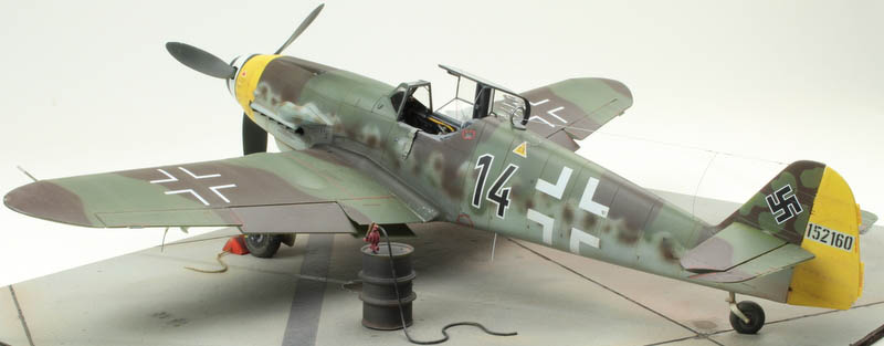

For this presentation, I made a very simple concrete basis and added some wheel chocks and a fuel barrel.
Accessories
The buckles of the safety harness, the wheel chocks and the fuel barrel came from the spare box.
Painting

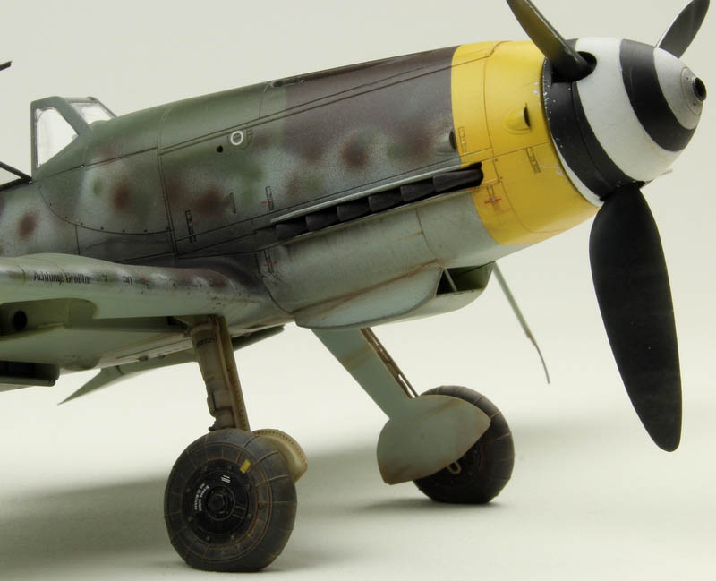

Painting was done with MRP and Model Masters paints and the weathering, as always, was worked out with pastels powders.
