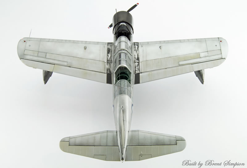

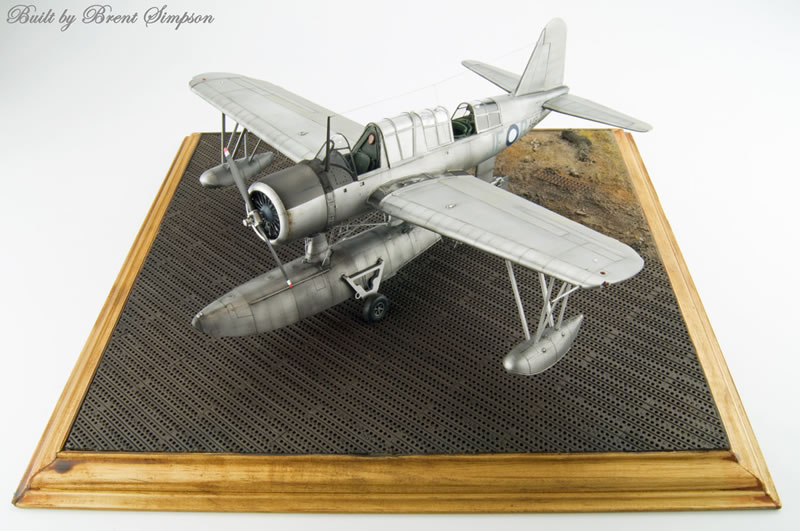

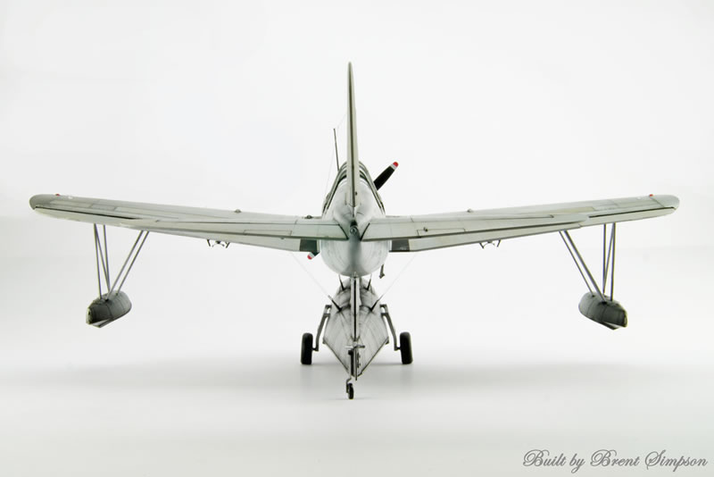

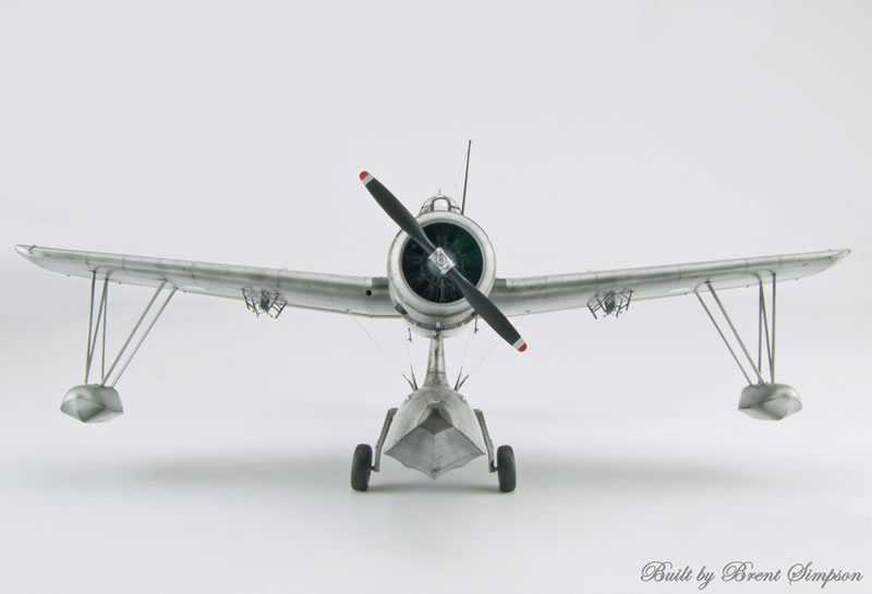

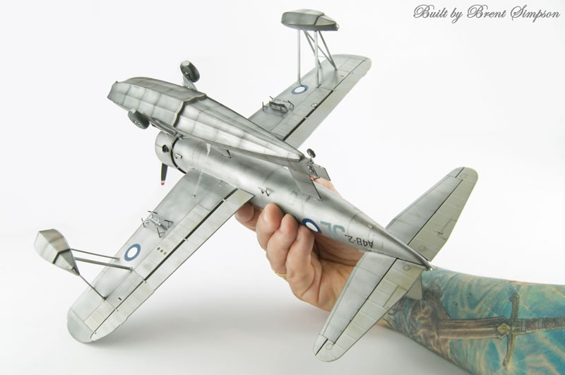

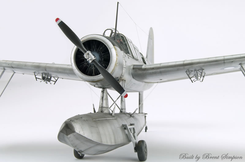

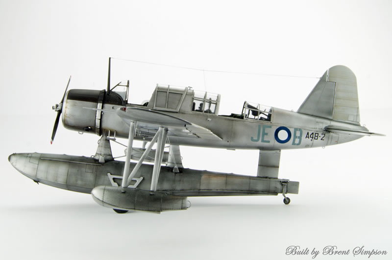

This is my completed Kitty Hawk Model Kingfisher.
Modifications and enhancements:
- Engine wired
- Ignition ring scratchbuilt due to the kit part being destroyed when removing it from the sprue (a common problem)
- Center of the front windscreen removed and replaced with some clear plastic to fill in the gunsight hole
- Ring and bead sight added
- Scratchbuilt sway braces for the bomb racks (RAAF mod)
- Water rudder linkage scratchbuilt (RAAF mod)
- Extra strake added to float (RAAF mod)
- Scratchbuilt Pitot tube
Paint and finish:
- Fabric areas painted with Tamiya AS-12
- NMF applied with Alcad and AK interactive combination
- Ronin Decals
© Brent Simpson 2017
