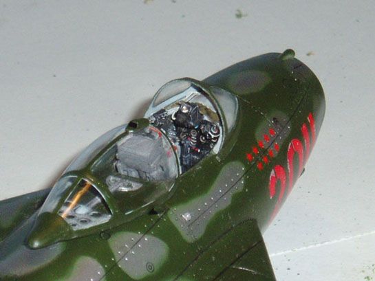

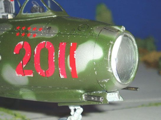

This kit is the Hobbycraft copy of the Trumpeter MiG-17 kit in 1/32nd scale. I basically worked on it for two years, on and off, before completing it. The kit required A LOT of tender loving care, with many inaccuracies needing to be corrected. Once completed, however, it makes an impressive model that will look great next to my new F-105! Some of the items that were scratch built included:

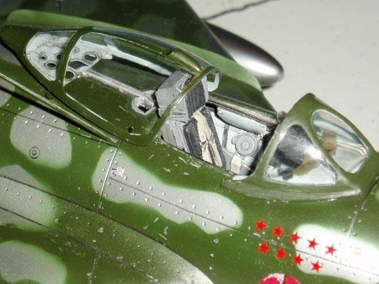

- ejection seat head rest (I adapted a MiG-15 seat, the Cutting Edge seat was unavailable at that time)
- ventral strake was added
- tail warning radar and position light were added
- pitot tubes were fabricated from pins and brass tube
- canopy rear view mirror
- cannon barrels made from brass and aluminum tube
- landing light using a MV lense and Eduard photo etch
- trim tabs
- flare launcher
- drop tank pylons
- position lights on the wing tips
Additionally, a number of aftermarket products were used in construction of the kit. Do not attempt to build this kit without the Eduard photo etch set (#32-051) or the Squadron crystal clear canopy (for the MiG-15). These sets replace some of the components that were pretty sad. Other aftermarket items included:
- various decals from Eagle Strike's Fresco collection #32019 and Trumpeter BORT numbers
- Cutting Edge intake splitter (this is also HEAVY…keeps the kit from being a tail sitter, but fill in the landing light) #32052
- Cutting Edge wheels #32036
- Cutting Edge cockpit set #32101 (this is the actual MiG-17 set with the KK-2 seat).
PROBLEM AREAS
Some of the panel lines on the right side of the tail were wrong, these were filled and re-scribed. The engine is a VK-1 from an early MiG-17A or a MiG-15. The VK-1F from the MiG-17F has an afterburner that swells the combustion chamber noticeably, so I didn't use the engine. Additionally, the engine exhaust nozzle is incorrect. I used the Eduard set to make a new one which was secured to a length of brass tube and inserted into the fuselage. The main wheel wells are too shallow and are incorrect…the Eduard set came to the rescue again. The location holes for the drop tanks are grossly out of position to the outboard and are splayed out (pigeon toed). They were relocated approximately in line with the center wing fences. The radio antennae on the right side of the fuselage is in the wrong place….a new locating hole was drilled. The wing fences are way too thick, they were sanded down. The airbrake hydraulic actuators attach to the fuselage in the wrong place. New holes were drilled.
