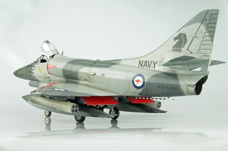

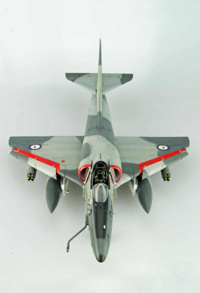

Here is my newly completed Skyhawk of the Royal Australian Navy, 1982.
I built this model as a tribute to my good mate Bruce Chapman who passed away recently. He was a big fan of the Skyhawk and was always talking about how he would have approached the construction of this kit. I have incorporated most of the mods that he suggested (plus a few more!).

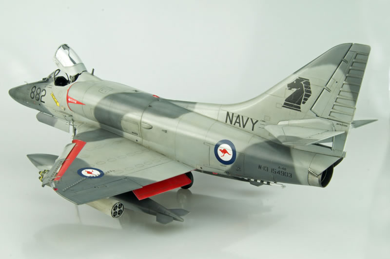

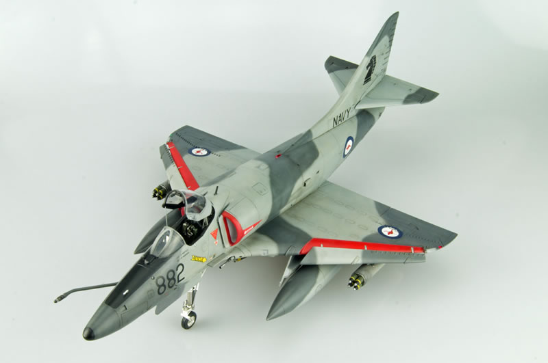

The Kit
Additions:

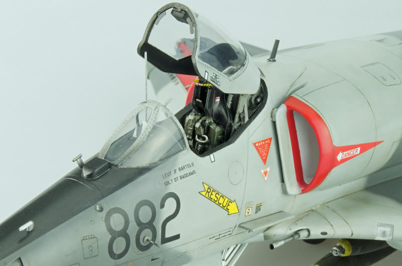

- AMS resin Seat, intakes and wheels

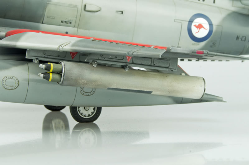

- Fisher Zuni rocket pods
- Academy MK-82 bombs
- Aires cockpit and wheel wells

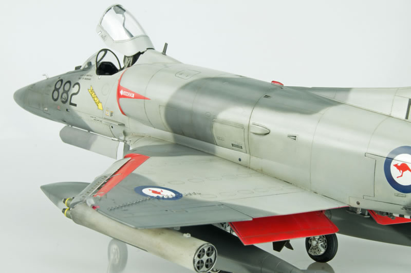

Modifications:

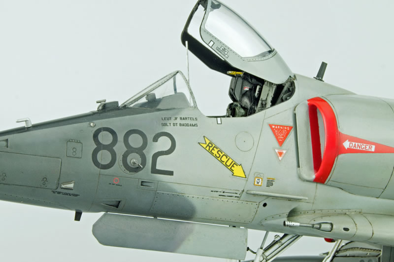

- Scratchbuilt re-fuelling probe
- Modified pylons

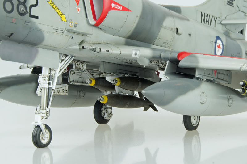

- Shortened main undercarriage by approx 4 mm
- Scratchbuilt launch cable hooks
- Various vent pipes added with microtubing
- Wiring conduit added to the nose gear
- Brake lines and wiring added to the main undercarriage
- horizontal stabilizers re-positioned along with the hole between them cut
- various sight gauges added to the fuselage
- All vortex generators thinned
Finish:
- Custom mixes of Gunze Sangyo colours
- Self made masks for serials, nose numbers and roundels
- ALPS printed pilot's names
