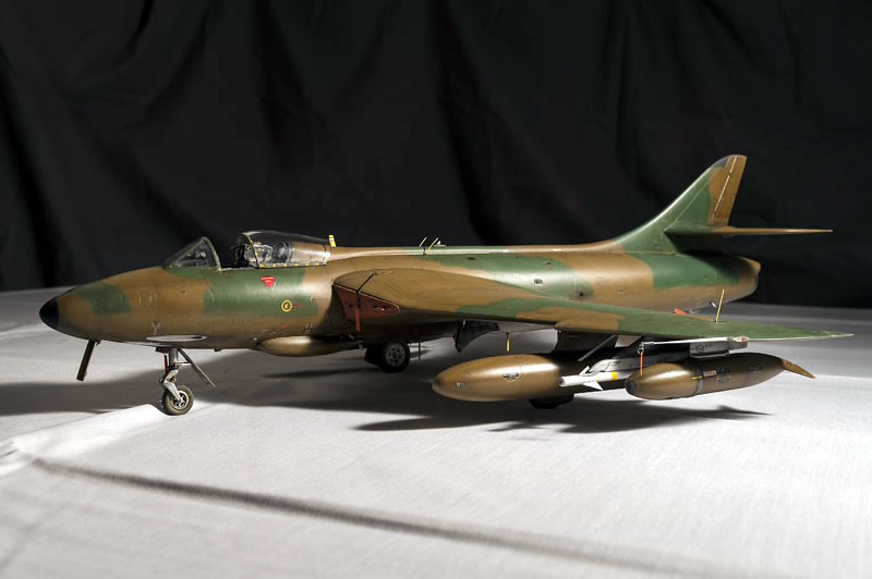

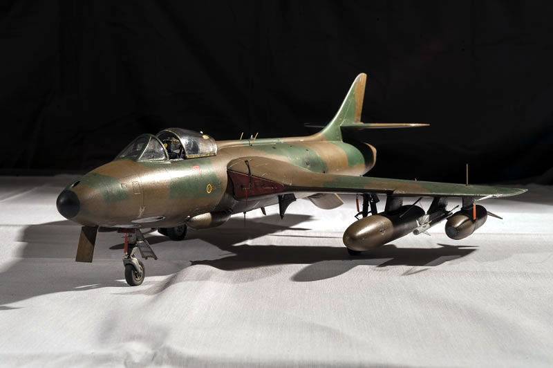

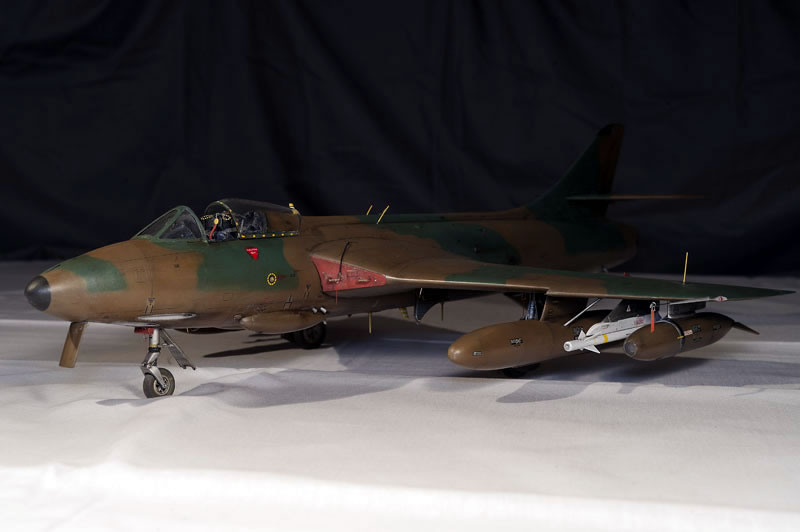

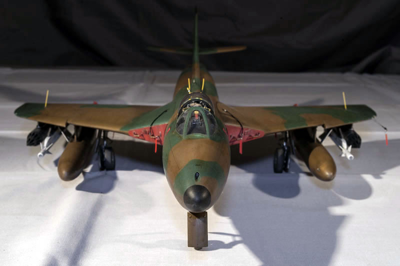

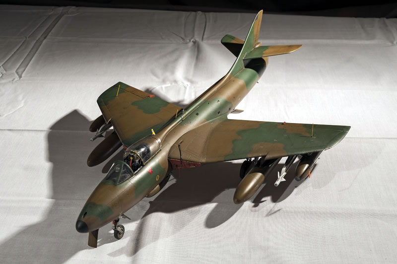

I wasn’t sure if I could pull off the camera pod so from the outset I made the pylons so that I could swap around the ordnance – So first with the SNEB Pods:

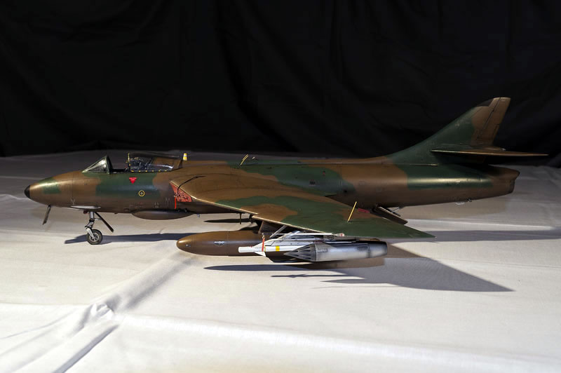

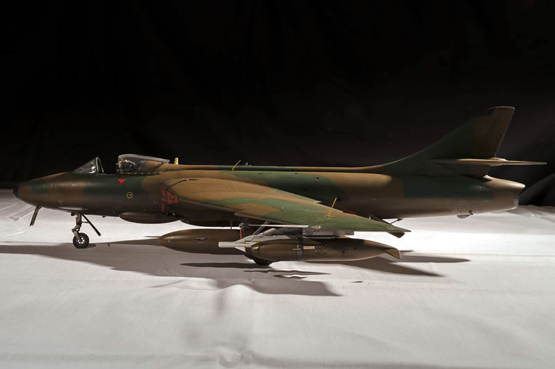

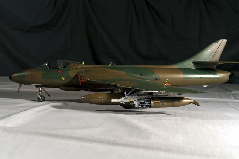

Then swapped out for the small wing tank and camera pod:
Now with the cover of the cameras:

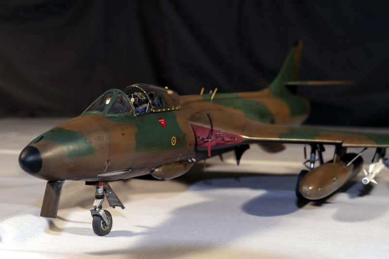

Did a lot of work in the wheel wells - Flighpath and scratch-built:

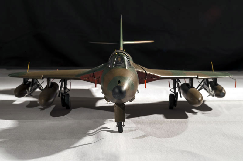

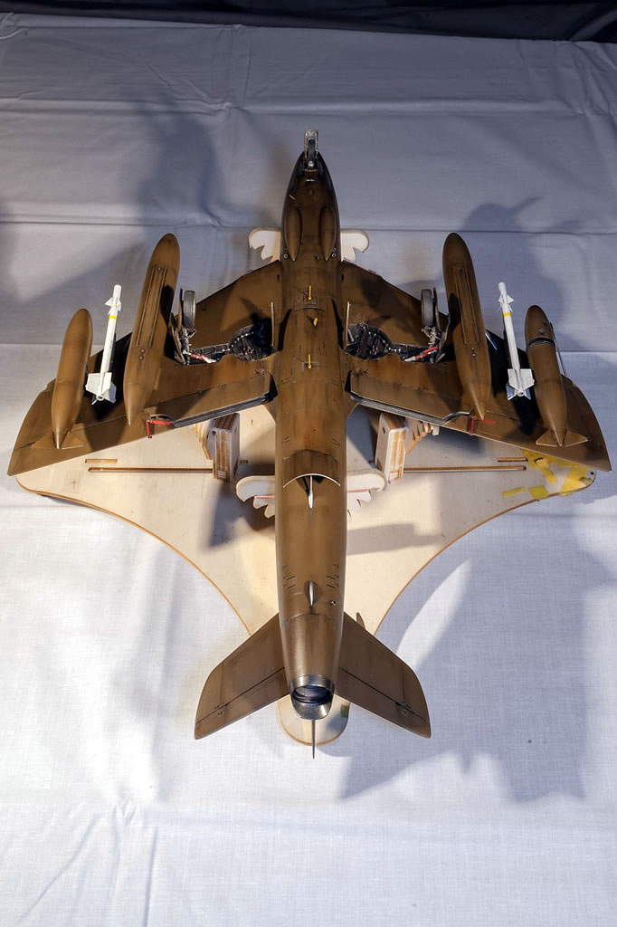

A shot of all the bottom bits:

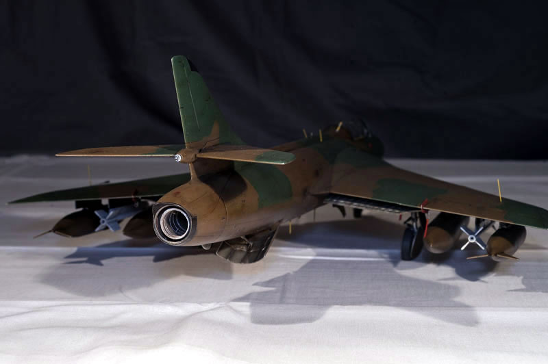

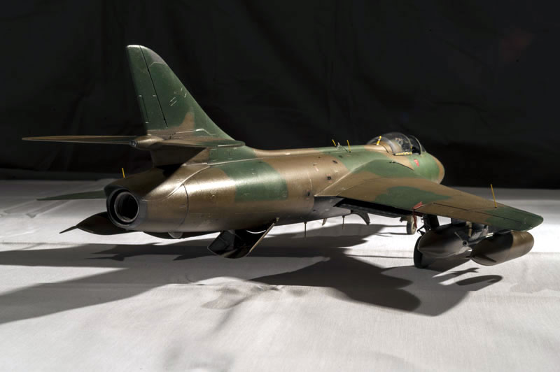

The Flightpath jet pipe:

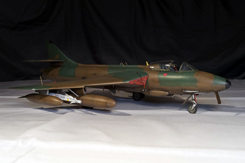

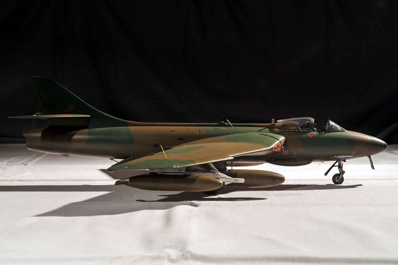

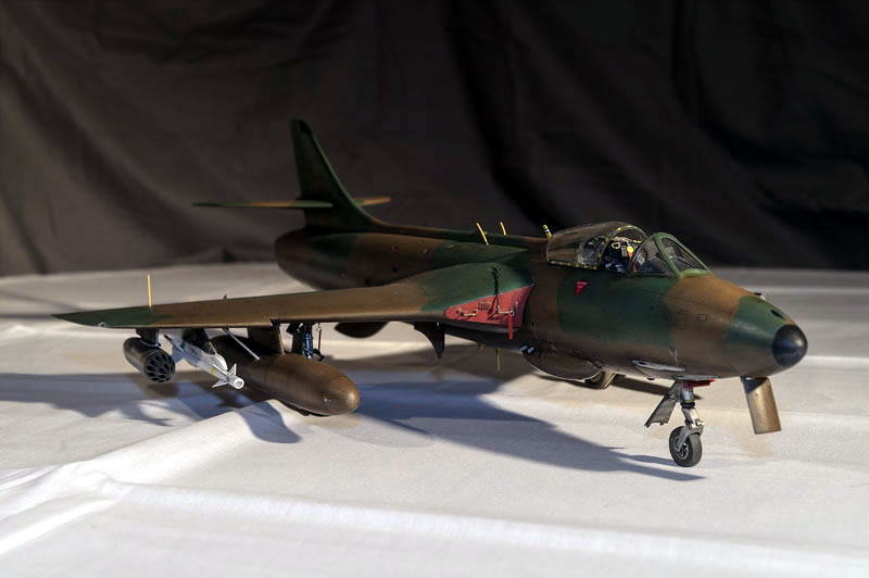

Some walk around pictures:
