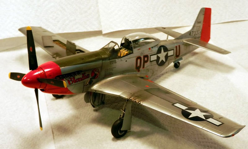

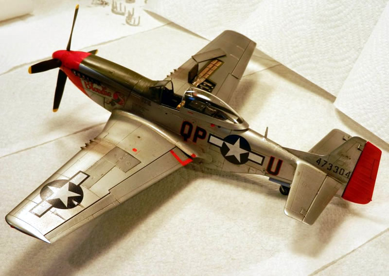

I had alclad problems with this plane, so I'm moving on with some good lessons learned, and a heavily weathered finish on "Blondie" to make up for the Alclad problems!

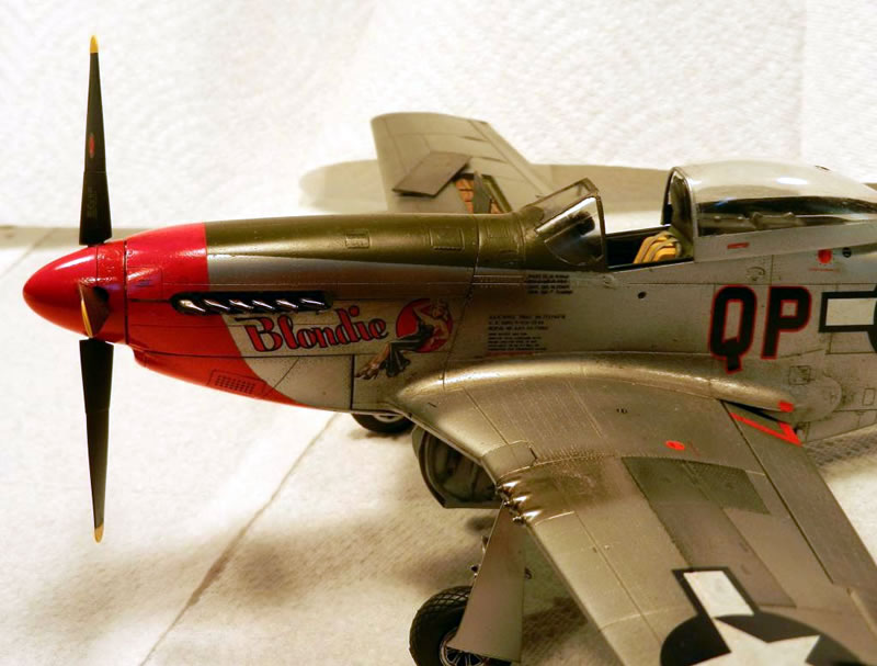

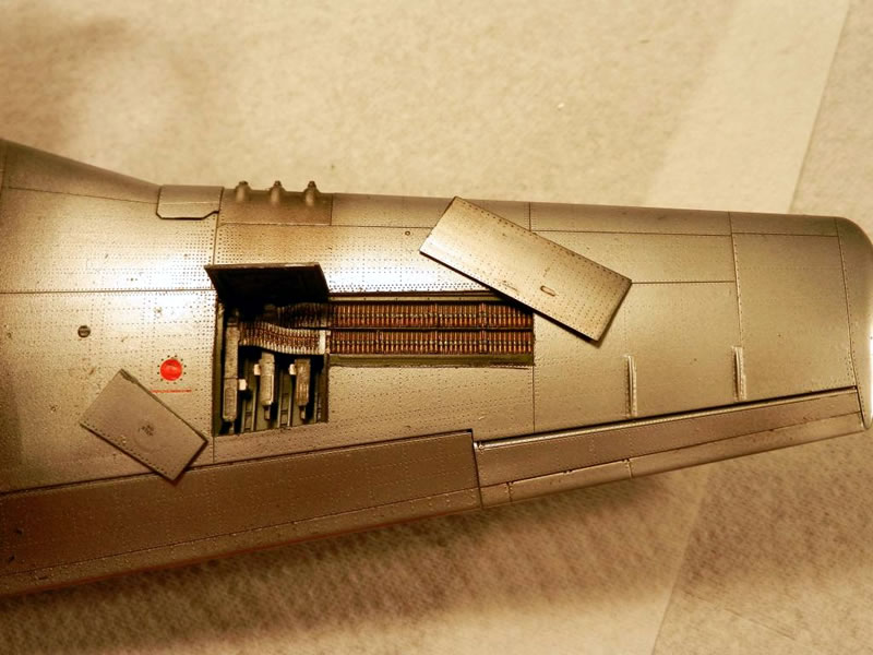

- My finish turned out to have a muted sheen and a grainy finish. I think I was doing several things wrong:
- Either I was spraying too far away from the surface, or my air pressure was too high...or both. I think that was the cause of the grainy finish.
- With Alclad, less is more. I think I put way too much on the model to the point where the gloss black couldn't help with the reflectivity and the sheen. I think that's the ticket is probably to apply enough Alclad until you think you are just short of an ideal amount and then stop. That's probably the right amount of Alclad to apply.

- With a grainy finish, heavy weathering was just the thing to make the grainy finish look "right". I put on a wash after the Alclad was cured, and then sprayed with future to make up for the grain in the finish. Applied the decals using Micro Set and Micro Sol. Then put a wash on the decals so they would look consistent with the rest of the airplane. Finally, I airbrushed on the machine gun and engine exhaust stains with a heavily diluted solution of Tamiya Smoke. I haven't sealed the decals on yet, and I'm not sure if I'm going to.
