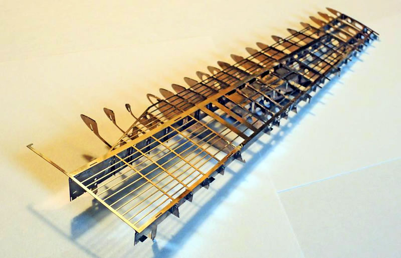

Personally, I loved mine every step of the way. You quickly get an appreciation for how exacting the engineering standards are in this kit when you see how parts must line up for the correct fit. And, don't ignore those cues...if you do, they will come back to bite you in the end. Luckily it's just PE and White metal so it can be taken apart easily with CA debonder, and cleaned for rework.

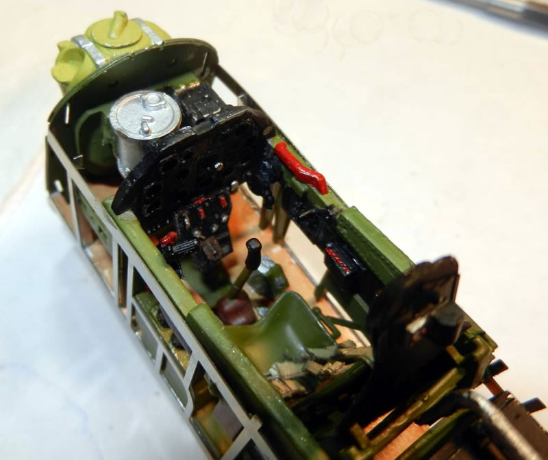

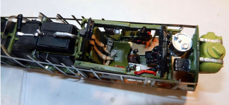

- I think most of you will be wanting to paint some of the internals like the cockpit and fuel tanks to make some of the detail "pop"... That's all well and good and I approve completely... But, save yourself some outrage and indignation here. Get yourself a good self-etching metal primer to use before your color coat. I recommend the Rustoleum or Krylon products since they are equally easy to use and give good results. Using a hobby primer on these metals will do nothing for you... Your only reward will be peeling paint.

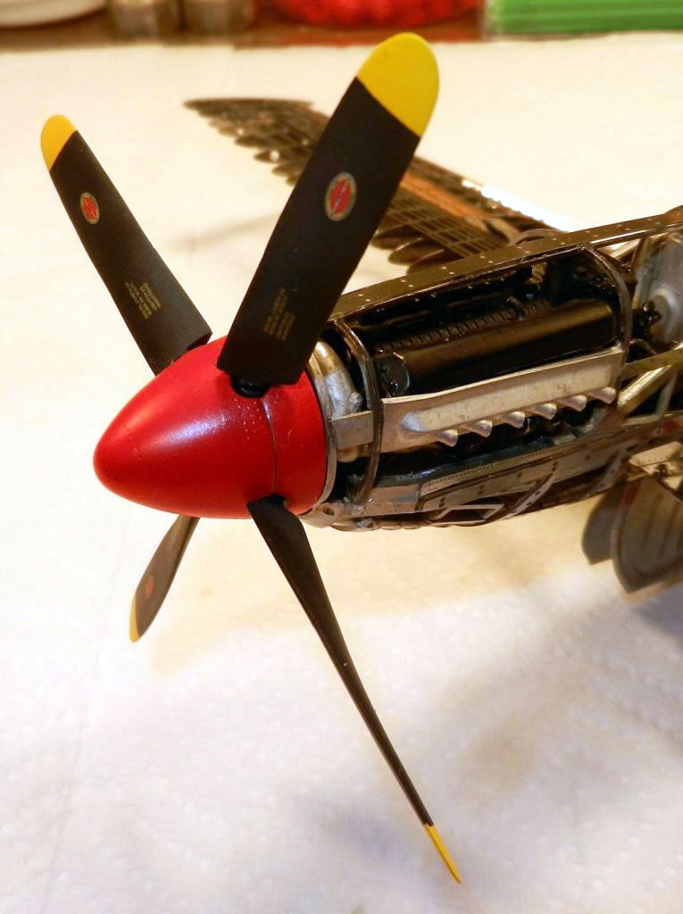

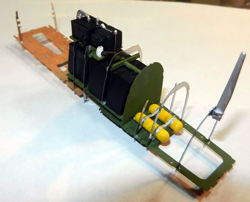

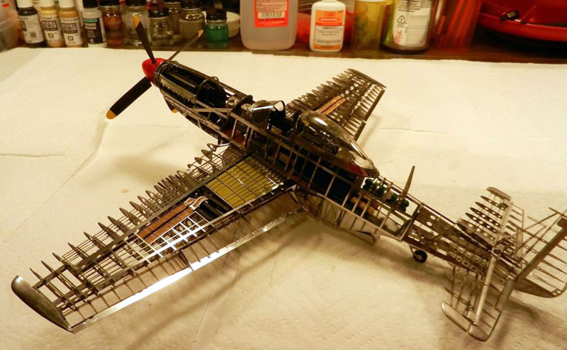

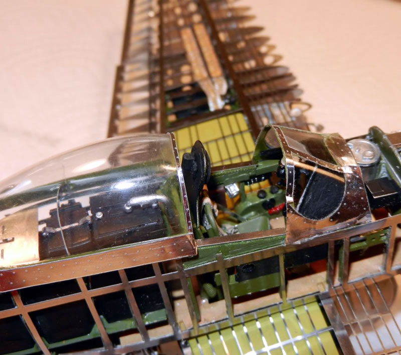

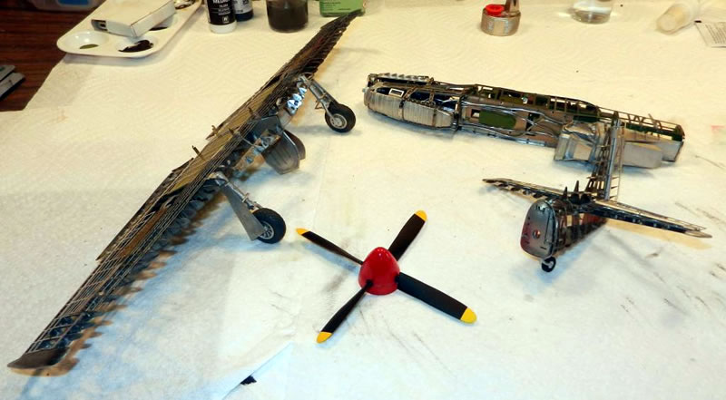

So, here are the photos of portions of the build and the final reveal.
