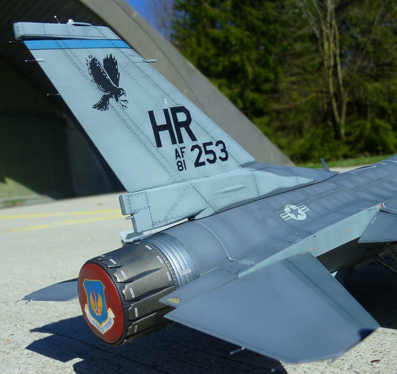

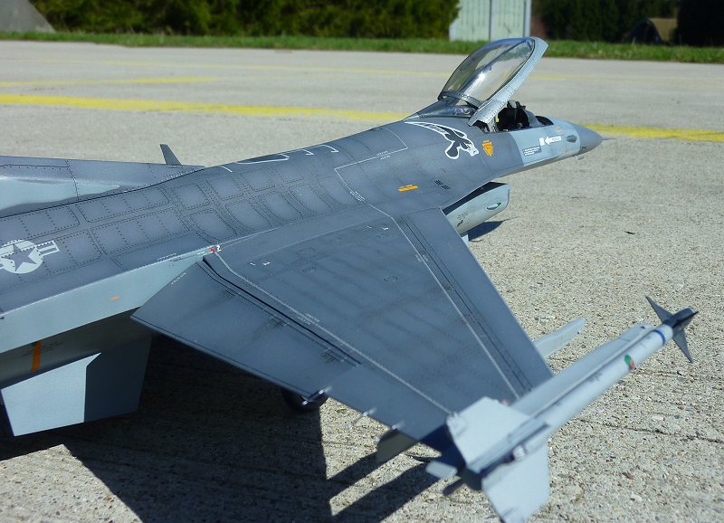

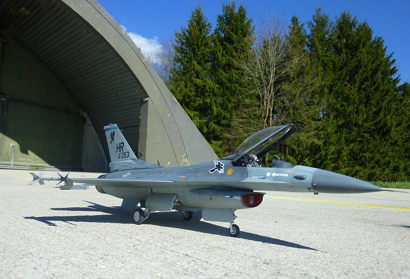

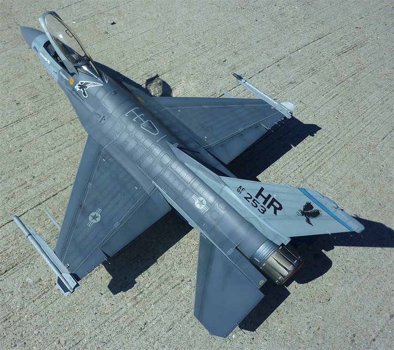

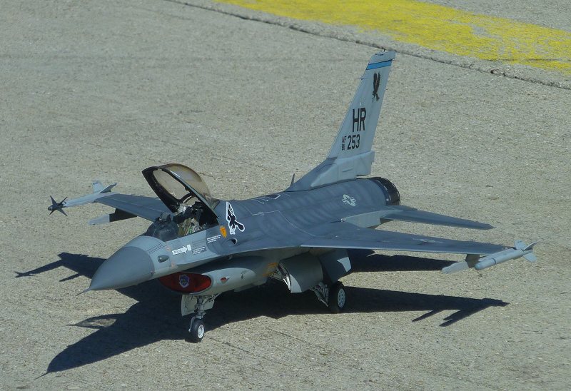

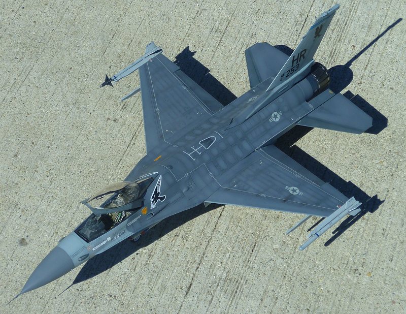

This is the Academy F-16C Blk. 50/52 kit, converted to a Blk. 25 F-16 with parts from the old Hasegawa F-16. I build this kit for a good friend of mine and he wanted the serial number to reflect his birthday, so it's some sort of a "what if".

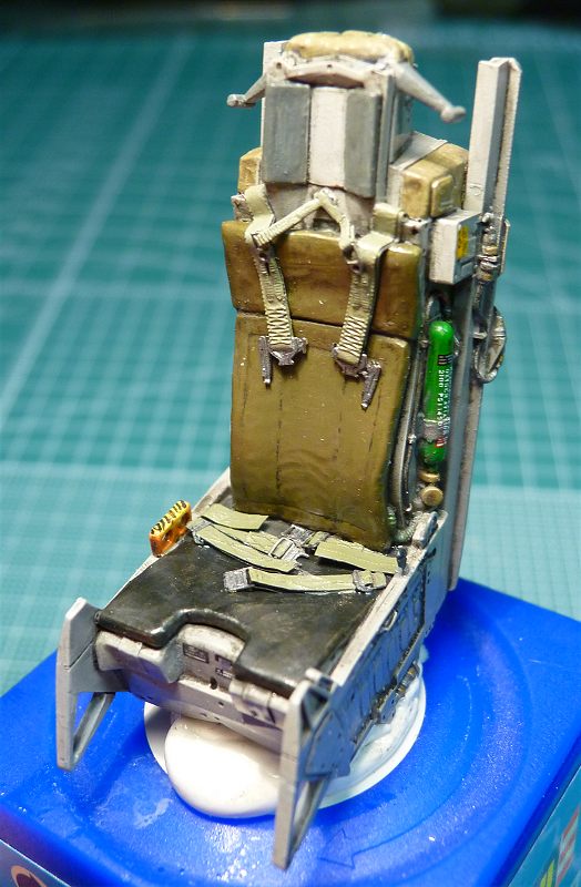

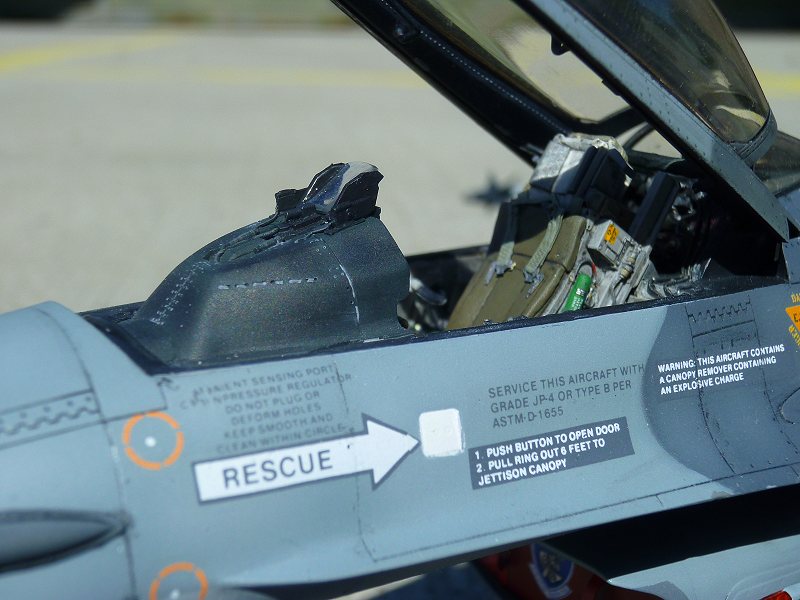

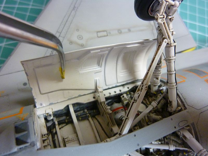

I also used the cockpit and wheel bays from AIRES and also the engine cover from Steel Beach. The intake cover is scratchbuilt.

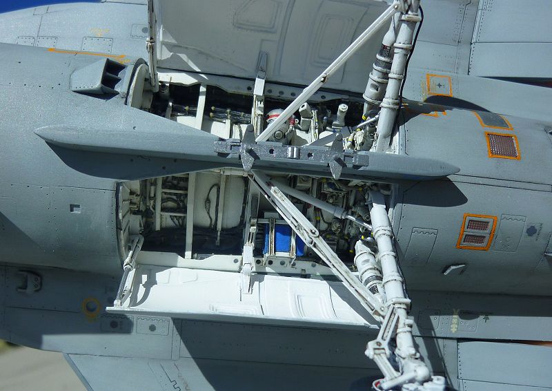

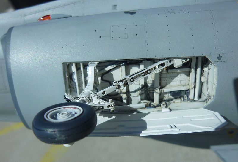

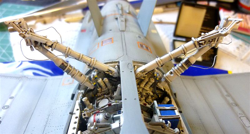

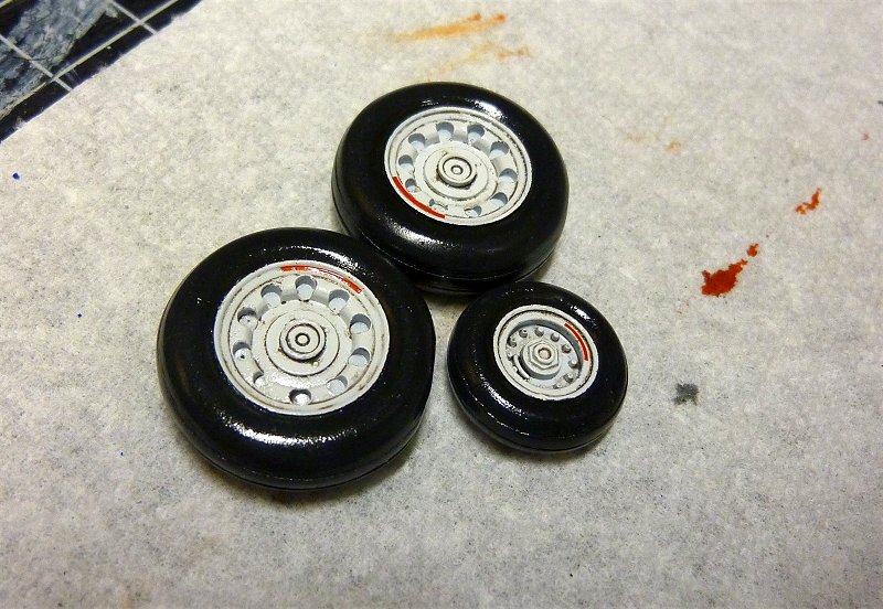

For the conversion I used the undercarriage and wheels from the Hasegawa F-16. But I found out too late that the legs of the main undercarriage are spread too much when glued into the AIRES wheelbay. So the F-16 sits now too low and the nose therefore too high.
Painting was mainly done with ModelMaster Enamel paints and Tamiya Acrylic paints. For the decals I used a mix of Academy, Hasegawa, Revell, Superscale and also homemade decals using a laser printer.

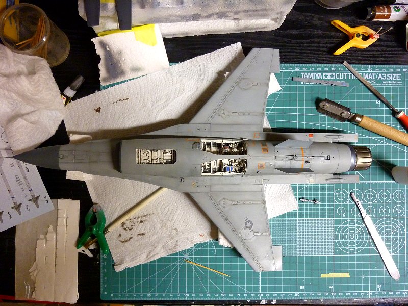

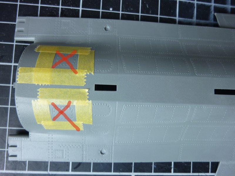

Conversion Notes

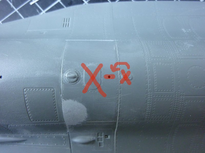

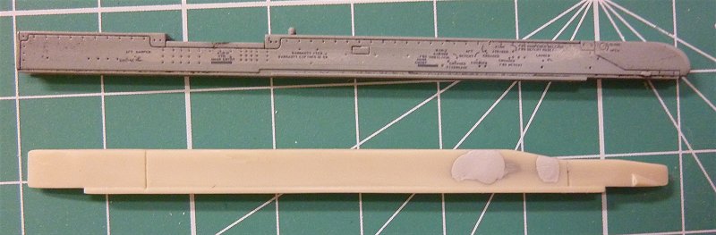

Here is some more info on what I did to convert the Academy Block 50/52 to a Block 25 (nearly all information is from the great F-16 guides from Jake Melampy).
Removed the small "intakes" on the tail:
Removed the third "finger" of the slats on top of the wings:
Removed the extra chaff/flare dispenser:
Changed the panel lines / fuel vent (?) how it looked at the older F-16s:
Puttied over the extra access hole panel lines on top of the engine fuselage:

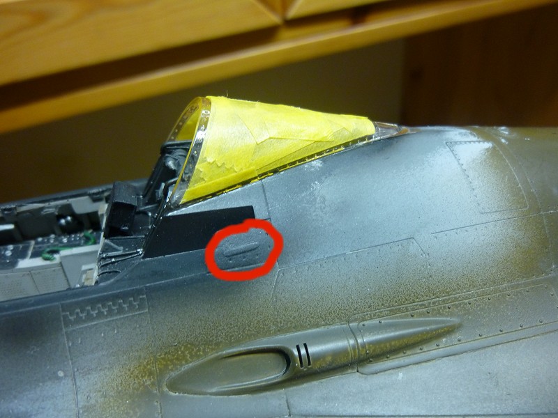

Removed the GPS dome and the little bulge has to go father to the front (I just realized that I have missed to install the TACAN antenna at the model!):
Don't know exactly what this is but it isn't present on the Block 25 F-16s:

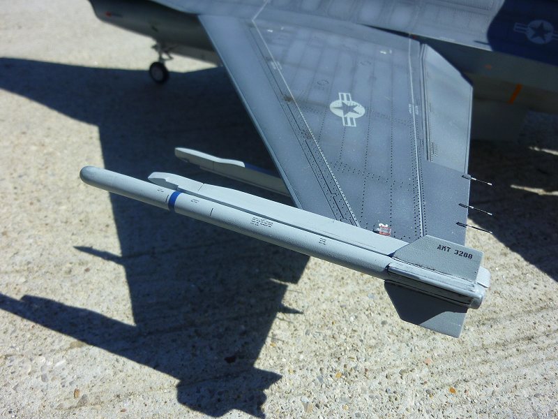

Other improvements were static dischargers from an old toothbrush:
Installing the older launchers from the Hasegawa kit:
And as mentioned earlier using the Hasegawa undercarriage and undercarriage doors as the Block 25 used the lightweight landing gear plus doors:
