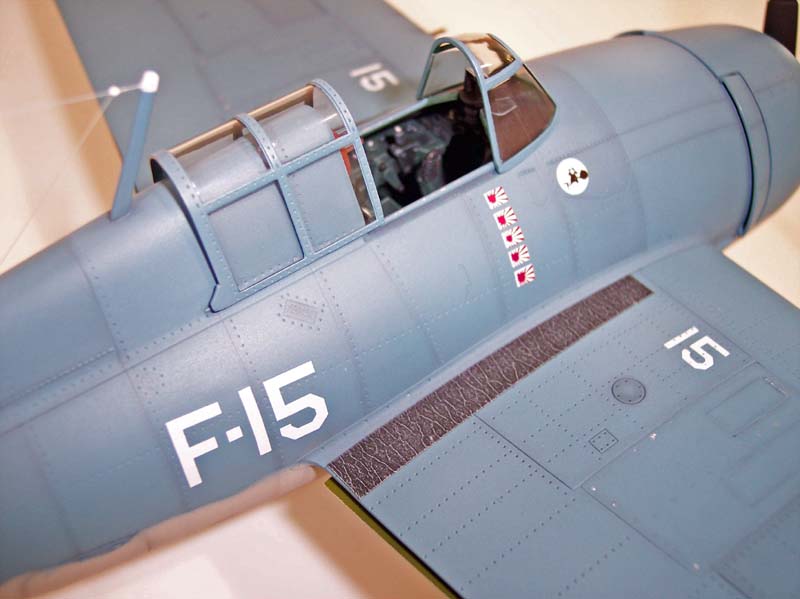

Only the instrument panels and seat belt buckle parts were added from Eduard's F4F photo-etched detail set to improve the overall look. The kit seat was thinned down with sandpaper on all sides to give it a more correct scale appearance. Masking tape strips were used for the seat belts. This version of the "Wildcat" did not use shoulder straps. Per Martin Waligorski's tremendously helpful IPMS article on interior colors of U.S. WWII aircraft, the cockpit on Grumman built F4Fs was bronze green instead of the often cited interior green. Model Master euro green was used as a close substitute. Cockpit weathering was accomplished by adding dark gray pastel powder in the recesses for depth, and then dry-brushing the raised areas with Model Master dark ghost gray to bring out the details.

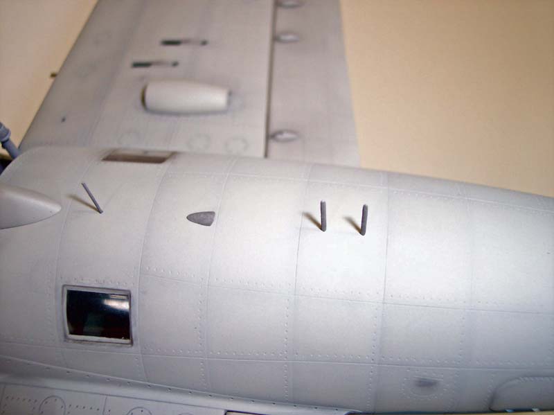

Small holes for various antennas and recognition lights were drilled into the fuselage for small parts that were added in the final assembly.

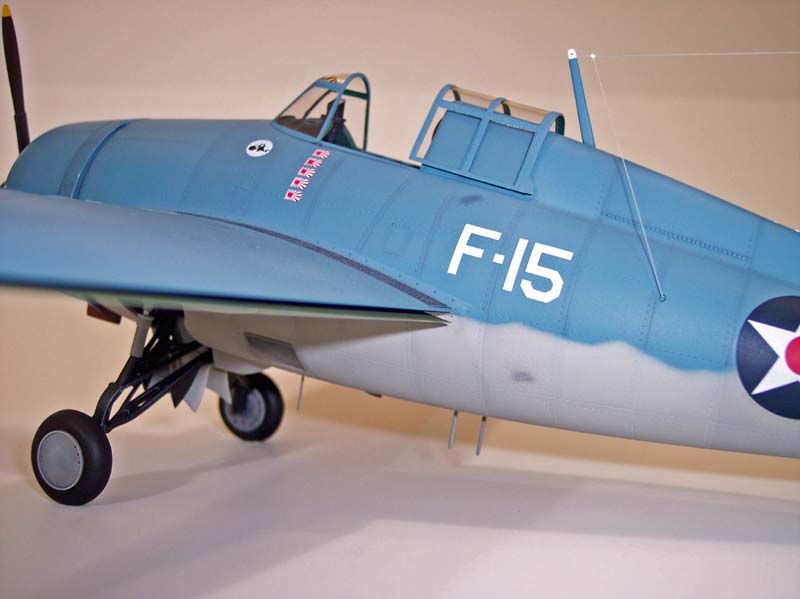

The Painting Adventure

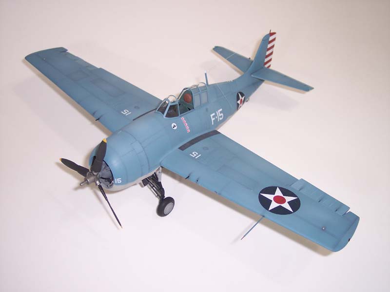

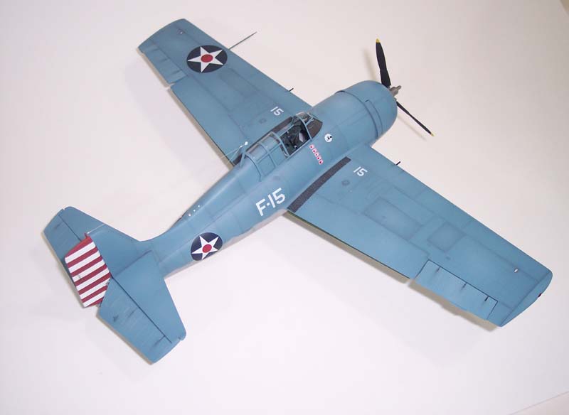

Butch O'Hare's F4F-3 carried the U.S. Navy color scheme of Non-Specular Blue Gray on the upper surfaces and Non-Specular Gray on the lower surfaces. Model Master paints 2055 and 1730 were used for these. A very loose, undefined demarcation line separated these two colors.

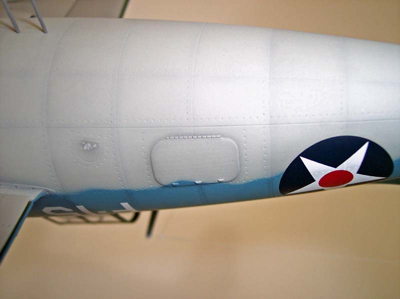

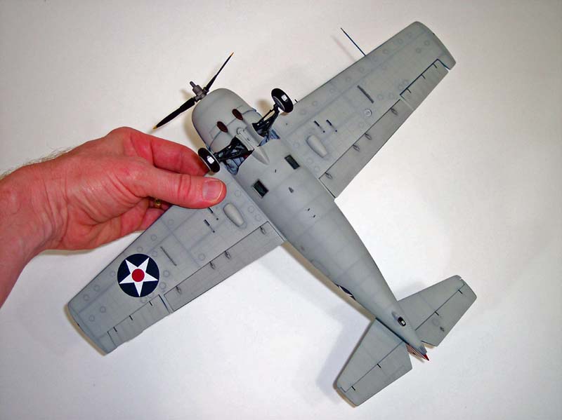

The lower surfaces were painted first. The "dirty finish" effect was accomplished in several steps. First, dark gray pastel powder was brushed along every recessed line. Clean Q-tips were used to remove the excess and soften the look. Finally, a weak wash overspray of the base color was applied over the panel lines until the desired effect was achieved. The key word is "subtlety".
To reproduce the undefined demarcation line, I cut a strip of masking tape with a very erratic "wave" pattern. I then made sure the top portion of the tape was at least 3/16" away from the fuselage. This distance created a very nice "diffused" look when the paint was applied. After the demarcation line was painted, the masking tape pieces were pressed firmly against the fuselage so there would be no accidental overspray while the rest of the upper surfaces were painted.
The same steps listed above were used for painting the upper surfaces. The only extra step was adding a random weak white wash overspray to produce a faded, sun-bleached look. Minor aluminum chipping was applied on the wing and stabilizer leading edges, handholds, cowling and various rivet heads. Finally, dark gray pastel powder was added to represent gun blast and engine exhaust stains.

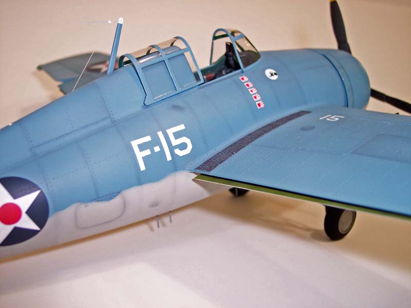

I had carefully buffed the entire assembly with a soft cloth after applying each coat of paint. This produced a fairly smooth finish that allowed me to apply the decals without first adding any Future gloss coat. All of the numbers and letters came from a couple of Aeromaster sheets, and the national insignias from a Yellow Wings sheet. The only unique marking on O'Hare's plane was the "Felix the Cat" squadron emblem, adopted by VF-3 in 1928. This emblem, as well as the kill markings, came from an old Super Scale sheet.
The national insignia decals on the wings would not conform to the many rivet holes and deep recess lines on the kit, even with strong decal solvent. I ended up cutting the decals along each recessed panel line, and using a needle to poke holes into every rivet. After this "surgery" was done a final application of decal solvent made everything lay down. Red, blue and white paint was used to touch up all of the areas the where the cutting had been done. This method was time consuming but produced outstanding results.

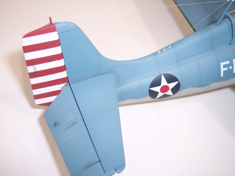

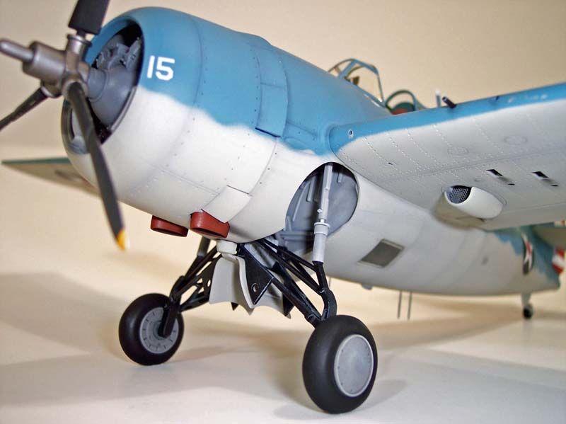

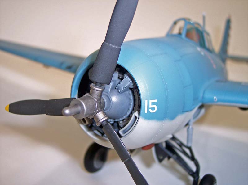

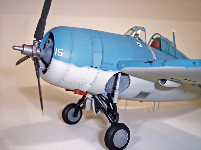

The only detail added to the engine was Eduard's photo-etched ignition wires. Small flexible wire was used for hinges on the rudder, elevators and ailerons. O'Hare's plane had smooth tires and the kit's rubber tires had a diamond tread, so they could not be used. A resin replacement set from J. Rutman Productions was purchased. These also had a diamond tread pattern but it was filled with superglue and sanded away. They were also modified by using the kit's front and back hub covers.
Scratch-built lower fuselage antenna details and Eduard's photo-etched bomb cradles were added next. The wing walkways were made from masking tape that was cut to size and painted before being added. The kit's wing tip lights were replaced with 5-minute epoxy mixed with food coloring (red and green). The kit's front left wing landing light was replaced with Krystal Kleer. The final modification was rebuilding the upper half of the reflector gun sight.
