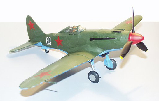

Sukhoi Su1- Enlarged to 1/32nd scale from a 1/72nd scale download and laminated onto a file folder. fuselage, wings, and tail built like a regular paper model, landing gear, prop, spinner, pilot, and exhaust are plastic. The cockpit is vacuum formed. All my paper/card models are decaled and painted.

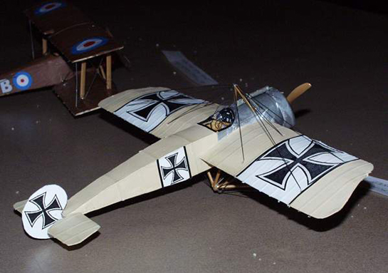

Fokker Elll Eindecker - Enlarged from a Fiddlers Green model. You can see what is plastic, the cowl is made from an Excedrin bottle, the rigging is #26 ga. florist wire

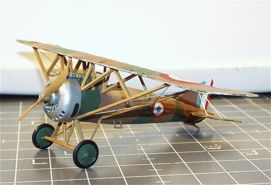

Morane-Saulnier A-1 is completely scratch built. I used a free software CONE-3 to lay out the fuselage. That cowling is another Excedrin bottle.

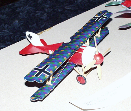

Here's a picture taken at a NJIPMS meeting. The model is based on A Fiddlers Green Siemens-Schuckert D-lll. The fuselage is formed from a cylinder and a cone with my favorite Excedrin bottle as a cowl and a cutoff plastic Easter egg as a spinner. The wing camouflage is a Battle Axe decal.
