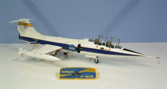

This is my Hasegawa 1/32 F-104 G/J converted to a TF-104G using the following aftermarket goodies:
- C & H Aero Miniatures: Two seat F-104 conversion
- Cutting Edge Nasa Logos: ced48236
- Eduard Photo etch exterior: 32060
- Home printer made decals.

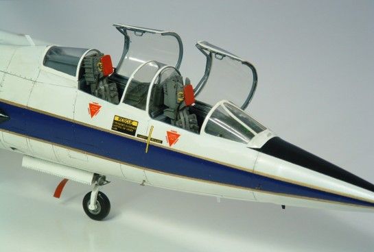

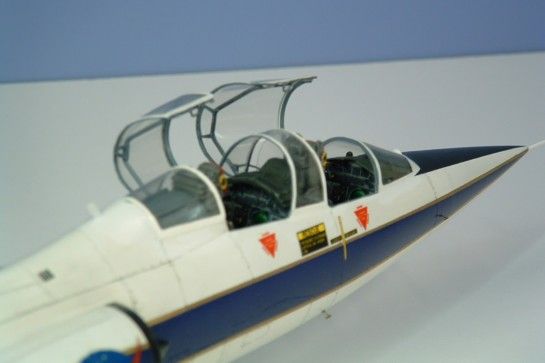

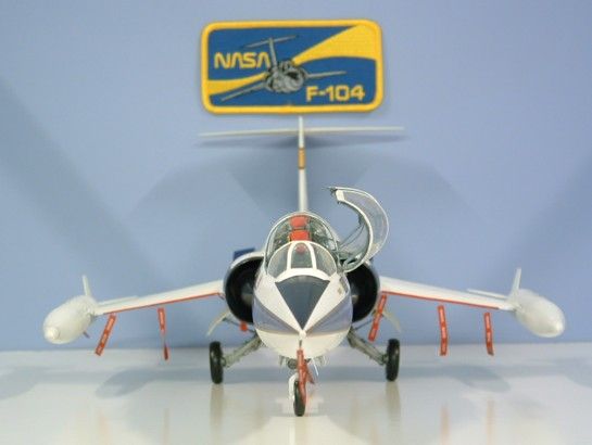

The C&H f-104 conversion is not for the weak-hearted. There are issues with the cross section symmetry and very deep panel lines. I found if I removed most of the interior reinforcing of the resin cast until the walls were thin enough to twist to the correct shape to match the kit rear half. Then fill in all the panel lines and rescribe. The seats and combing are very good. I also need to scratch build the canopy frames to open up the office.
