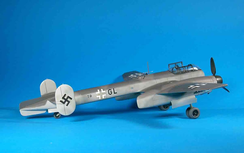

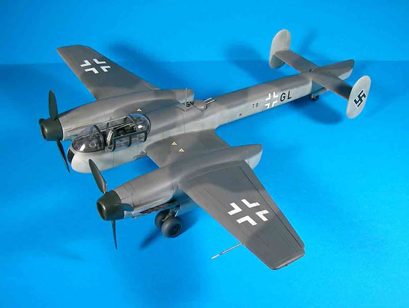

The Model

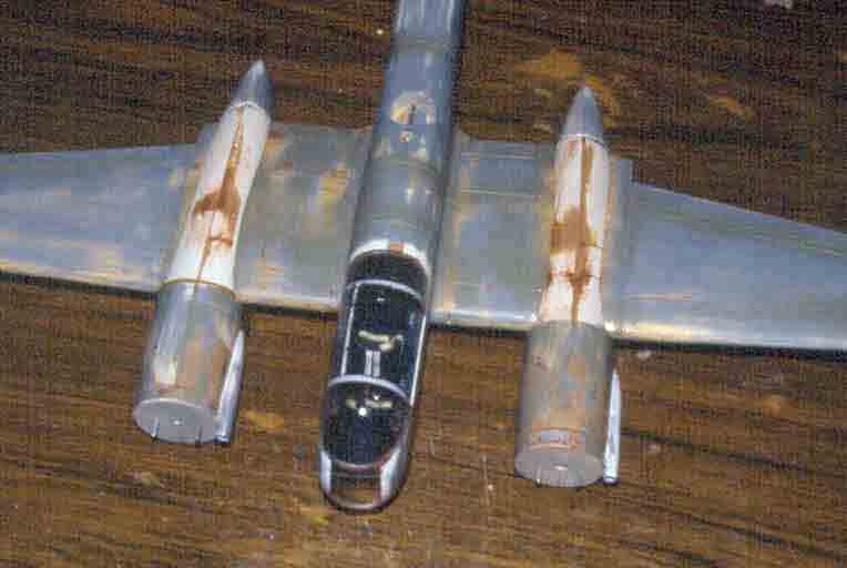

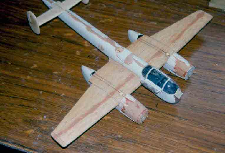

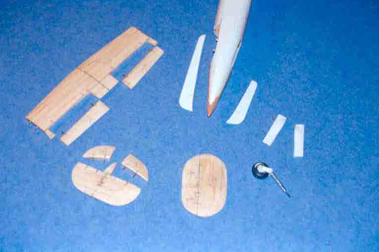

Although this model was built in the mid-1990s, I used pretty much the same techniques I use today, with the exception that the wings and tail surfaces were not vacuum-formed; they are simply hard balsa that was carved, then coated with super glue and epoxy. However, somewhat to my surprise, all this many years later there are still no cracks.
The pictures, which really tell most of the story, were taken with real film which accounts for their somewhat grainy appearance.

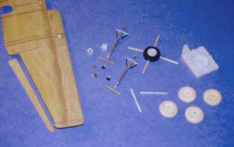

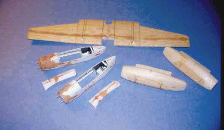

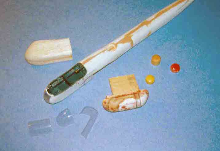

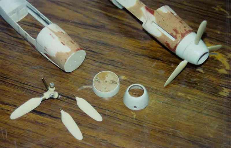

The fuselage, nacelles, radiator housings, and clear parts were carved from balsa and either heat-and-smashed or vacuum-formed. The propeller blades and wheels were turned from hardwood and cast from resin. Landing gear were scratchbuilt from brass and aluminum tubing.
The model was scribed in the usual way, but obviously, some extra care was involved since I was not working on styrene. The little metal saws were used almost exclusively.
