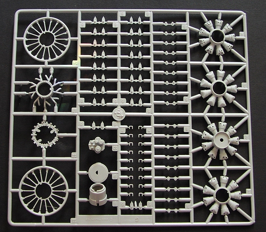

The R-2800 is really one of the high points of this kit. At 106 pieces, the engine lacks no detail. Some small shape and molding issues make the main gear housing look a little "odd," but with pushrods and wiring harness included here, very little effort will be needed to turn out a stunning radial engine here.

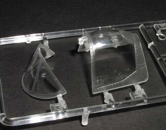

The clear pieces are accurate and well molded, and have Trumpeter's classic textured surface to help guide masking. While not unique to Trumpeter, this technique is quite welcomed by the reviewer, and should allow for an easy ride to getting a nice sharp line between paint and glass.

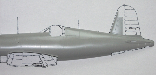

However it should be noted that three areas of this kit are inaccurate enough to cause an eyesore if stared at too long. These items are located aft of the cowling on the underside of the fuselage and center wing, and on the gear doors. They all exist on the bottom of the aircraft. While I imagine that's better than on the top, they are exposed here for your review.
The Exhaust Fairings Size and Shape

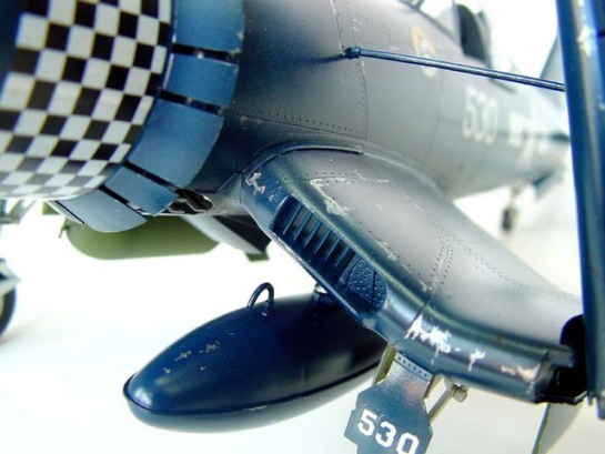

The R-2800 feeds a complex exhaust design on the F4U1-D that brings a total of 6 pipes out of 2 fairings below and behind the engine bay/cowling area. These are quite distinctive and have been mis-shapen in this kit. The fairings in the kit are too large and give the area in question a gape that is visually disturbing. As well the kit offered pipes end up looking quite lonely in the larger openings and lack the tight and tidy look of the real thing.
p
The exhaust openings looking a bit long and fat on the kit compared to a technical drawing.

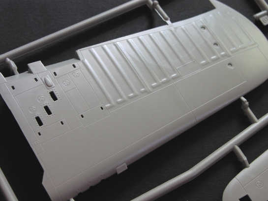

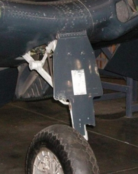

The Main Gear Door and Bay Shapes

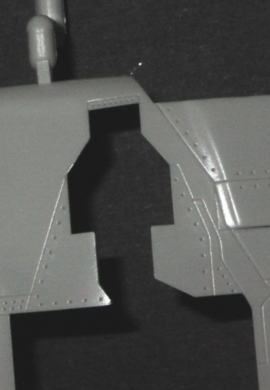

Another stumble is the shape of the main gear doors and bay openings. These again are quite distinctive on the Corsair as the doors face forward (indeed there are accounts of pilots using them as dive brakes in combat). The Trumpeter design team failed to capture the outline here, and have made a more stark and geometric shape, losing the more subtle lines of the "shoulders" on these doors.
For a complete fix, both the doors and the bay openings will need to be re-shaped.

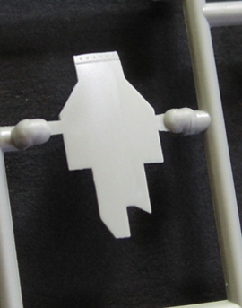

The Cowling Flaps

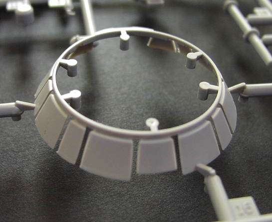

As one might guess if you splice a cylinder vertically along it's radius, and perpendicular to it's bottom and top edges, the result will yield rectangular shaped sections. Somehow this basic geometric truth was lost on the Trumpeter design crew. They molded the cowling flaps open (in a "cooling" attitude), and yet designed the piece so that all the cowling flap edges were equidistant when open. This results in cooling flaps that are trapezoidal rather than rectangular, and look like they are wider at their trailing edge than they are at their mounting edge. If Trumpeter's cooling flaps were to close in an altered reality, they would all collide together at their trailing edges and leave gaps at the mounts.
Quite frankly, an astounding error in this reviewer's eyes.

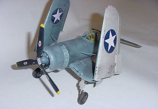

That said this will build into a very impressive model, even OOB Look at this image from the Trumpeter site for example:
Here one can see all three errors. Are they really that bad? You decide, after all it'll be on your bench, and then it'll take up some serious room in your display at a 390mm wing span.
