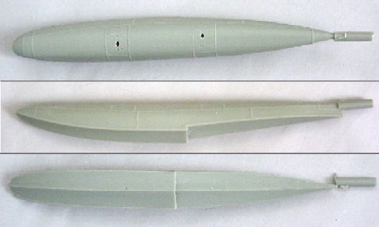

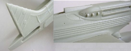

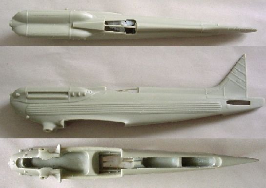

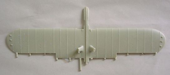

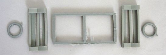

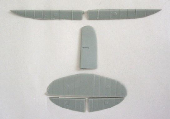

Resin (appearing to be a polyester resin) composes the greatest bulk of the kit broken down into a one-piece wing, a one-piece fuselage/vertical tail with a narrow ventral opening (which corresponds with the oil cooler fins), separate horizontal tail, separate control surfaces and two floats. In addition resin is used to represent two ‘wooden’ float supports to be mounted to a resin ‘angle-iron’ platform and two resin tires. There is no evidence of bubbles. Assembly tolerances vary considerably and will require careful sessions of filling, sanding, and adjustment. Molded in detail is generally a bit on the heavy side in contrast to the wonderful detail of the photo-etched pieces.

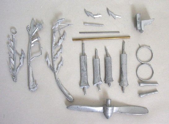

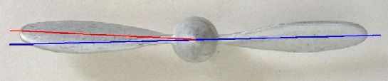

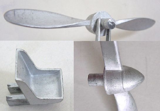

Pieces in cast metal are the four ‘airfoil-shape’ struts, the propeller/hub/spinner with its mounting inserts, 3 aileron balance horns (only 2 required), 5 rudder balance horns (only 2 required), 6 various cockpit controls, cockpit seat, 2 wheel rings, 2 wheel spoke spacer/stub axles, and 3 fuselage scoops. The cast white metal is well done with very little flash but brittle: consequences are if you want to bend a piece for any reason, great care is required. Aerotech has noted in the instructions that this might be the case with the stubs of the metal struts and has provided brass rod of the same diameter to cut and splice in as required.

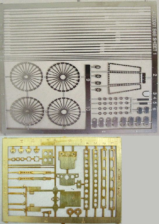

The kit really begins to shine when one gets to the photo-etched frets (also a highlight of the Marsh Models racecar kits). Their layered etching is finely detailed and brings the expected level of quality to the kit. Sheet #1, the stainless fret contains 22 bracing wires (11 pairs etched to length), 4 wire wheel plates (2 pair inner and 2 pair outer), 1 windscreen frame, 2 trim tabs, 36 various plates and grommets for the wire bracing attachments, 3 misc. plates.

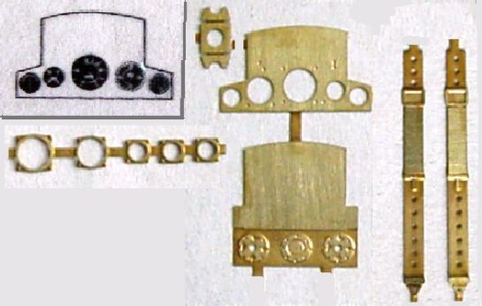

And sheet #2, the brass fret contains 4 plates to make up the exhaust ports, 2 piece cockpit floor, 2 piece instru-ment panel, 5 instrument bezels, 2 seat harnesses, 4 float nose tie-downs, 4 float tail tie-downs, 2 wheel hub bolt plates, 3 piece pitot, and 2 misc. pieces.

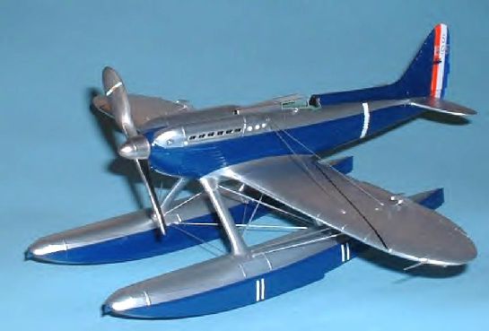

The instructions are on 3 A4 sheets of heavy stock with nice quality color printing. The instructions are not of the customary step by step variety, so modelers who habitually do not follow instructions will be at a loss to violate any procedure! This really demands a thorough multiple reading of all the material and then some research for some of the scant information in printed media. The backbones of the ‘manual’ are the two exploded assembly views of the kit, one featuring the entire plane and one the trolley. Aerotech helpfully utilizes several color photographs of a completed model to help illustrate some to the finer points of assembly. One sheet is the ‘Certificate of Authenticity’ which includes some history of the S.6B, some useful references and finally the kit number of the batch of 100.
