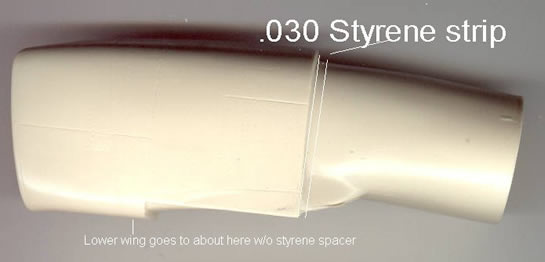

The intakes are well-molded, with pour blocks at the aft ends of the intake ducts. There were a few minor air bubbles inside the bleed air vents on the top and bottom of the intakes. The much-despised raised panels found on the kit have been removed from the new intakes, saving the modeler a little time. With some cutting and minor sanding, the ducts literally dropped right in. As the model progressed, I found that the aft edges of the outer part of the intake had been shortened by .030 inches, shifting the entire intake aft. There is no mention in the instructions as to why this was done, but it causes the resin intakes to interfere with the forward part of the lower wing. Rather than modify the lower wing, I chose to pull the intakes off and insert some .030 styrene strip behind them to move everything forward. It turned out to be a very easy correction. I would recommend taping the lower wing in place to help position the intakes.
