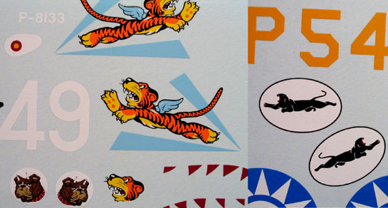

I don´t know what is the printing process being used to produce these sheets. Silkscreen or whatever, I counted 12+ different colors used in my sample! They are very well printed and in almost perfect register. The markings are thin and, as known from Cutting Edge decals, they will conform very well surface details and sustain setting solutions where needed.
The AVG bird is a Curtiss H-81A-2 code P-8133, reportedly flown by Tommy Haywood during early 1942. As many other AVG P-40s, this one shows many repainted areas. The Flying Tiger cartoon was removed from an earlier spot just below the windscreen and repainted under the window glazed area. interestingly, the lacquered areas under the cartoons have a glossy finish, and CE wisely included a clear decal to depict this. Also, the head of the early tiger on the left side was not removed for some reason, and it is also included in the sheet. CE also provided the DuPont ´RAF equivalent´ color codes used at the time by Curtiss.

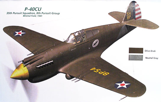

As for the other option, it is a P-40-CU from the 8th PG / 35th PS. These early Tomahawks are very interesting subjects, in spite of the simpler OD/NG camouflage scheme. At the time, the squadron codes on the rudder fin and wings were not yet under the new regulations, so the yellow color is correct (they were changed to black later in 1941, along with the elimination of the red/white stripes painted on the rudder). The instructions show four .30 machine guns on the wings, but this is not strictly correct for the P-40-CU, unless retrofitted in field (I found no photographic evidence of that, though), so check your references. The squadron codes were commonly repeated on the wings leading edges, but many photos of the period don´t show them. CE provides these codes, but as an optional item, without further information (another homework for you). Another point (a bit out of topic) is that the 35th PS was based in Selfridge Field in 1941, not in Mitchel Field, as stated in the instructions.
The P-40 from the 35th PS depicted in this sheet.
