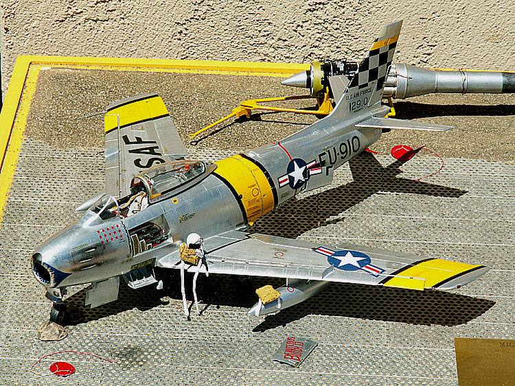

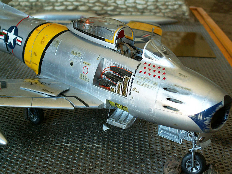

Sometime during the early part of 1985 I purchased this model kit, as it was one of my favorite jets. I kept a building log for future reference of how I made certain items, including my labor that came to a bit over 500 hrs.

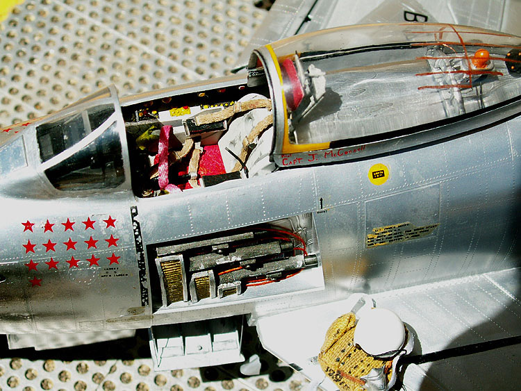

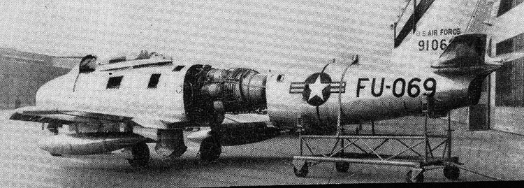

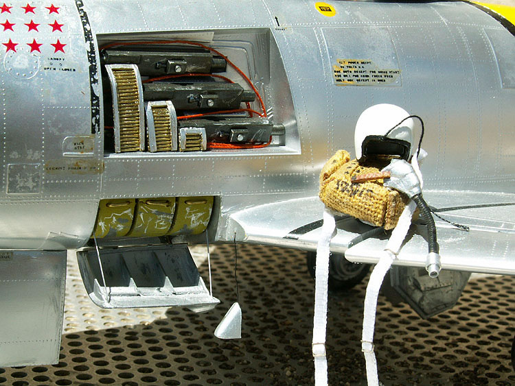

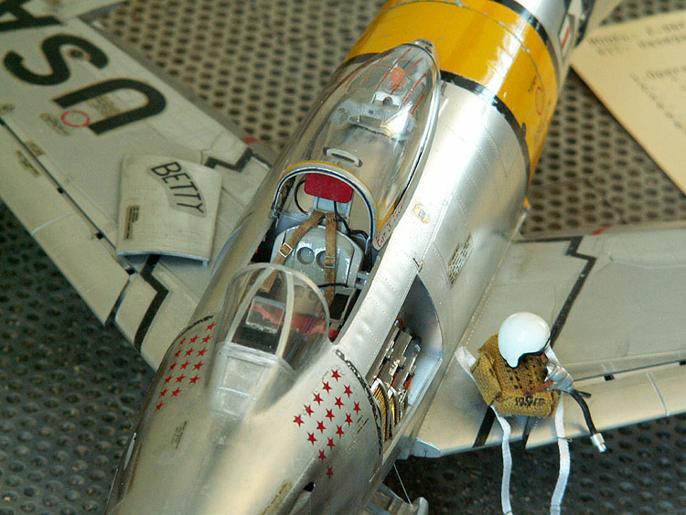

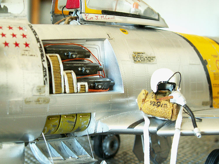

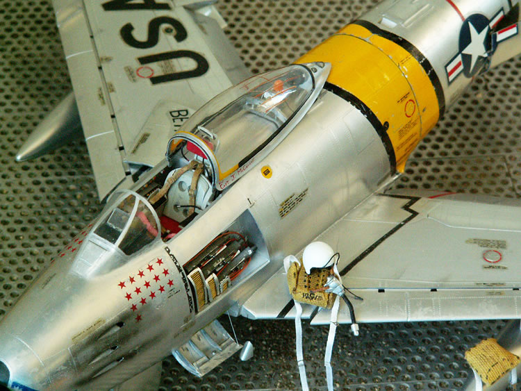

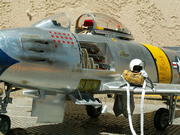

The photos will show you that I added seat belts and painted in the copper antenna wires on the inside of the canopy. Furthermore, the photos will show lots of other additions built in per the 2 photos of the real jet.

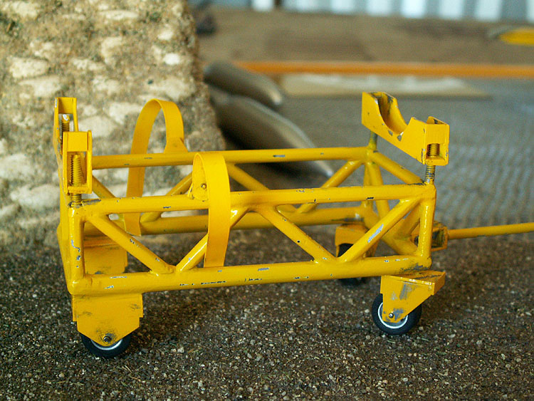

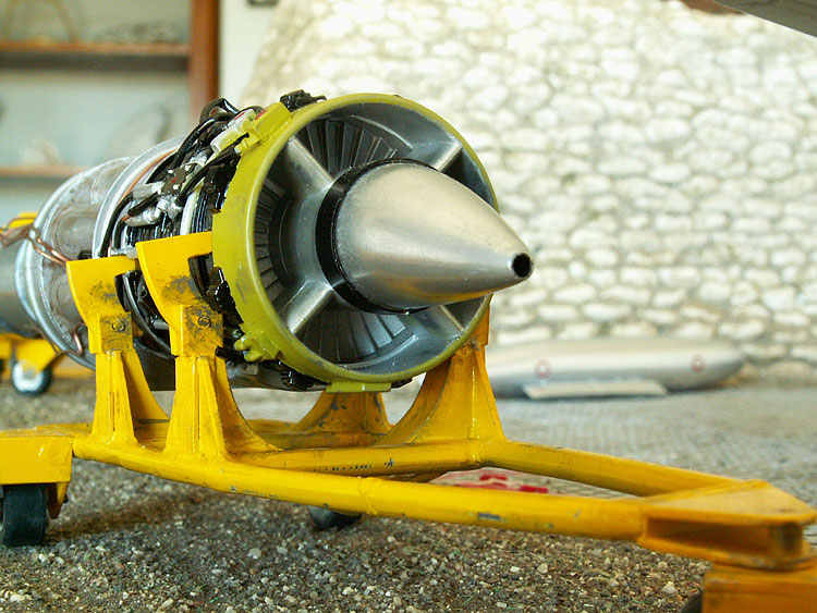

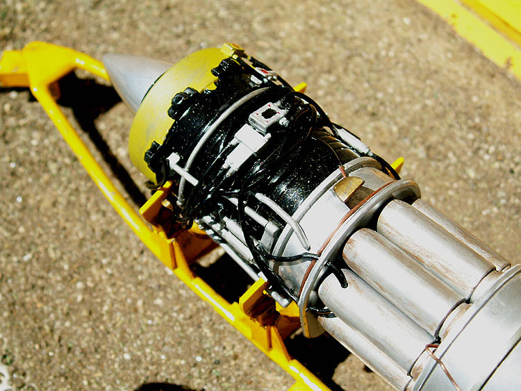

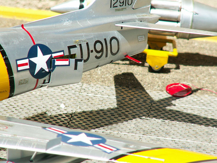

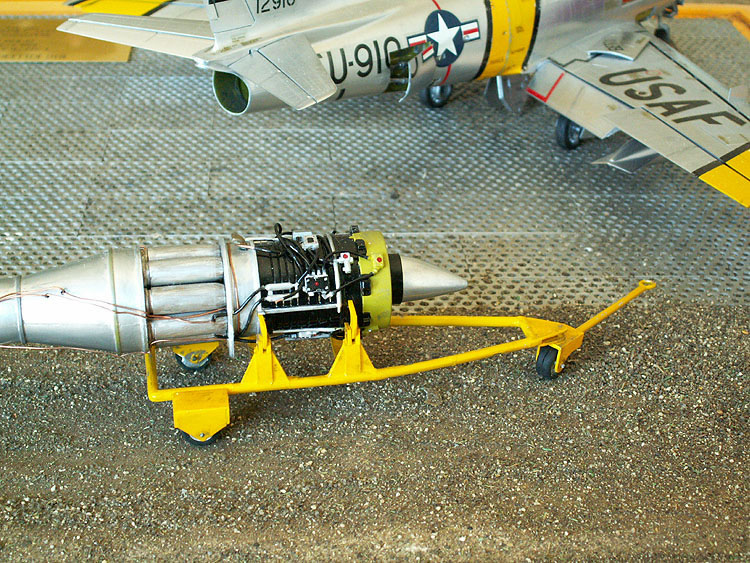

In the early 1980s I did not have a great deal of experience “scratch-building” items for a model, yet I accomplished several of them (eg: Additions to the guns; built in the “ammo” trays; parachute & helmet; several items built onto the engine, including a scratch-built engine & aft fuselage section dolly).

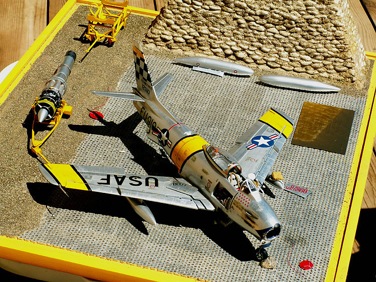

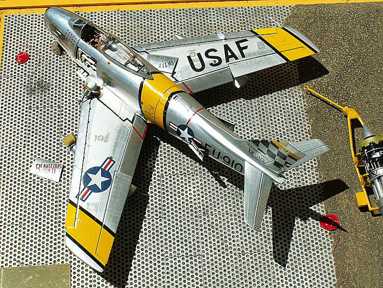

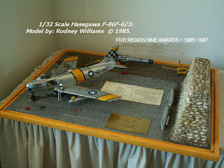

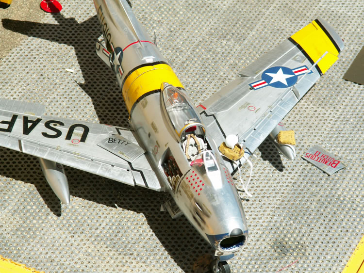

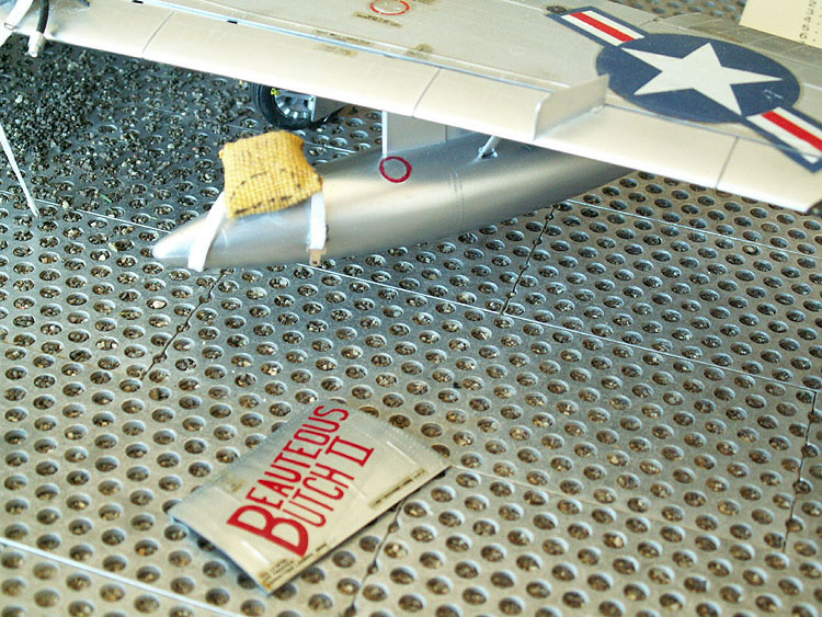

I obtained some perforated aluminum from the backside of an old TV set then cut it to size for my base.

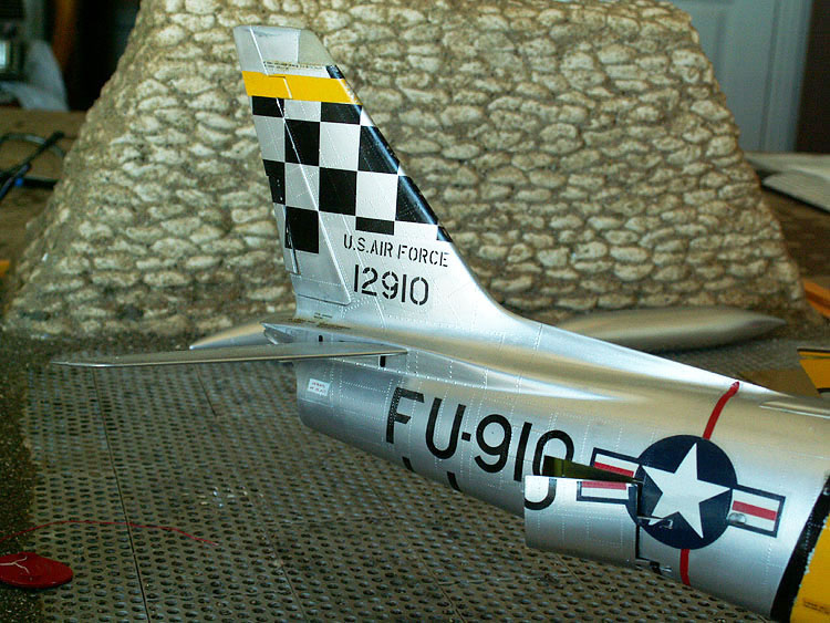

I built up a cardboard mount and then hand crafted each “sand-bag” using some sort of powdered home-style patch material. I mixed the stuff with water and made a semi-soft paste and then molded each bag with my hands. They were placed one at a time on my angled cardboard revetment while they were still wet. I sprinkled on some fine grain sand to make it look “kinda” realistic, including the side area around the perforated tarmac.

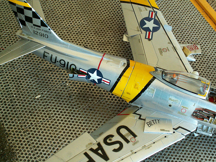

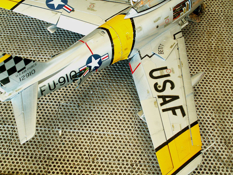

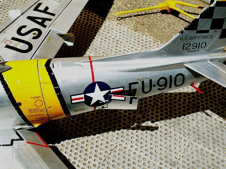

My “bare-metal” paint was called “Metalizer” and the other colors of paint may have been by Testors and/or the new acrylic paint that Tamiya came out with.

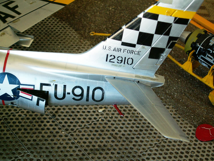

I used the decals that were supplied with the kit.
I hand-crafted my base, using some ½” thick plywood and I had Tap Plastics of San Jose, CA make my ¼” acrylic cover.
The first few photos of Joe and his F-86 came from the web while the other two came from my old Squadron Signal F-86 book.
