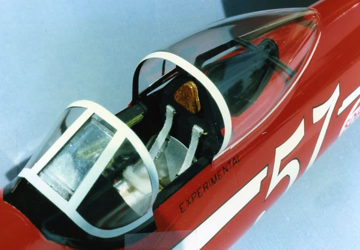

Any ways I did not mention in my last story how I carved out my wooden mold for my windscreen-canopy. All I can remember is that I made the mold oversize then pulled a “vac” of it and trimmed it to size then fit it to the model. It was too big so I had to shave off some of the wood on the mold. After 3 or 4 tries, I got a windscreen and canopy that fit perfect.
From then on when other modelers ask how I scratch-built a part the answer was always: “It was cut and fit until it fits”.

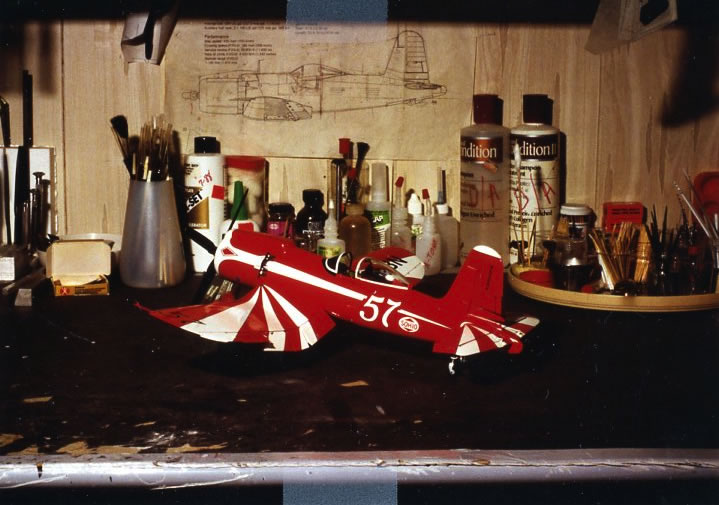

My first photo shows that I have painted the model with green and black paint. Another modeler told me to paint it this way and/or I dreamed it up on my own.
The next photo shows that I have added some 1/64” wide “Graphic Art” tape to represent the divisional color line between the red and white paint. Once the tape was placed on the model it was painted with Model Masters white enamel paint.
Certain white areas of the model was mask off and then the red color was applied. Once dried, the tape was removed and that is when “disaster” struck. The tape left a very irregular edge and pulled the black, green, white and red paint off the model. The total finish turned to crap.

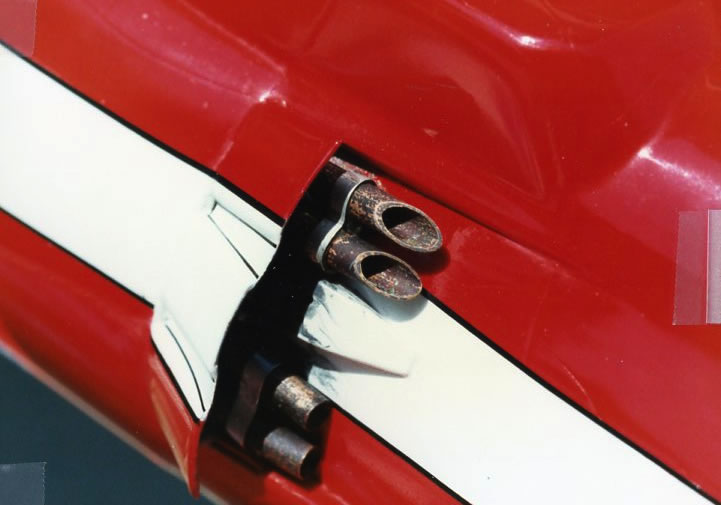

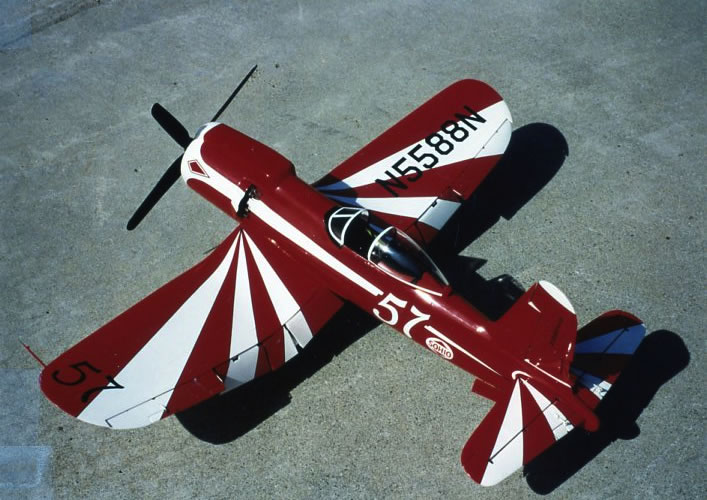

“How am I going to apply the thin 1/64” wide black division lines between the red and white paint colors that were butted together? I put my brain in gear and pondered several ideas of “HOW-TO”.
Solution: I purchased two new 5”x 7.5” sheets of “Super Scale Black NO. 2 Decal Trim Film”@ “D& J Hobbies”.
Al told me to use a new #11 knife blade and a good non–scratchy type of ruler and lightly cut through the “thin” decal film but “do not” cut through the paper backing.
These thin strips of decal film were applied under normal decalling operations but took some time getting them in proper alignment.

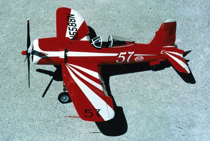

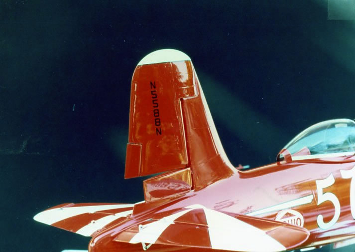

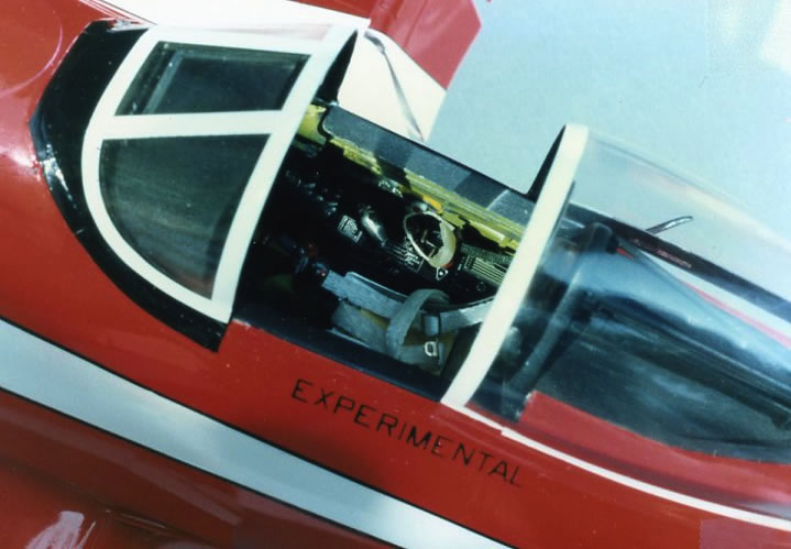

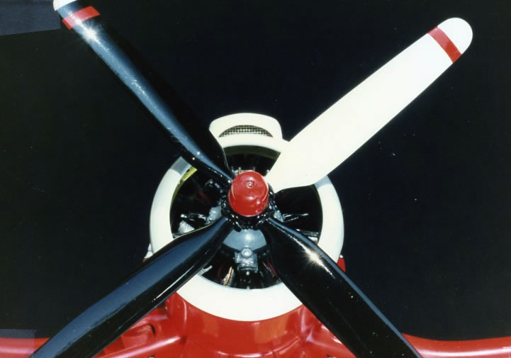

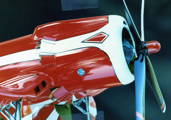

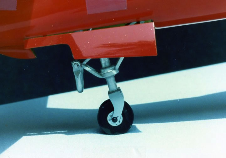

The black lines can’t been seen in some of the full length photo, but they show up real nice in my close-up images.

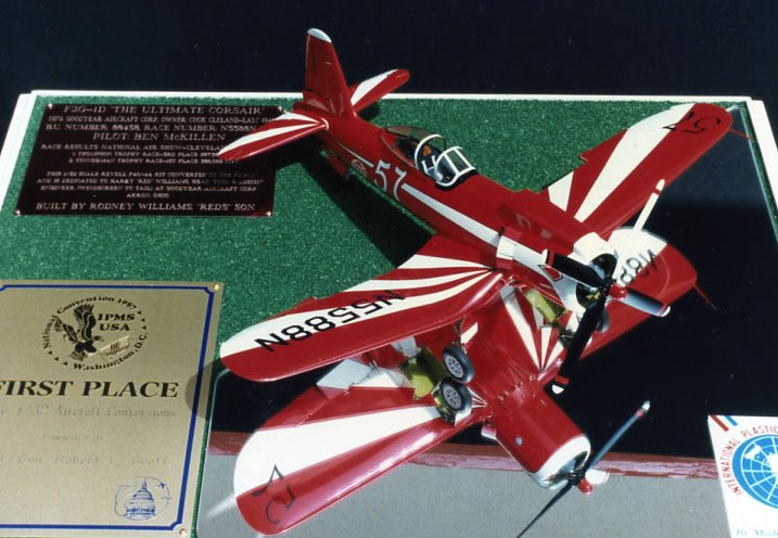

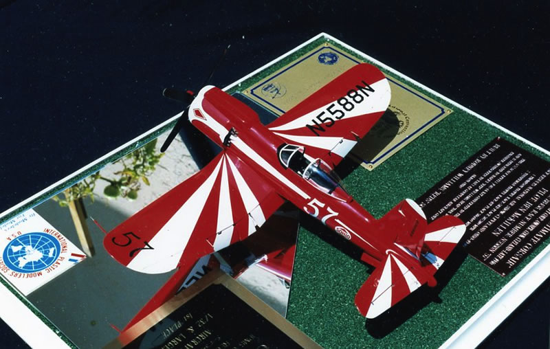

I built a nice wooden base for the model and added some modeling grass, an angle cut mirror, a data engraved tag, including a plastic cover.

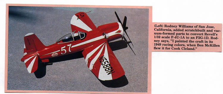

I decided to take the model on the airliner from San Jose, CA to the 1987 IPMS/USA Washington D.C. National Convention. It made it there and back safe and sound.
To my surprise the model took a first place award at the convention. Later that summer I was invited to enter the model at the IPMS/USA Orange County annual model contest.
I received my second first place award.
The model was displayed at out annual model show at Moffett Field, Sunnyvale, California when the “Blue Angels” came to town.
There was a small write-up in FineScale Modeler magazine.
In 1988 I transported the model to the National IPMS show in Dayton, Ohio, whereby the new owner took it to his home in a far off land.
