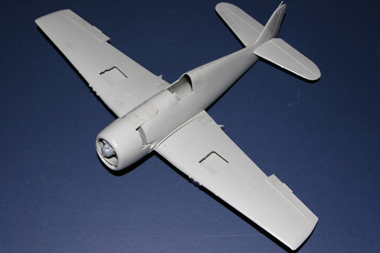

The main parts were dry-fitted for general fit and surface inaccuracies.

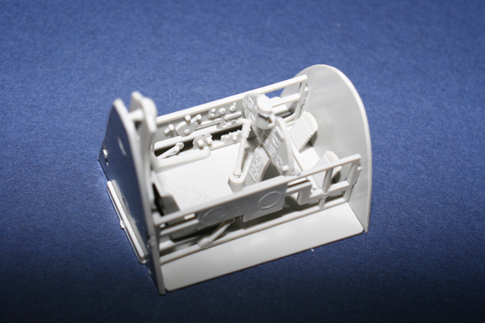

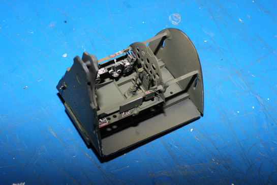

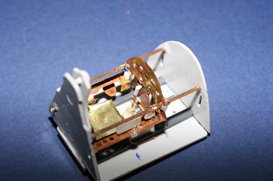

The cockpit was then constructed. Clearly the original cockpit was not acceptable by today’s standards. I made a new cockpit with a brass seat cut from K&S metal sheet. Eduard photoetched parts and brass, styrene and copper bits finished the main structure.
Image 03 Image 04

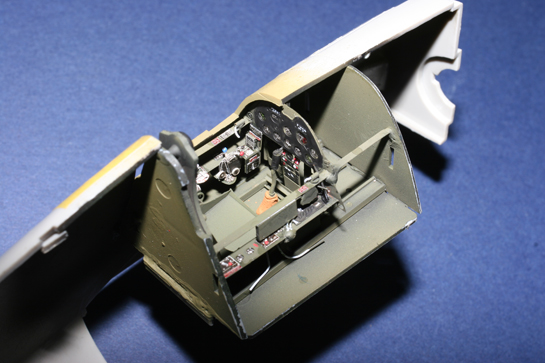

The Waldron placard set added some seriously beautiful detail.
Image 05

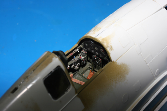

This was place in a fuselage half and detailed further. The final product was weathered with oils and silver pencil wear.
Image 06 Image 07
The finished product comes seriously close to the real thing.

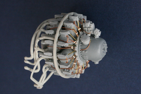

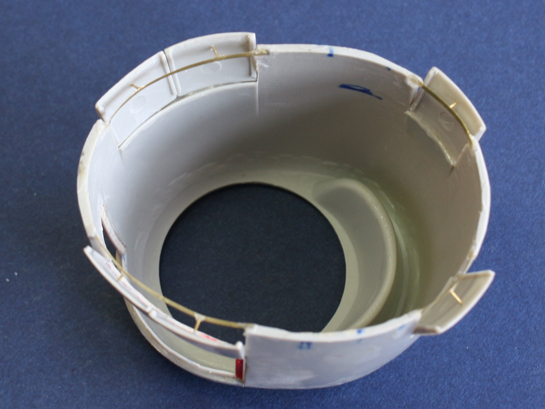

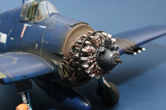

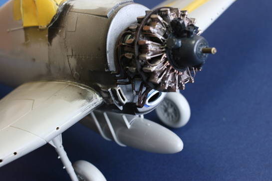

The engine was constructed and detailed with brass wire and rod. This was painted with Alclad paints in shades of silver and copper. Final detailing was done afterwards.
Image 10 Image 11 Image 12

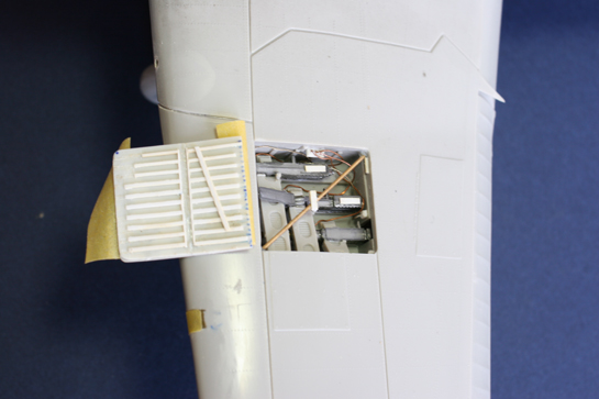

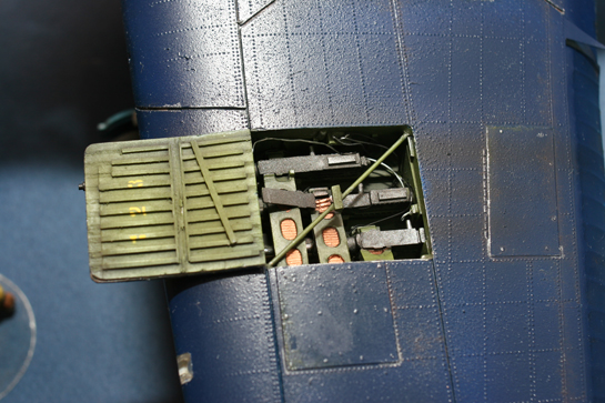

The gun bays were rebuilt with stock 1/35 Browning machine guns from the spares box. Wiring and styrene completed the effort. The metallic work was again sprayed (and heavily masked) Alclad. The access panel numerals were sprayed through a stencil.
Image 13 Image 14

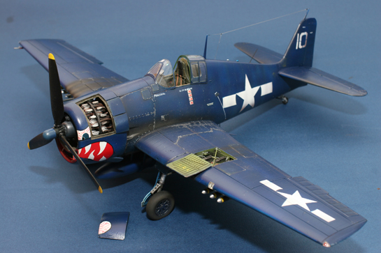

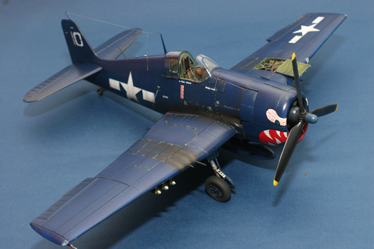

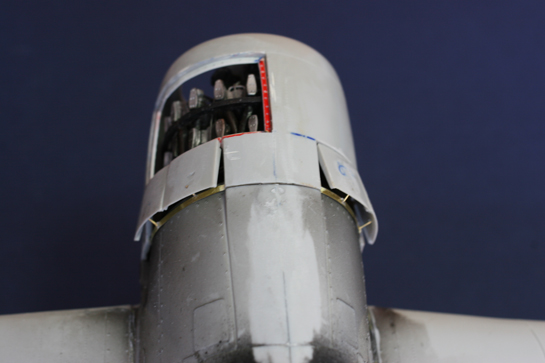

The rest of the model went together effortlessly with special attention to landing lights, wing cameras and other navigation lights. The cowling was detailed with open panels and brass actuators for the flaps.
Image 15 Image 16
Painting

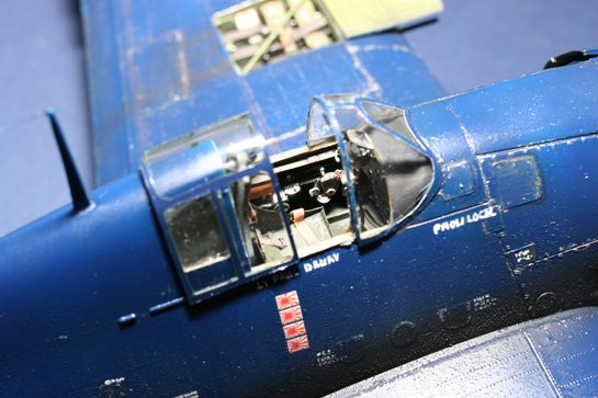

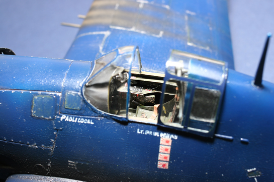

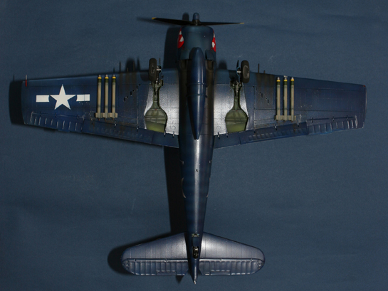

Dark monotones can be difficult to carry out realistically mainly because the color variation if minimal. Unlike many land-based Pacific war aircraft that showed severe weathering and fading under normal use, carrier based midnight blue Hellcats were glossy, well maintained and minimally weathered. This was a challenge and probably the most fun part of this project for me. In addition, all markings (including the stencils and yes, especially the tiger cat face) were handpainted. Only the kills marks were decals from the kit (the rest of the kit decals broke up under water anyway).

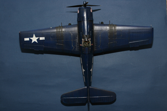

I began with a standard grey primer. I then pre-shaded with dark brown. I sprayed with white all emblems and the tiger cat face. This was followed with repeated masks of frisket film to finally shape out all the emblems. The model was re-shaded and sprayed with gloss royal blue. Future coats were applied and weathering commenced. Exhaust and gun soot was airbrushed. A filter was applied to all access hatches using oil paints and a silver pencil used for bare metal. The final model was coated in Satin varnish.
Image 17 Image 18 Image 19 Image 20 Image 21 Image 22

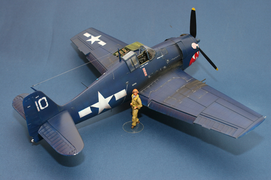

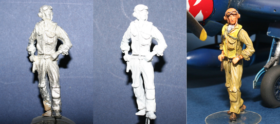

The Valiant figure struck a decent pose but had a poorly sculpted face. I did the best I could at making this Marine look good.
Image 23

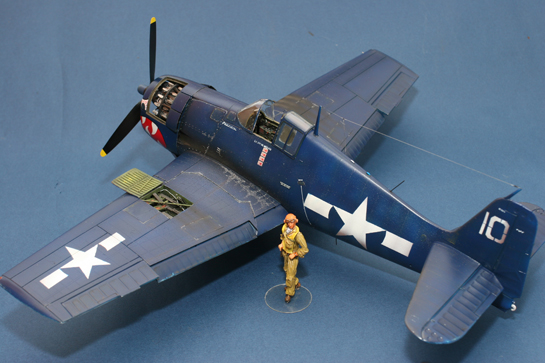

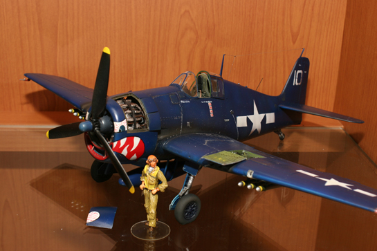

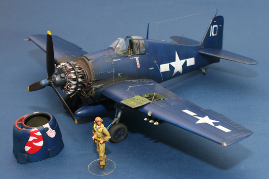

I’m very pleased with the final result. The model looks great in the Pacific war section of my display cabinet.
Image 24
